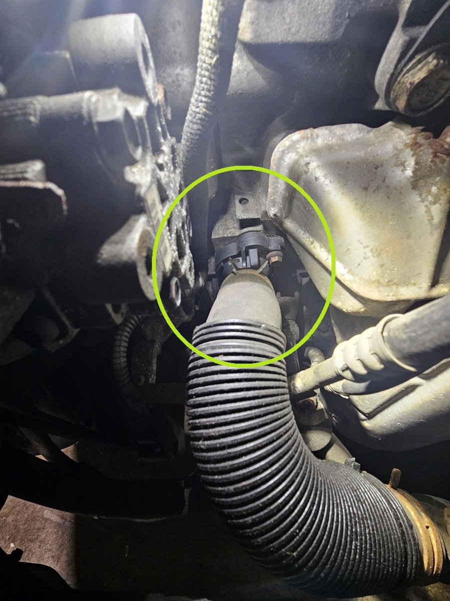

khnitz Posted December 9, 2025 Report Share Posted December 9, 2025 Tonight I replaced the thermostat. We'll see if that helps with interior heating in this cold weather. This video was helpful, and he replied to a question I had on his solution. He also suggested to make sure that the radiator fan resistor wasn't bad (where the fan would be running all the time). On our Journey, that is not the case...the radiator fan does not run all the time. Quote Link to comment Share on other sites More sharing options...

5rebel9 Posted December 9, 2025 Report Share Posted December 9, 2025 (edited) 11 hours ago, khnitz said: Now I have heat on the driver's side, but not on the passenger side. I'm doing some research and the first likely culprits are either a clogged heater core (but why does the driver's side get heat) or a bad blend door actuator for the passenger side. I'm leaning towards it being the blend door. Airflow out of both sides is good. And, unfortunately, the car went into limp mode once at the start of my test drive after replacing the thermostat. After a power cycle, it did not go into limp mode again on the rest of the ~5mile test drive (at speeds of 0 to 55mph). IF it is not a broken actuator on the pass. side, or air entrapment( the 3.5 was troublesome for bleeding air out), then YES the heater core. It is NOT the core itself that will give heat to drivers side and not the pass. side. It is due to the DESIGN of the the interior ducting of the HVAC box. The lower portion of the core supplies the heat for pass. side, and GUESS where sediments collect and plug up heater core passages. This is a common complaint with ALL older and neglected care DJ's....and there are many other brands and makes of vehicles that have the same complaint. Cut and splice with 5/8" ID heater hose and screw clamps is the easiest way to replace the core, and easier on your first gen DJ that 2011 and newer due to lower dash changes for lower airbag on drivers side. Good luck, and get that heat working....it's WINTER now. We hit -7*f this morning! Edited December 9, 2025 by 5rebel9 khnitz 1 Quote Link to comment Share on other sites More sharing options...
khnitz Posted December 9, 2025 Report Share Posted December 9, 2025 1 minute ago, 5rebel9 said: IF it id not a broken actuator on the pass. side, or air entrapment( the 3.5 was troublesome for bleeding air out), then YES the heater core. <snip> Good luck, and get that heat working....it's WINTER now. We hit -7*f this morning! Thank-you @5rebel9 for all the detail on the design of the heater core and HVAC! I watched a couple of heater core replacement videos this morning - the cut, add hose and clamp repair method does look like the best path if it winds up being the heater core. This morning I confirmed that the driver and passenger blend door actuators are functioning. The flow direction actuator (feet, chest, defrost) is working, as well. My next step this morning are to try and bleed the cooling system some more. From what I read in other threads, I will pull the front end up on ramps to elevate it, and then run the engine with the cap off the coolant. I also saw another suggestion to gently tap on the lower coolant line to the heater core while the engine is running to free up trapped air. A question: does the 3.5L have two thermostats? Besides the one on the side of the engine block above the transmission (which I changed last night), is there another at the right-front corner of the engine (behind the passenger headlamp/front grille area)? At the point where this radiator hose enters the block behind/below the alternator? And in other news, I discovered that this Journey has an iPod adapter! Which is fortunate, because I still use a 3rd Gen iPod Touch for my podcasts and music 😁 Anyone know where that frame clip to locate those connectors is supposed to attach? larryl 1 Quote Link to comment Share on other sites More sharing options...
5rebel9 Posted December 9, 2025 Report Share Posted December 9, 2025 NOPE, the 3.5 has just ONE thermostat on the engine. Only the 2.4 uses TWO thermostats. Lucky you to have found that connector and have it....that is pretty much a first gen DJ feature, all my DJ's have been 2011-2014, so I really can't tell you where it should attach. khnitz 1 Quote Link to comment Share on other sites More sharing options...

2late4u Posted December 9, 2025 Report Share Posted December 9, 2025 44 minutes ago, 5rebel9 said: NOPE, the 3.5 has just ONE thermostat on the engine. Only the 2.4 uses TWO thermostats. Lucky you to have found that connector and have it....that is pretty much a first gen DJ feature, all my DJ's have been 2011-2014, so I really can't tell you where it should attach. I just seen where he has a 2009 and NOT a 2014 journey as he has it listed, my mistake on telling him it had 2 thermostats....LOL khnitz 1 Quote Link to comment Share on other sites More sharing options...
