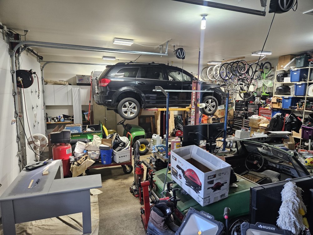

khnitz Posted October 24, 2025 Report Share Posted October 24, 2025 I will be completing a comprehensive rear suspension refresh this weekend on the 09 Journey. A little over a week ago I finished installing new inner and outer tie rod ends and front sway bar end links. larryl and 5rebel9 1 1 Quote Link to comment Share on other sites More sharing options...

Locosiete Posted October 25, 2025 Report Share Posted October 25, 2025 18 hours ago, khnitz said: I will be completing a comprehensive rear suspension refresh this weekend on the 09 Journey. A little over a week ago I finished installing new inner and outer tie rod ends and front sway bar end links. I'm confused how your strut has so much surface rust but the rest looks pretty clear. Not sure what brand those struts are but I'd stay away from them again 🤣🤣 khnitz 1 Quote Link to comment Share on other sites More sharing options...

khnitz Posted October 25, 2025 Report Share Posted October 25, 2025 (edited) Well, having lived its entire life in the rust belt, it was bound to happen... I started work on the right rear side. I've removed everything else and was working on the bolts for the rear trailing arm. I was able to get the inner bolt out, but the outer bolt snapped off near the head. So now I need to figure out how to get the rest of that bolt out and put a new one in. Any suggestions? Here's a picture of the old and new components, and another picture of the problem bolt area. I should add that I used an inductive heater on the bolt for a while before attempting to remove it. However, the bolt is so long, I don't think the heating had much effect at the captive nut in the unibody for the bolt. Edited October 25, 2025 by khnitz 2late4u and Locosiete 2 Quote Link to comment Share on other sites More sharing options...
