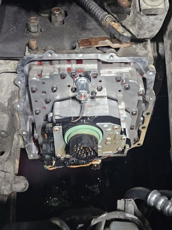

khnitz Posted November 22, 2025 Report Share Posted November 22, 2025 The new(er) tires were installed yesterday and an alignment was done. The '09 is tracking straight and the engine performed well over ~100 miles of driving. The transmission, however, needs some attention. It occasionally goes into a "limp" mode, where it stays in 1st (or is it 2nd) gear and doesn't shift. If I pull the car over, turn it off, lock the doors, and then wait for the security red flashing light on the dash to go out (about 20s - this is probably the time for the CAN bus to go to sleep), and then re-start the car, the transmission goes back to normal operation. P2764 is the DTC that is read (I have a Foxwell NT510 to read and clear codes). From what I found, it looks like that is for the Torque Converter Clutch solenoid. So, I'll be draining the transmission again (good thing I added that drain plug to the pan) and replacing at least that. Any other BTDT experience/help is appreciated. Other than when it would go into that mode (it happens seemingly randomly, but like once per trip at some point), the transmission is shifting smooth and goes through all gears. When the lump mode kicks in, going into manual shift mode has no effect (and you don't see the current gear in the IC display. Quote Link to comment Share on other sites More sharing options...
5rebel9 Posted November 22, 2025 Report Share Posted November 22, 2025 I can not find the info needed for your '09. Is it the 3.5 with 6 speed trans or the 2.4 with the 4 speed?....LOL, I just saw a 3.5 that should have the 62te My now gone '14 showed the code for that (3.6/62te) and it turned out to be the torque converter itself. Which in my many postings is a story all in itself, the new aftermarket converter was bad and had to be replaced again along with the flex plate which cracked from the bad torque converter. My friend made things right with minimal labor charge the second time. 2late4u and khnitz 2 Quote Link to comment Share on other sites More sharing options...
khnitz Posted November 22, 2025 Report Share Posted November 22, 2025 1 hour ago, 5rebel9 said: I can not find the info needed for your '09. Is it the 3.5 with 6 speed trans or the 2.4 with the 4 speed?....LOL, I just saw a 3.5 that should have the 62te My now gone '14 showed the code for that (3.6/62te) and it turned out to be the torque converter itself. Which in my many postings is a story all in itself, the new aftermarket converter was bad and had to be replaced again along with the flex plate which cracked from the bad torque converter. My friend made things right with minimal labor charge the second time. Yeah, it's the 3.5 with the 62TE. I'll start with that solenoid and see how it goes. It shifts fine otherwise (when not in limp). Quote Link to comment Share on other sites More sharing options...
5rebel9 Posted November 23, 2025 Report Share Posted November 23, 2025 Good luck with it being the sensor. When mine went, the symptoms were not going into 6th gear or "overdrive" , but ran and shifted fine thur the rest of the gears(of course having the CEL all the time). I can't say though that it was ever in "limp mode", just R thru 1-5 and operating as normal. At least yours being a FWD, there is a bit less demanding work to pull the trans IF needed than mine all having been AWD. khnitz 1 Quote Link to comment Share on other sites More sharing options...
John/Horace Posted November 24, 2025 Report Share Posted November 24, 2025 On second page Some info about changing TCC solenoid. khnitz 1 Quote Link to comment Share on other sites More sharing options...
khnitz Posted December 1, 2025 Report Share Posted December 1, 2025 (edited) I finished the work on the Journey over the weekend and drove it into work this morning - so far, so good! It was a balmy 11deg F when I reached the office 🥶 To resolve the P2764 DTC (Torque Converter Clutch Pressure Low), I replaced the Torque Converter Clutch (TCC ) solenoid. My drive to work is a mix of city and highway speeds. The transmission did not go into "limp" mode during the ~1hr drive, whereas during the drive last week (before replacing the TCC solenoid) it would go into that mode about once a trip. I checked multiple times during the drive that I could select manual shifting mode and it worked correctly each time. Fingers crossed, but this issue seems to be resolved 🙏 I also replaced the EGR valve to resolve the P0406 DTC. Here is a picture of the old and new EGR valves. It will take a few more trips to be sure, but this should resolve that DTC. The original EGR valve PN was 04593688AD, and it is now listed as 04593888AC. Lastly, I had to find a replacement lower transmission oil pan and install that as part of the TCC solenoid replacement. When I added the drain plug to the original pan, I observed some weeping at the joint where the bung was brazed to the pan (this was done on the outside of the pan). While making the TCC solenoid repair I had a friend weld the bung to the pan from the inside, as well. Unfortunately, there was still some seepage after the interior welding. I found a replacement pan in my local u-pull yard and installed that when I closed up the transmission - I wanted there to be no worry of fluid loss. I ordered a gasket for the front (solenoid pack) cover, instead of using RTV when reassembling everything. I used a gasket for the lower transmission oil pan, too. I'll drive the Journey through the week and make sure nothing else needs urgent attention, and then it will be going to its new owner in South Carolina in a week or so! Edited December 1, 2025 by khnitz 5rebel9 and Locosiete 2 Quote Link to comment Share on other sites More sharing options...

John/Horace Posted December 2, 2025 Report Share Posted December 2, 2025 Hey khnitz, nice clear pics of the repair. Glad it worked out. I need to do the same fix soon, no codes yet but occasional rough 3-2 down shifts, fluid done several times since new. Just curious about the torx bolt on the new solenoid, was the torque spec 80-90 inch pounds ? You used mopar part ? The right stuff in pic is not RTV, I think it's polyurethane like seam sealer, pricy stuff. Most tranny shops use it because in service right away no over night curing. Use it on my Ram for diffs and pan seals. Gaskets are fine too. Locosiete and khnitz 2 Quote Link to comment Share on other sites More sharing options...
khnitz Posted December 2, 2025 Report Share Posted December 2, 2025 12 hours ago, John/Horace said: Hey khnitz, nice clear pics of the repair. Glad it worked out. I need to do the same fix soon, no codes yet but occasional rough 3-2 down shifts, fluid done several times since new. Just curious about the torx bolt on the new solenoid, was the torque spec 80-90 inch pounds ? You used mopar part ? The right stuff in pic is not RTV, I think it's polyurethane like seam sealer, pricy stuff. Most tranny shops use it because in service right away no over night curing. Use it on my Ram for diffs and pan seals. Gaskets are fine too. For the TCC solenoid, I found 53 inch-pounds as the value for that torx-head screw. If I recall, 80 inch-pounds was for the pan-to-transmission-case bolts. On the rough shift you're describing, I also get an occasional hard shift - even with the TCC solenoid now replaced. But, I have not gone into limp mode or seen the P2764 DTC come back so far. Overall, the Journey is driving really well! So, based on what you're describing, I'm wondering if it is one of the solenoids in the solenoid pack, and not the TCC solenoid, that is an issue. In other news, the 0406 DTC has not come back, but I now have an 0401 DTC. I'm tracking down possible causes/resolutions in this thread. John/Horace 1 Quote Link to comment Share on other sites More sharing options...
5rebel9 Posted December 3, 2025 Report Share Posted December 3, 2025 Glad to hear that just the solenoid was the trick. I wish I had been that lucky, but we tried that on mine and did not fix my problem..then went to the torque converter! khnitz 1 Quote Link to comment Share on other sites More sharing options...
