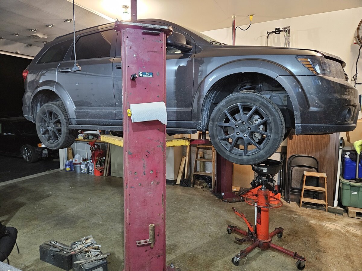

khnitz Posted March 20, 2024 Report Share Posted March 20, 2024 I'm performing some maintenance on my in-laws' 2014 Journey this week. The last bit of service I did on it was in 2022 (replaced LF wheel bearing/hub) while on the road at their home in IL, but this time I brought it back to my house in MI to tackle the work. On the to-do list: Oil & Filter Change Bleed/flush Brakes Rotate Tires New Serpentine Belt, Tensioner and Idler Pulley New Spark Plugs New Air Filter Remove the "wings" (large-platform running boards) Install a Panavise mount for a phone holder There's just under 57k miles on it now, so this should give it a nice refresh. 5rebel9 1 Quote Link to comment Share on other sites More sharing options...
5rebel9 Posted March 20, 2024 Report Share Posted March 20, 2024 OK, so now I'm ENVIOUS! No wonder WHY you preferred to bring it to your home to do the work Indoors AND a hoist!!!!!! Makes life {work} SO MUCH EASIER! khnitz and 2late4u 1 1 Quote Link to comment Share on other sites More sharing options...

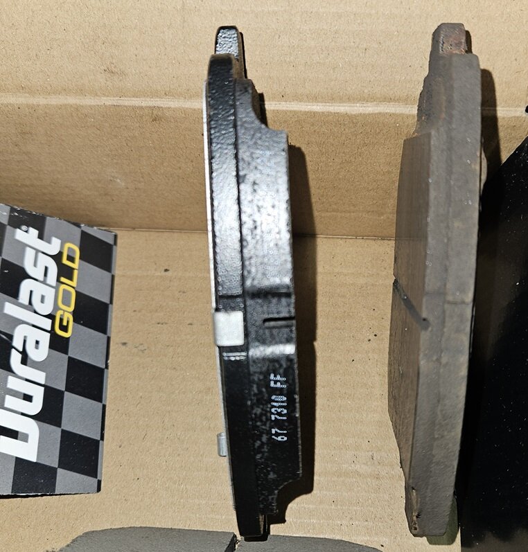

khnitz Posted March 22, 2024 Report Share Posted March 22, 2024 I completed the maintenance work over the last couple of days and the 300+ mile drive back to IL went without a hitch. I average 23.3 mpg at, let's just say *quick* speeds, (according to the Fuel Economy reading on the IC) on the last 200 miles - I reset it after my last fill-up. That was about 2mpg better than I saw on the drive from IL to MI before all the work. Granted, that's a small sample size for comparison. Here are some pictures of what was done... Old vs. New air filter. I couldn't read the make of the old (original??) air filter, but the new one is an AC Delco. I like the additional pleats vs the old one. In looking at how-to videos on removing the upper intake manifold to access the spark plugs, the ones I found talk about completely removing the rear intake bellow (somewhat under the cowl, between the throttle body and the upper intake manifold) first, and having to remove coolant hoses, etc. to make room to slide it out. I actually found it easier to move that bellows off of the TB and move it just a little back to access that last upper intake manifold bolt that is hidden by it, and then remove the upper intake manifold first. Then that bellow comes out easily and completes access spark plugs on the rear cylinder bank. The spark plugs were the OE Champion, and I used NGK Iridiums as replacements. Here are the old plugs, and a comparison of an old and new plug. I also rotated the tires and bled the brakes. While bleeding the brakes, I noticed the rear brake pads were getting low, so I went ahead and changed them. While I had the upper intake manifold off, I took a picture down of the back of the intake valves. They look pretty good/clean. Again, my in-laws' Journey had ~57k miles on it at this point. I also removed the platform running boards they had on there (they are hurting, more than helping, access at this point of their mobility). Let's see, what else...I topped off the coolant and power steering fluids. Oh, and I replaced the serpentine belt, its tensioner and idler pulley, as well - with the car being 10yrs old and the belt being original, it was just a preventive measure at this mileage. Another item - the lower seat side trim piece on the passenger side had been broken loose from repeated entry/exit to the seat. I found a way to use a hole on the seat frame and a trim panel clip to drill a 5/16" hole and secure that trim piece. Aside from having to live with the appearance of the trim clip, it holds that plastic piece securely and works for us. I'll get a picture of that later today and post it. larryl, 2late4u and 5rebel9 3 Quote Link to comment Share on other sites More sharing options...

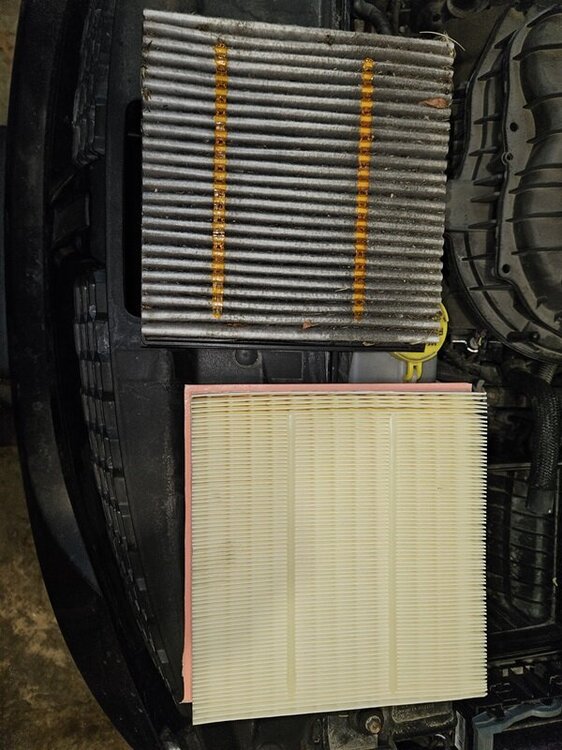

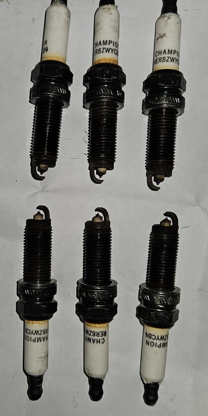

khnitz Posted March 24, 2024 Report Share Posted March 24, 2024 Some other details I made note of, but forgot to add to the summary post... The old spark plugs looked to be original, Champion RER8ZWYCB4. The new plugs I used were NGK Iridium LKR7DIX-11S . The air filter I removed (maybe it was original?) had 23 pleats and the extra debris (charcoal?) filter membrane. The new air filter was an AC Delco A3618C with 78 pleats. The oil filter that was removed was a Napa 2100010 with 48 pleats. The new Mahle OX1213D has 57 pleats. Quote Link to comment Share on other sites More sharing options...

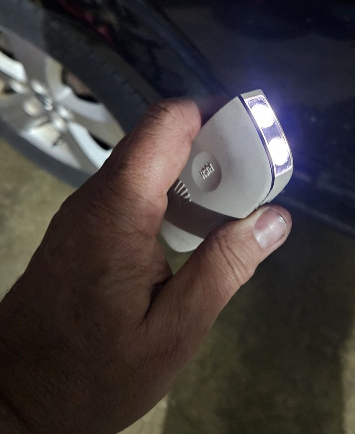

khnitz Posted August 27, 2025 Report Share Posted August 27, 2025 I bought a new battery for the rechargeable flashlight in the luggage compartment - the light is working great, again! I did have to clean up the contacts for the battery, though. I used a Varta V600-HRT battery from Amazon. Locosiete 1 Quote Link to comment Share on other sites More sharing options...
