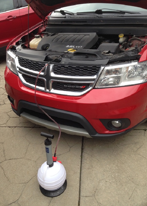

My plan is to do the filter change, then a syphon weekly for 2 weeks.  I'll buy 10 liters of fluid total and when that's gone, I'll be done.  (Assumption is 5-6 liters on the filter change then 2-3 liters for each of 2 syphons.  Another assumption is that the trans oil removed is not burnt or gritty, which is a whole another story if it is. ).  Luckily I do have a pump/syphon for extracting the trans fluid for the followup syphoning.  I'll do a lot of measuring of the fluids removed to accurately replace with the same as well as look for that bolt that address the level and I'll order up a trans dipstick too.

We are close , I live 30 minutes away from Windsor / Detroit crossings, getting colder now, get it done sooner than later. I used a manual syphon too and the temperature may affect tube flexibility. I used empty washer fluid jug to store and mark how much fluid I removed,  refilled jug to line with new fluid , same amount removed and replaced. This is the gasket material I used after cleaning old gasket materials from both faces, try to get an even coat all the way around. Make sure you hear and feel the new plastic filter snap when pushing it back into place, ensuring it is seated correctly. Easy job just takes some time next weekend looks good for doing this work. Good Luck

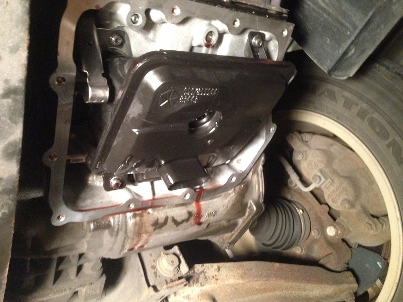

The trans fluid and filter have been changed.  No surprises.  The process was just as most Youtube videos lay out.  The old fluid was brown but not gritty.  As expected, there was sludge buildup by the magnet, but no metal pieces.  Definitely it was time to change the trans fluid, clean the pan, and replace the filter.

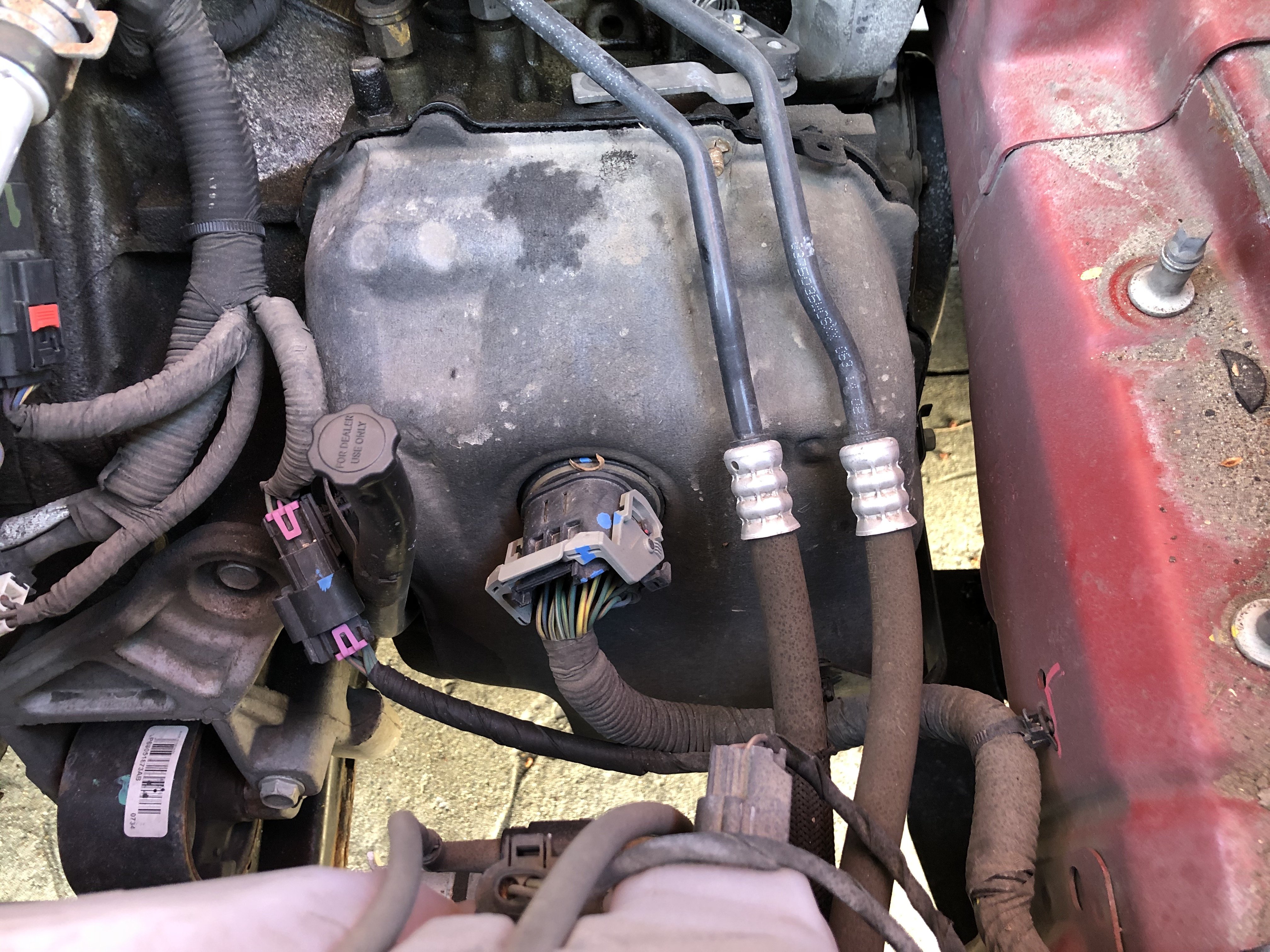

After removing the airbox, the picture below is of the trans covers that needs to be removed, the electrical connections that would need to be disconnected, and possibly trans hoses that would need to be disconnected, to access the TCC valve, which I believe sits on top of the solenoid pack under these covers.
