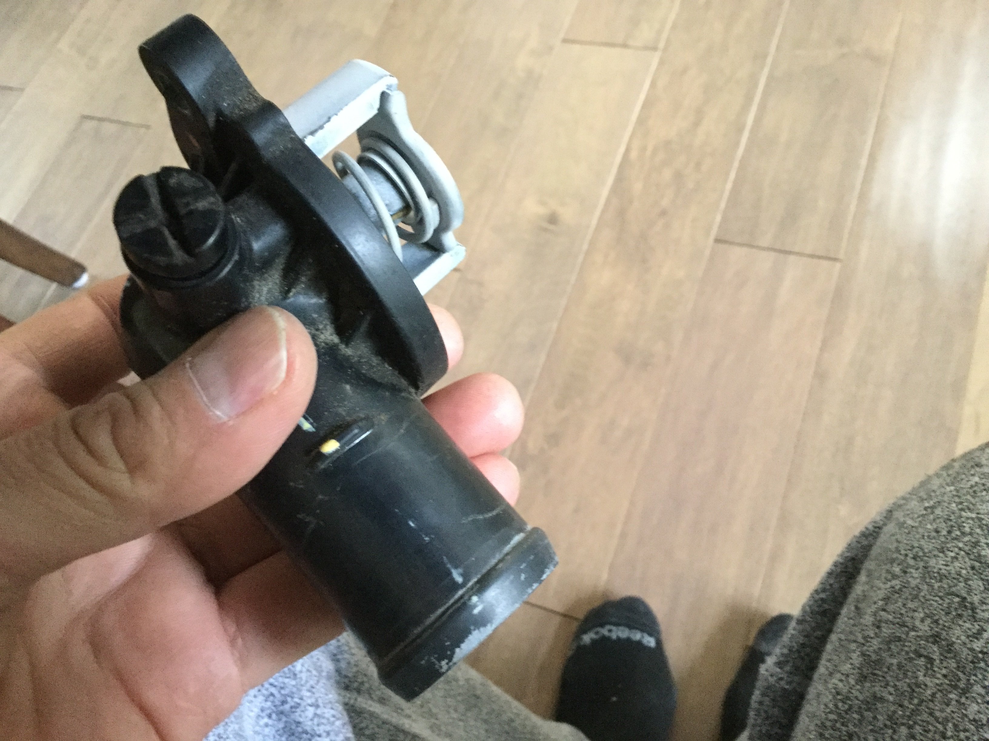

John/Horace Posted May 8, 2020 Report Share Posted May 8, 2020 (edited) Allen key needed for #2 screw in picture for air bleeding. His 3.5 was over heating as well. https://www.chargerforums.com/threads/burping-the-coolant-system.320393/ If air lock comes back there air coming into system some where. Edited May 8, 2020 by John/Horace OhareFred and jkeaton 2 Quote Link to comment Share on other sites More sharing options...
MoNab Posted May 8, 2020 Author Report Share Posted May 8, 2020 47 minutes ago, John/Horace said: Allen key needed for #2 screw in picture for air bleeding. His 3.5 was over heating as well. https://www.chargerforums.com/threads/burping-the-coolant-system.320393/ If air lock comes back there air coming into system some where. Are you sure that’s the right engine? Looks different to me. Quote Link to comment Share on other sites More sharing options...
MoNab Posted May 8, 2020 Author Report Share Posted May 8, 2020 For some little context, I was driving it alL day today without any issues. It then started overheating, after I hit the gas hard. No heat in the cabin. Coolant started expanding and exiting the reservoir. Quote Link to comment Share on other sites More sharing options...
John/Horace Posted May 8, 2020 Report Share Posted May 8, 2020 Look for bleeder screw on top of engine, should be there, the pic should be close. If air comes back it’s head gasket, water pump etc letting in air. Aluminumn engines don’t like to overheat, major damage quickly, unlike cast iron. jkeaton 1 Quote Link to comment Share on other sites More sharing options...
MoNab Posted May 8, 2020 Author Report Share Posted May 8, 2020 5 hours ago, John/Horace said: Look for bleeder screw on top of engine, should be there, the pic should be close. If air comes back it’s head gasket, water pump etc letting in air. Aluminumn engines don’t like to overheat, major damage quickly, unlike cast iron. None that I see. Quote Link to comment Share on other sites More sharing options...
John/Horace Posted May 9, 2020 Report Share Posted May 9, 2020 With the plastic covers in place on the newer cars, it’s pretty hard to see anything. The pic is the 3.6/bleeder screw built into plastic thermostat housing. jkeaton and 2late4u 2 Quote Link to comment Share on other sites More sharing options...
MoNab Posted May 11, 2020 Author Report Share Posted May 11, 2020 On 2020-05-09 at 4:12 PM, John/Horace said: With the plastic covers in place on the newer cars, it’s pretty hard to see anything. The pic is the 3.6/bleeder screw built into plastic thermostat housing. I’ve found the bleeder screw. Tried bleeding it. Keeps overheating. The hoses that go to the front heater core front the engine one is cold one is hot. Replaced the heater core same issue, I’m thinking it’s a bad head gasket Quote Link to comment Share on other sites More sharing options...
John/Horace Posted May 11, 2020 Report Share Posted May 11, 2020 (edited) Try pressure testing system, could be reservoir cap or water pump or something letting air in system. On cars with cap on top of rad it’s sometimes easy to see air bubbles coming to the top with car started and cap off. One hose going to heater core is supply, the other is return. Often there is a bypass valve actuator controlled by hvac that enables flow to core. With air bubbles in system water pump cavitates and can’t push glycol where it needs to flow to, even if hvac is functioning correctly. Edited May 11, 2020 by John/Horace Quote Link to comment Share on other sites More sharing options...
