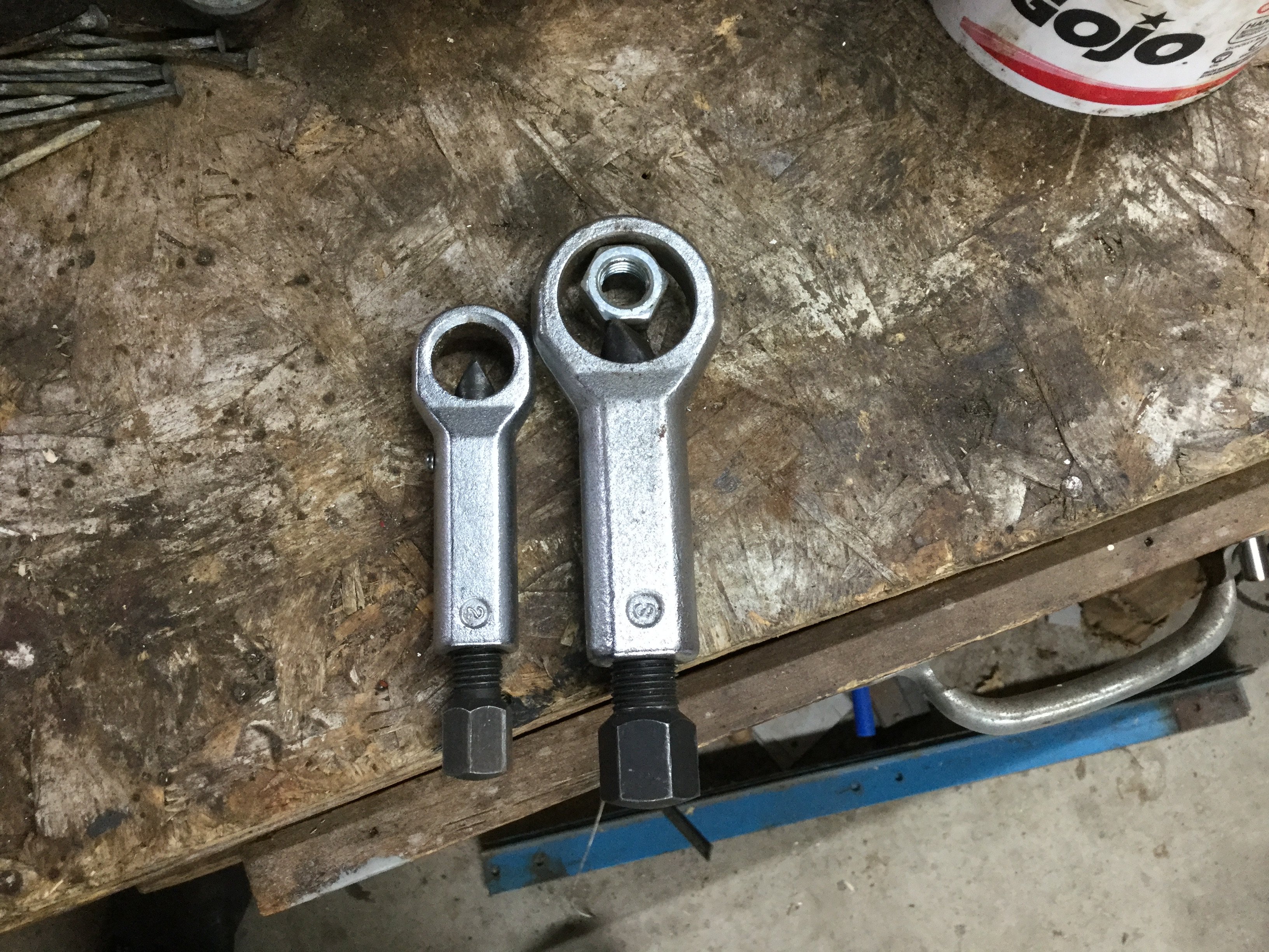

John/Horace Posted April 13, 2020 Report Share Posted April 13, 2020 (edited) Another option is a nut splitter. It wrecks nut but doesn’t damage threads underneath. Princess Auto (Harbour Freight) and Canadian Tire carry them. Buying online from web site and pick up only, no store entry in my area, social distancing. Larger one is $25 at crappy tire regular price. Edited April 13, 2020 by John/Horace 2late4u 1 Quote Link to comment Share on other sites More sharing options...
