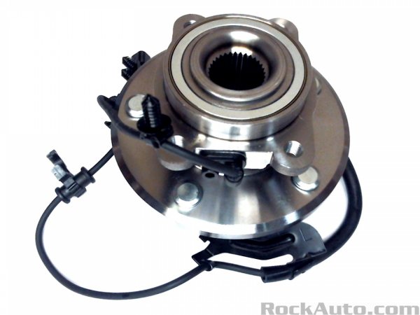

The rear bearing hub comes with the abs sensor built in and a new cable (see pic). Front bearing has no sensor build in, sensor mounts on the spindle housing. Sensor and cable are an integrated one piece unit as you know. No visible toner ring on c/v like 2late4u is saying. Not sure how it figures out speed, splines in c/v shaft not close enough to measure.
5FABDEB9-7F80-40B6-80A5-925D5A190359.jpeg.06aaea9a4b809b7ae4e73a885599d2ee.jpeg16596AA7-A00A-42C1-96A4-0D61877DAEDB.jpeg.2518504a6cb6a9f13f5ee1013c996ac4.jpeg
