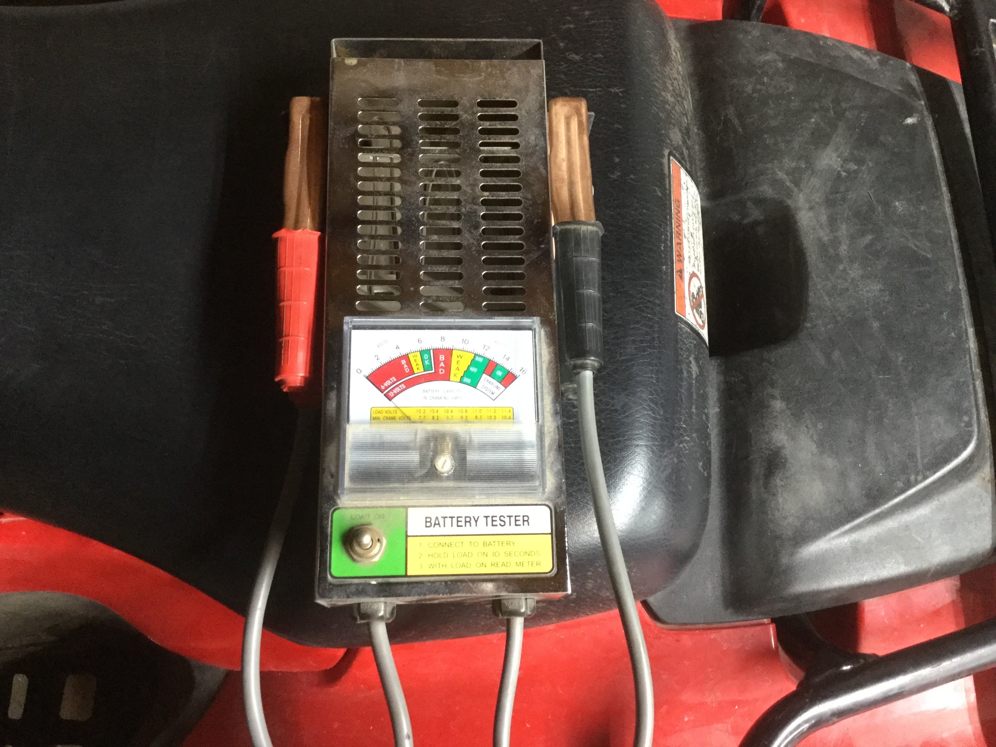

John/Horace Posted February 14, 2020 Report Share Posted February 14, 2020 (edited) If your journey started at -40 without a block heater, your battery is probably still fine. My 2014 r/t battery is still original and vehicle has 175k kilometers on it. Synthetic oil really helps with extreme cold starting IMO. On an old school analog load tester is still showing over 400 cranking amps at approx 50 F. The digital units at the parts stores are definetly more accurate. Just changed daughter in laws 2012 original journey battery on a 2.4 (little easier to crank) at Xmas with Costco unit. It was still functioning but she works shifts at a hospital, wanted to avoid problems. Old battery gets recycled to my lawn tractor now. I have to say I’m fairly impressed with the factory batteries; lots of power options on these cars as well. Pick a warm day if you do change battery, lots of plastic clips to wrestle with. Not my favourite place to work on a battery in a slushy wheel well. The 2.4 had tons of room under hood without having to use wheel well. Soak the 9/16 nuts on the battery hold down bracket with PB Blaster spray half hour before starting job. They get pretty corroded from the road salt. Old school battery tester picture. Edited February 14, 2020 by John/Horace larryl and Shawn855 2 Quote Link to comment Share on other sites More sharing options...

John/Horace Posted February 17, 2020 Report Share Posted February 17, 2020 I’ve never seen a car start with a battery that measures 11.5volts. You must be boosting it or your meter is inaccurate. Battery after 4 years pretty common. Not a lot of extra room on fender pedestal, get the right group number to fit. Summer Solstice and Shawn855 2 Quote Link to comment Share on other sites More sharing options...

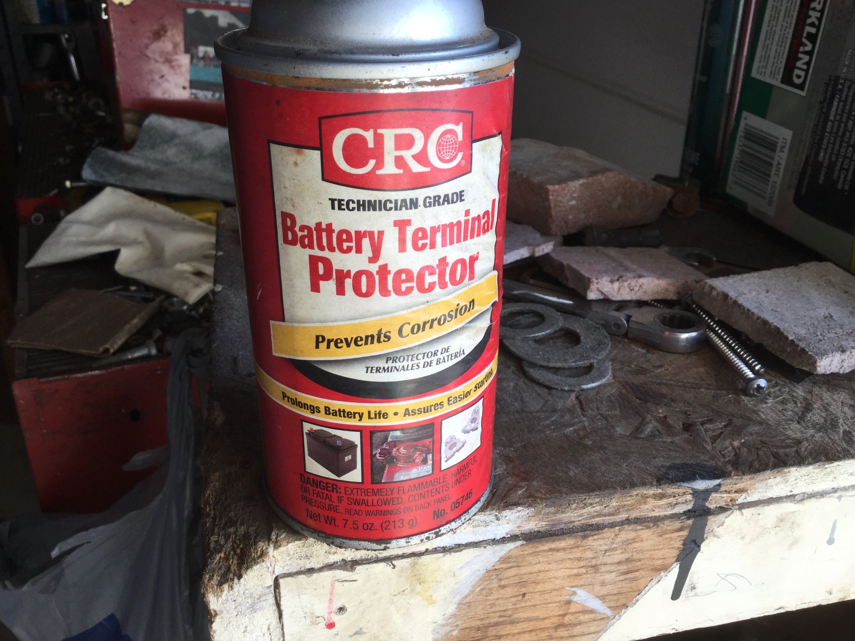

probak118 Posted February 18, 2020 Report Share Posted February 18, 2020 Dad was mechanic and always covered battery posts with anti corrosion type spray too.As mentioned, not much room to move a can all around in the wheel well area. Not sure if another coating I have seen done (Vaseline) is any good but never seen corrosion on that battery either. John/Horace and Shawn855 2 Quote Link to comment Share on other sites More sharing options...
2late4u Posted February 18, 2020 Report Share Posted February 18, 2020 13 hours ago, Shawn855 said: I just connected my odb2 scanner and it was also showing 11.5v with the vehicle off so I'm thinking it might be an accurate read. Once it started, it shot back up to 14.6 (thank god, did NOT want to deal with an alternator issue just yet). Again I'll check the battery posts come summertime but just reporting what I'm seeing. i use that crc stuff as well,better then the little felt pads they sell at the part stores Shawn855 and John/Horace 2 Quote Link to comment Share on other sites More sharing options...
