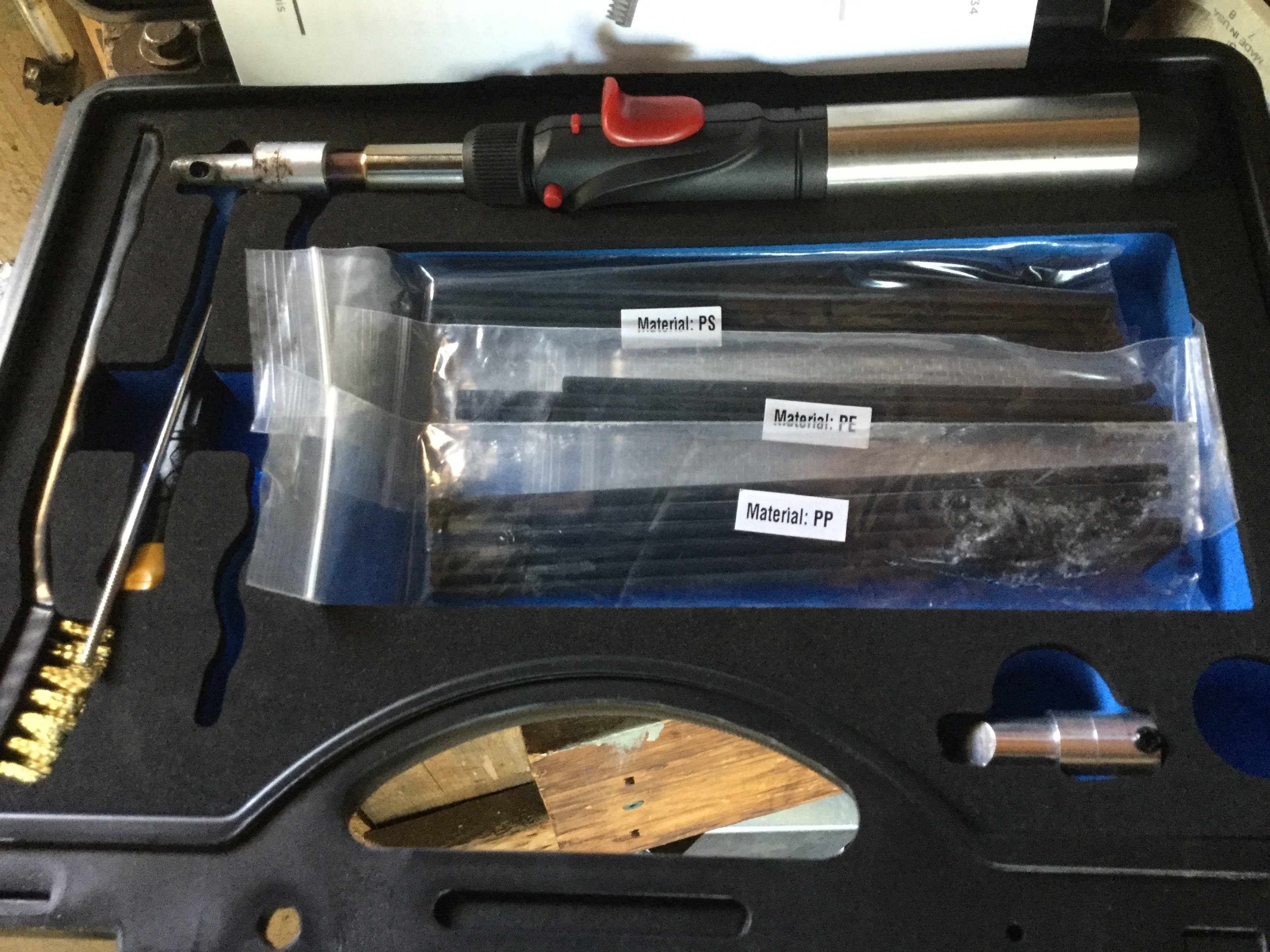

On hyundai forums there was guys who heated up head light housing in an oven to take them apart, drill holes ands add extra lights.
Then thermoweld in oven to get them back together again. They claimed no leaks afterwards. Exact temperature to soften old weld had to be reached etc. I have a small kit for thermowelding, have experimented on a few things. Not brave enough for a light housing in my daily driver yet. Princess Auto/Harbour Freight welding kit, not that pricy.
Poly ethylene, poly propylene, poly styrene welding rods.
