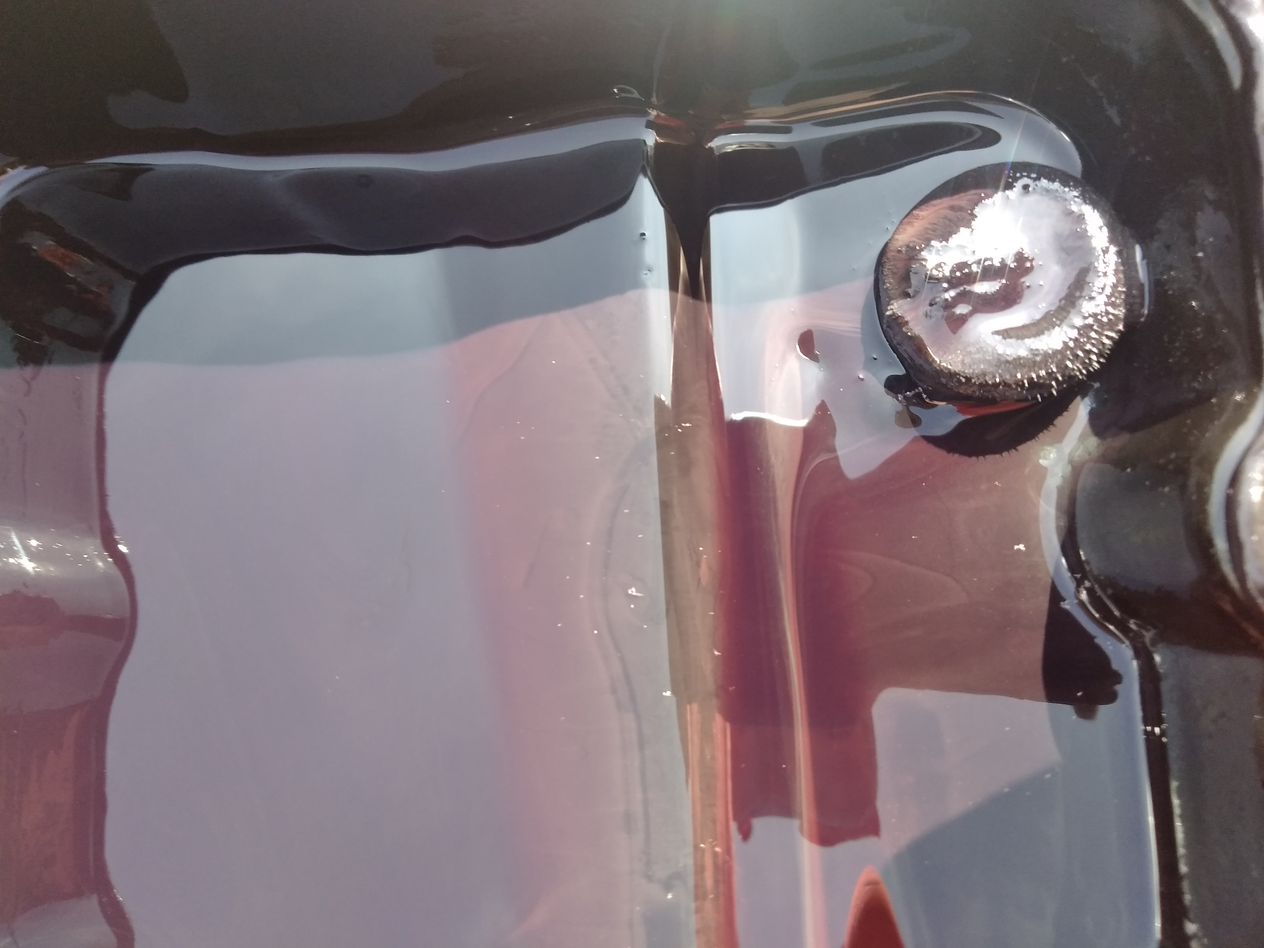

wantoo Posted March 27, 2019 Author Report Share Posted March 27, 2019 Well dropped pan,no pieces just metal shavings.. See pics. Would this be considered a failure? About to change the filter and refill. See what happens Quote Link to comment Share on other sites More sharing options...
redtomatoman Posted March 28, 2019 Report Share Posted March 28, 2019 This happened to me. My transmission was found to have metal shavings in the fluid. I got a check engine light, but mine was working and shifting fine for the short amount of time that I drove it while taking it to the dealer. Dodge diagnosed a complete transmission failure and replaced the entire transmission. I have the lifetime max warranty, so maybe that had some effect. My understanding is that metal shavings indicate impending major transmission issues. Good luck. Peace. jkeaton 1 Quote Link to comment Share on other sites More sharing options...
jkeaton Posted March 28, 2019 Report Share Posted March 28, 2019 Metal shavings are not a good thing. Quote Link to comment Share on other sites More sharing options...
