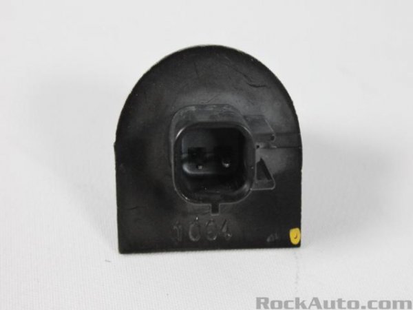

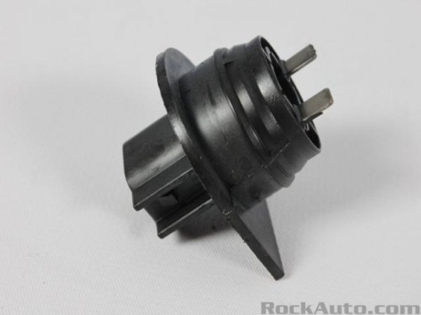

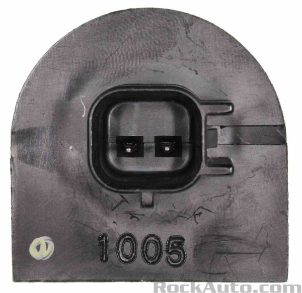

2late4u Posted January 12, 2022 Report Share Posted January 12, 2022 (edited) actual part cost is less than $5. Orileys part store,,,, not sure how hard to replace on our journeys ,any one having a problem might want to try this first Edited January 12, 2022 by 2late4u John/Horace 1 Quote Link to comment Share on other sites More sharing options...
John/Horace Posted January 12, 2022 Report Share Posted January 12, 2022 (edited) This is what he was cleaning, very clever fix actually. Probably have to drain and remove jug to change part. Cleaning seems easier, just don’t use wife’s tooth brush; too cold to sleep in garage this time of year.? Edited January 12, 2022 by John/Horace jkeaton and 2late4u 2 Quote Link to comment Share on other sites More sharing options...
