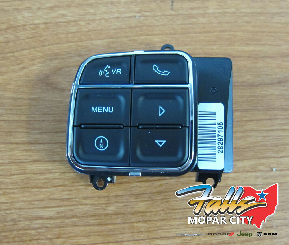

jkeaton Posted June 18, 2019 Report Share Posted June 18, 2019 Do you have the buttons on the steering wheel for uconnect? Quote Link to comment Share on other sites More sharing options...

jkeaton Posted June 19, 2019 Report Share Posted June 19, 2019 9 hours ago, Pete s said: Not sure what the buttons would look like It would be in your owners manual, but here. There are buttons on the right side of the steering wheel if it is equipped with uconnect. Quote Link to comment Share on other sites More sharing options...

bramfrank Posted June 20, 2019 Report Share Posted June 20, 2019 (edited) Ummm . . . . you have uconnect. ALL Dodge Journeys manufactured as of 2011 have uconnect. Clearly the idiot you spoke with at the support line has no clue. Do not confuse the two; uconnect is the radio and aircon touch display. Bluetooth is the subsystem that allows you to wirelessly connect your phone to the vehicle and is a separate feature and order code. The presence of Bluetooth is evidenced by the top two buttons on the steering wheel control as shown above. If you don't have the two upper voice command/phone buttons then you have no Bluetooth/voice commend. You can go online with your VIN and get the build sheet for your vehicle which will show whether it has Bluetooth (but you needn't bother, since the presence or absence of those extra buttons will tell you what you'd like to know). Having said that, with the exception of a series of vehicles produced early on during a parts shortage, EVERY vehicle with the 8.4" display has the Bluetooth and voice command and if it doesn't, then either your vehicle was upgraded to the 8.4" display by the previous owner (and can't have the Bluetooth retrofitted) or if it does the BT module is dead. And again, you can tell by the presence of absence of the extra steering wheel control buttons. If you have the buttons then the BT module or its connections are at issue and the subsystem needs to be fixed. If you don't, then the vehicle was misrepresented. And no matter why, whether error or misrepresentation, if they can't get the OEM BT function working, then hand them back the vehicle, get your money back and shop for another one that meets your needs. The Dodge agent can only help if the buttons are there and Dodge refuses to repair it since the vehicle is still under warranty. Otherwise this is between you and the selling dealer. Edited June 20, 2019 by bramfrank Summer Solstice and OhareFred 2 Quote Link to comment Share on other sites More sharing options...
