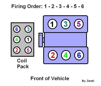

Can anyone help me find where cylinder no 5 would be located on my 2009 dodge journey sxt 3.5L. It has a check engine light on and the code is P0305.
