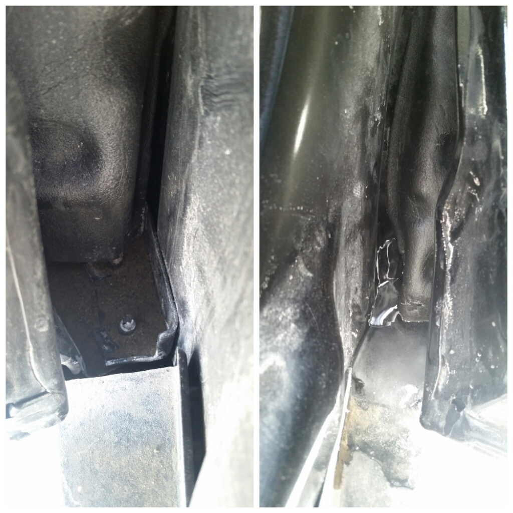

Is anyone having problems with ice building up in corner of front inside door on passenger side? There is a hole with a bolt sticking up and there is a big chunk of ice built up there and when I open door the corner of door brings up in it. I am afraid that it will kink corner of door. I chips away the ice daily so the door can be opened but it continues to build up there. It also builds between the two doors on passenger side on the inside and when door opens in back the corner of door brings up in the ice. Anyone having the same problem and did you find out what is causing it?

A year ago the water and ice built up so bad that it chipped the paint off the inside of the front fender. Dodge had to pay the auto body shop to have it repaired. I figured that while my vehicle was at the auto body shop that they would fix the problem with water and ice building up in that hole where the bolt is. But guess what...they never! We had allot of snow on Tuesday and by Friday morning that hole was filling up with ice. Behind the black foam above the hole that is behind the wheel well is pack jammed solid with ice. Ice is built up on the wheel well on the outside more on the passenger side then on the driver side. I love my Journey and this is the only complaint I have with it when I'm afraid that ice will built up allot and bend corner of door when opened. I think Dodge should put out a recall for anyone having this ice buildup issue. I need this fixed and the dealership here hasn't done anything to help me out other then get the chip of paint repaired.

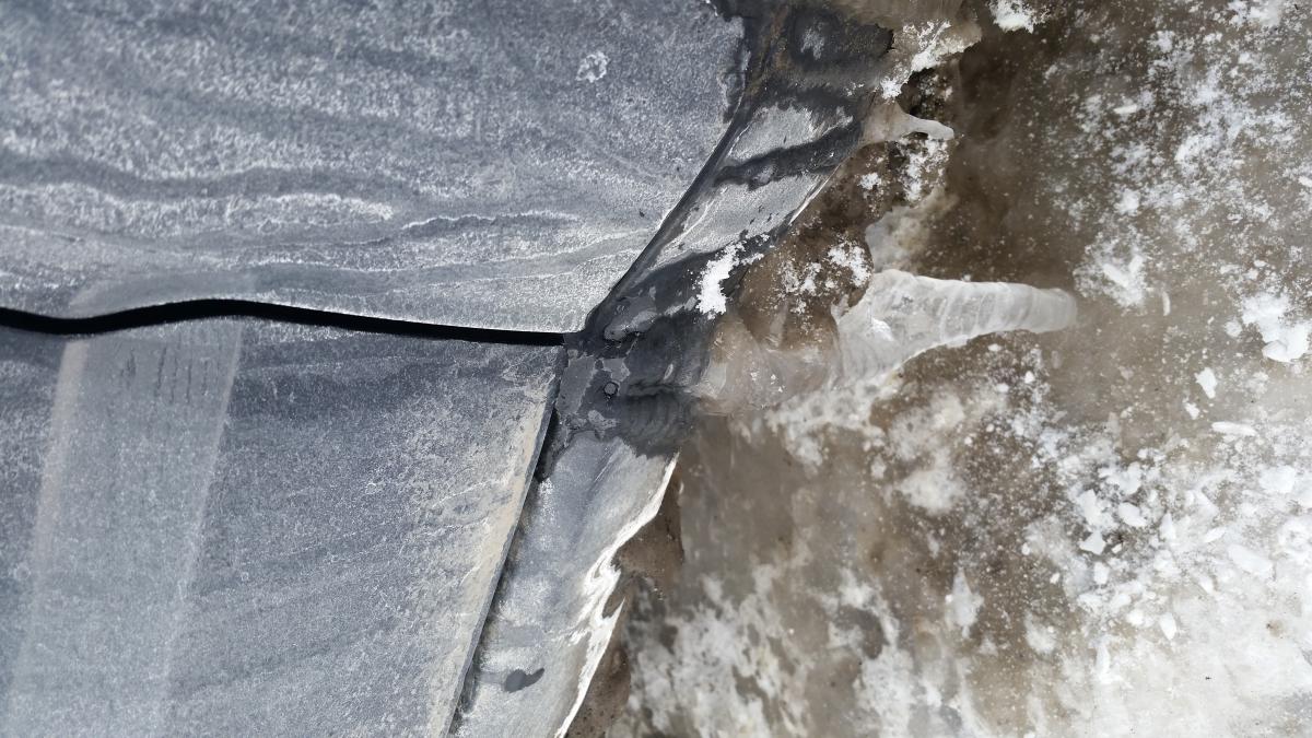

This is an icicle that formed outside the vehicle and froze to the ground. You can see where the water is coming out though between the door and wheel well. I haven't opened my door since 2:00 pm on Saturday and I'm afraid to open it, afraid I'll kink up the corner of the door.

That is wierd indeed. Why does the vehicle have a drain tube if there's no sunroof? Where is it draining from, the windshield area?
The auto body shop said there was a drain tube there. I've searched online everywhere on a dodge journey with a drain tube to find its location and everything I found mentioned a sunroof. Its getting in somehow. I spent yesterday chipping the ice out from under the wheel well. Inside the wheel well towards the chassis where the engine is bolted on there was a huge chunk of ice and it was clear. It wasn't from ice built up from driving over snowy roads. The driver side never had any ice built up in that area at all. I need to find where the water is running when it melts off my roof and windshield.
I would suggest the air intake/cowl drain is plugged therefore
snow melting at the windshield/roof levels are building up under the cowl and overflowing.
