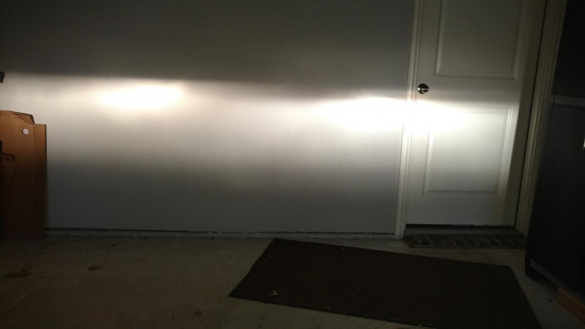

Just swapped in the 9012 bulbs for lo beams. Right side is new, left side is OEM. Against the garage wall there seems to be a bunch more light being thrown out. Will have to see driving in the real world at dark time for true test tho.
What kind of bulbs are you replacing the OEM's with? The new bulb seems to have a less yellow and more white tint.
He said 9012.
regular replacement bulb is 9005 so thats why he had to trim parts of the bulb base of the 9012 bulb to fit in and for the connector to plug up to the existing wire connector..as the 9012 bulb is not the correct bulb for our journeys... this has been discussed in other post in the forum . as i havent done either option i am not for sure but i would think going led would be easier and cheaper than buying a 9012 bulb and then trying to make it fit for a little improvement that it may give ,but as i said before i havent tried either option, maybe some of our other posters can elaborate on it?

Going to HIR is the better option because the filament is properly placed for the reflector - you get about 45% more light for the same power too and it all goes where it is designed to go.
The HIR bulbs last longer than traditional halogens as well.
Yes, you do have to trim down one tab on each bulb base though I am not certain why they do that longer tab thing for the HIR bulbs since they are functionally identical to the 9005/9006 - (there are lots of templates out there to do this). Perhaps it is to prevent people from putting Halogens in place of HIRs, though if that was the case the Halogen would logically need to be the one that requires trimming.
As to cost? A set of 4 HIR bulbs will set you back $73 shipped - marginally more expensive than decent LEDs, but you get a brand name for your money and a flawless beam pattern - and you are essentially street legal, too.
