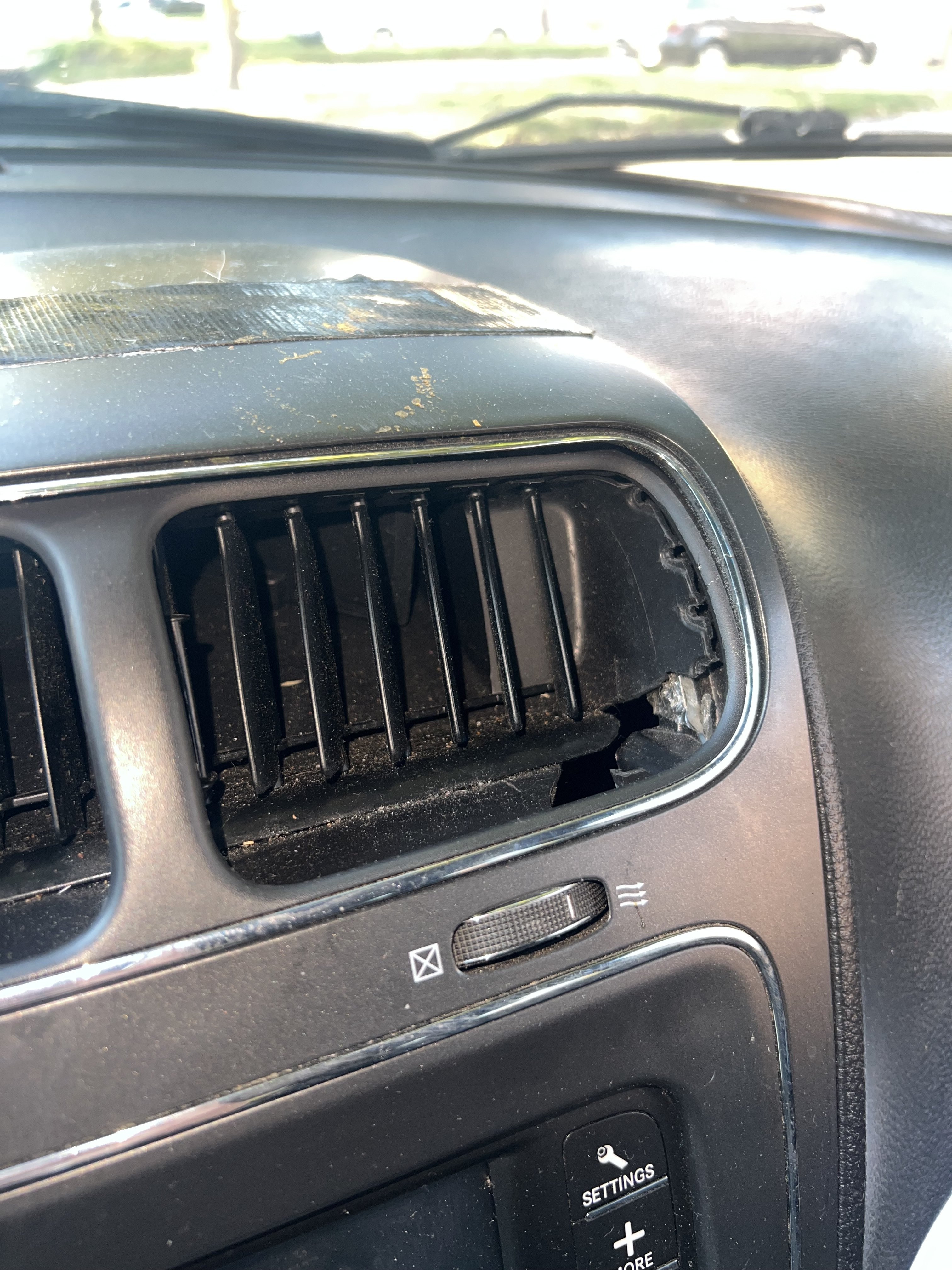

Dodgejourneygirl Posted September 13, 2025 Report Share Posted September 13, 2025 Hello and thank you for reading!! My 2013 Journey had issues in May including not starting without a booster, speedometer needle dropping (no loss of acceleration), flickering interior and exterior lights and the ABS, parking brake and traction control lights would intermittently flash and beep while driving. Apparently the mechanic replaced the battery cables but for the past 2 weeks I have been in the same situation. When I am driving everything is fine until I hear the glove box light turning on and off. Then all the other symptoms begin. I was told by the same mechanic it is either a faulty wire or cluster gauge. I am hoping for a less expensive fix. If anyone has had a similar issue please let me know what worked for you! The glow of the light in the glove box after the car had been turned off and door was opened and shut again. Quote Link to comment Share on other sites More sharing options...

Dean H Posted September 14, 2025 Report Share Posted September 14, 2025 (edited) Stop the presses! ,🎉🎉🎉 The picture posted above with the light in it. Is the passenger HVAC vent above the touch screen. Orange circle in my picture below. Nowhere near the glove box. Green box. We need a daylight clear picture with flash. Of that vent where the light is. Edited September 14, 2025 by Dean H Dodgejourneygirl 1 Quote Link to comment Share on other sites More sharing options...

Dodgejourneygirl Posted September 14, 2025 Author Report Share Posted September 14, 2025 1 hour ago, Dean H said: Stop the presses! ,🎉🎉🎉 The picture posted above with the light in it. Is the passenger HVAC vent above the touch screen. Orange circle in my picture below. Nowhere near the glove box. Green box. We need a daylight clear picture with flash. Of that vent where the light is. Yes it was from the vent that you showed. My dad disconnected the power supply directly to the glove box earlier, no glow right now but I haven’t driven it or turned it on since he did that. Thanks for your help. I truly don’t know why you are so willing to help an internet stranger but I more than appreciate it. Nice to have a sense of community. Dean H 1 Quote Link to comment Share on other sites More sharing options...
