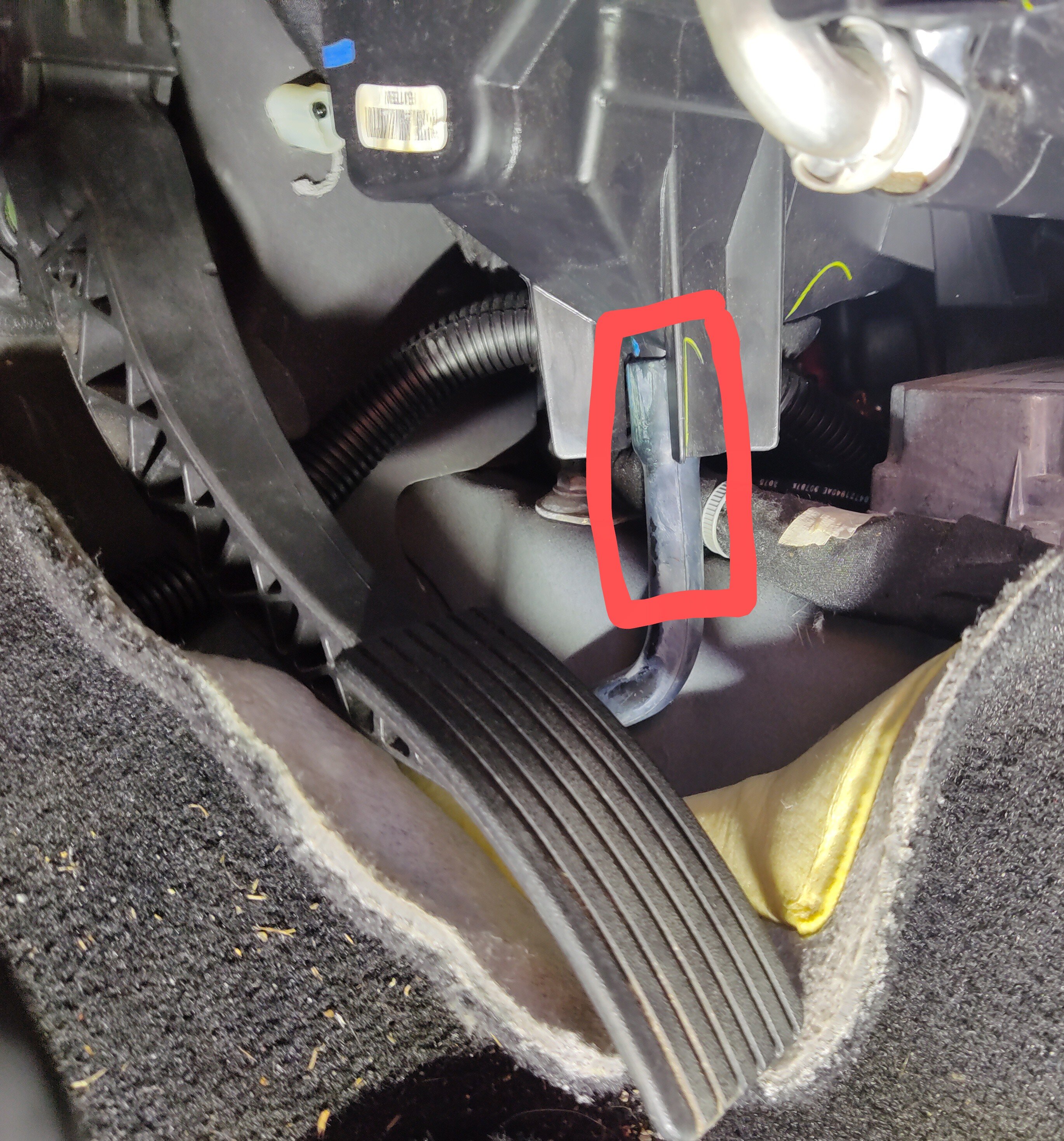

Dean H Posted May 21, 2024 Report Share Posted May 21, 2024 For reference on the a\c drain hose. You can easily access it inside. Located next to the gas pedal. You remove a small plastic panel. It has one trim push pin that goes up into the dash. Locosiete 1 Quote Link to comment Share on other sites More sharing options...
Locosiete Posted May 22, 2024 Report Share Posted May 22, 2024 2 hours ago, Dean H said: For reference on the a\c drain hose. You can easily access it inside. Located next to the gas pedal. You remove a small plastic panel. It has one trim push pin that goes up into the dash. At first I thought it was a serpentine belt and was like where the heck is that. Then I realized it was the gas pedal ? ? ? Quote Link to comment Share on other sites More sharing options...
