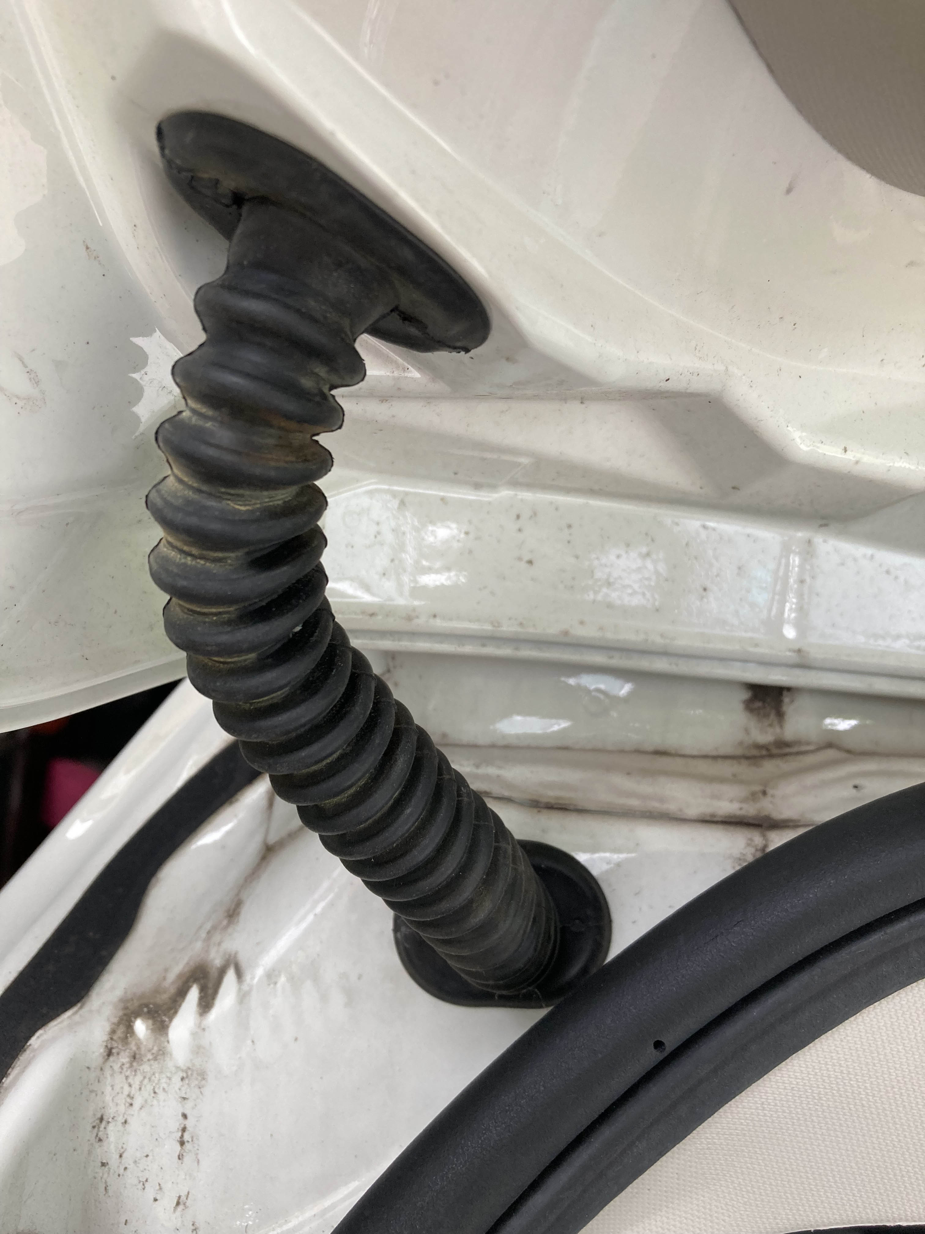

Starzfan31 Posted October 2, 2020 Report Share Posted October 2, 2020 Had this same problem fixed by my dealer a year and a half ago, just had to fix it again. The wires going thru the loom are pulled so tight that they break. The dealership put on a splice that made the wire even shorter, so boom, it happened, again. I fixed it and put an extension on that wire so it cannot get pulled that tight again. Such a common problem and so easy to fix if you know where to look. When mine broke, it took out my right inner light, my right reverse light, my tailgate light and my license plate lights. 20 minutes later, all working again. Quote Link to comment Share on other sites More sharing options...

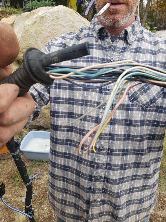

Cameo/NH Posted October 9, 2021 Report Share Posted October 9, 2021 I was suffering from the same problem, I lost all liftgate lights and the lock at the same time losing that much on the liftgate at once told me to check the harness. After spending $104 on mopar.com I got the wiring harness here is the old harness I removed, problem fixed. There was a total of 8 wires broken inside the boot. Before you drop money on new led lights which are $250-300 a piece I urge you to check the harness. larryl, 2late4u and jkeaton 3 Quote Link to comment Share on other sites More sharing options...

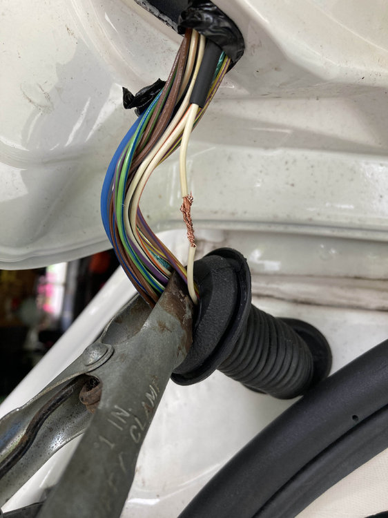

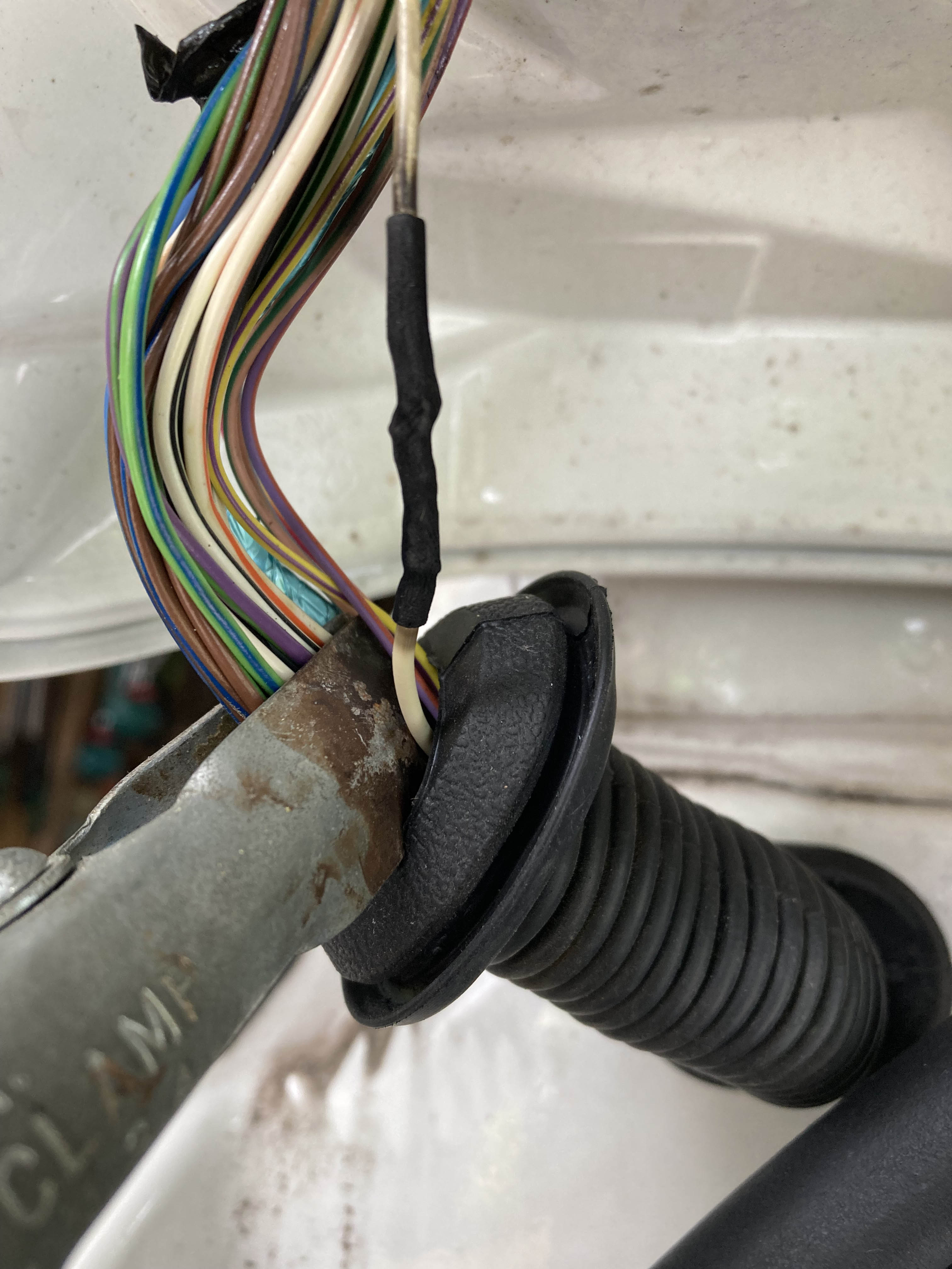

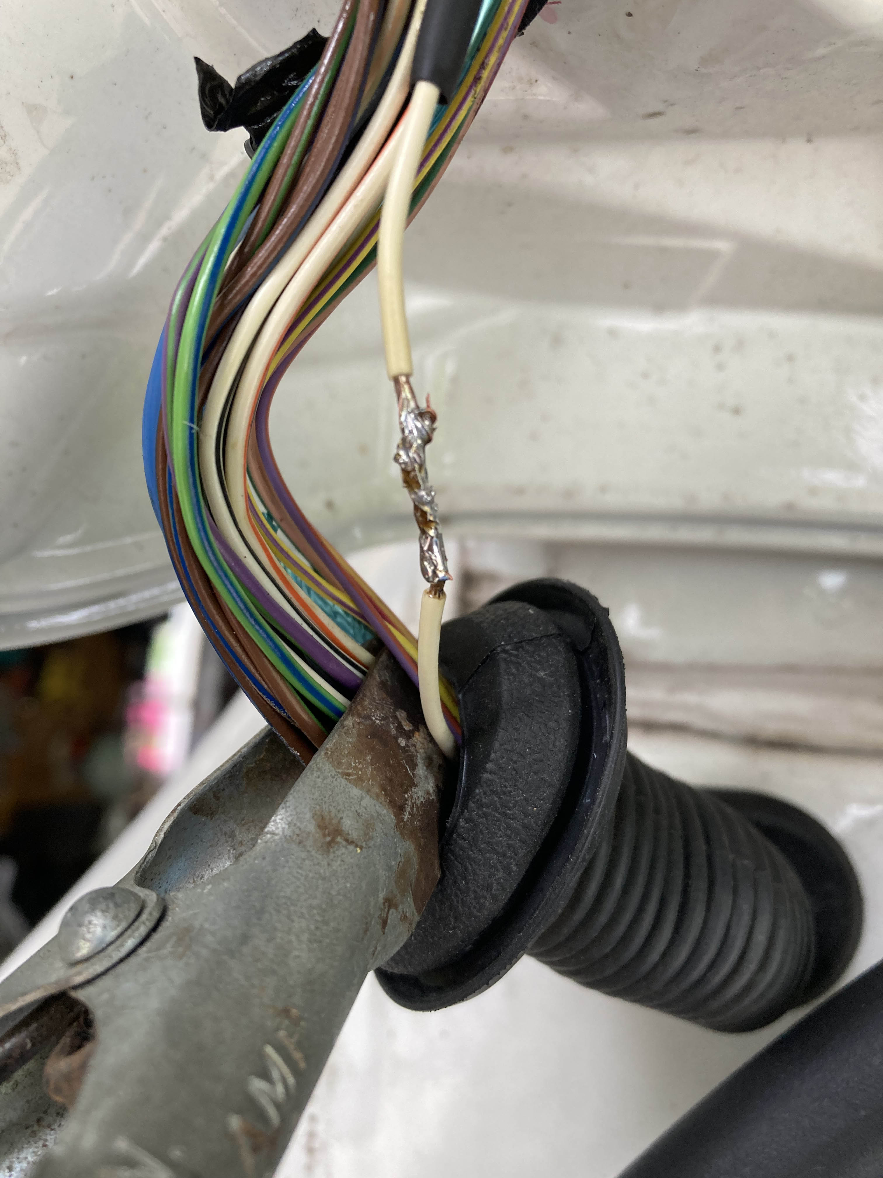

MikeGyver Posted July 15, 2023 Report Share Posted July 15, 2023 (edited) I had the same problem. Bought a new inner tail light assembly on Amazon but that didn't fix the problem. Peeled back the harness cover to find a broken wire. Splice, solder, shrink-wrap, problem solved. Saved $65. Hopefully it lasts. Edited July 15, 2023 by MikeGyver Quote Link to comment Share on other sites More sharing options...
Journeydc Posted July 9, 2024 Report Share Posted July 9, 2024 Thanks for the great posts on the non-working LED light. A broken wire was my problem when I cut open the boot that covers the wires. I did exactly what Mike G did- solder the broke wire & use shrink. I then hooked up the old LED assembly & it worked great! Now packaging the new LED assembly I bought to send back to Amazon. Thanks again for the helpful posts. 2late4u 1 Quote Link to comment Share on other sites More sharing options...

John/Horace Posted September 19, 2024 Report Share Posted September 19, 2024 (edited) Get someone who knows how to solder. Or practise a bit to see if you get the hang of it. Watch utube soldering links. Need to pretin wires first, then solder them together. Electronic flux is useful even if flux core solder used. Need multi strand copper wire of same or bigger gauge. I think I broke one more during soldering process, ended up with 5 bad wires. Test everything while harness is still apart. The wires break because not enough slack in harness, not too little. I added a maybe 6 inch splice to each broken one, I needed the extra space to separate and solder properly. Tucked some wire further into gate and folded some of the new slack into wire bundle. Grommet was sliced longitudinally. Used small zip ties to hold wire bundle together. Then used them around grommet to hold around fixed wires, urethane caulk used on cut seam held together with wraps. It’s like extra wire in house wiring junction boxes. Can fold extra into loops and make it go away. Electronic Tec’s would do this in their sleep, of course. Edited September 19, 2024 by John/Horace larryl 1 Quote Link to comment Share on other sites More sharing options...
