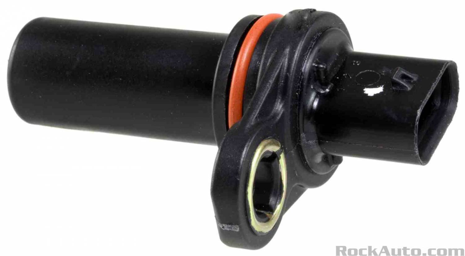

John/Horace Posted July 10 Report Share Posted July 10 (edited) Could be a coincidence that cps died at the same time battery did. If car has more than 100k on it, I would buy an oem cranks sensor and swap it out, there is a code for it. Inspect wires going to sensor for visible damage. Engine won't start without good crank position sensor signal. Can't easily trouble shoot the $30 ish easy to change sensor. It's not parts canon if you have a constant code. Use mopar or NTK who make the mopar part, rumour has it. https://www.rockauto.com/en/catalog/dodge,2019,journey,2.4l+l4,3443654,ignition,crankshaft+position+sensor,7196 Edited July 10 by John/Horace DodgeBruhBoy 1 Quote Link to comment Share on other sites More sharing options...
DodgeBruhBoy Posted July 10 Author Report Share Posted July 10 1 hour ago, John/Horace said: Could be a coincidence that cps died at the same time battery did. If car has more than 100k on it, I would buy an oem cranks sensor and swap it out, there is a code for it. Inspect wires going to sensor for visible damage. Engine won't start without good crank position sensor signal. Can't easily trouble shoot the $30 ish easy to change sensor. It's not parts canon if you have a constant code. Use mopar or NTK who make the mopar part, rumour has it. https://www.rockauto.com/en/catalog/dodge,2019,journey,2.4l+l4,3443654,ignition,crankshaft+position+sensor,7196 Thank you very much, I ordered the parts from RockAuto and will replace it. Any idea on why the system low voltage code is still popping up? The new battery was checked prior to installing, and is good. Would that prevent the car from starting as well? Quote Link to comment Share on other sites More sharing options...

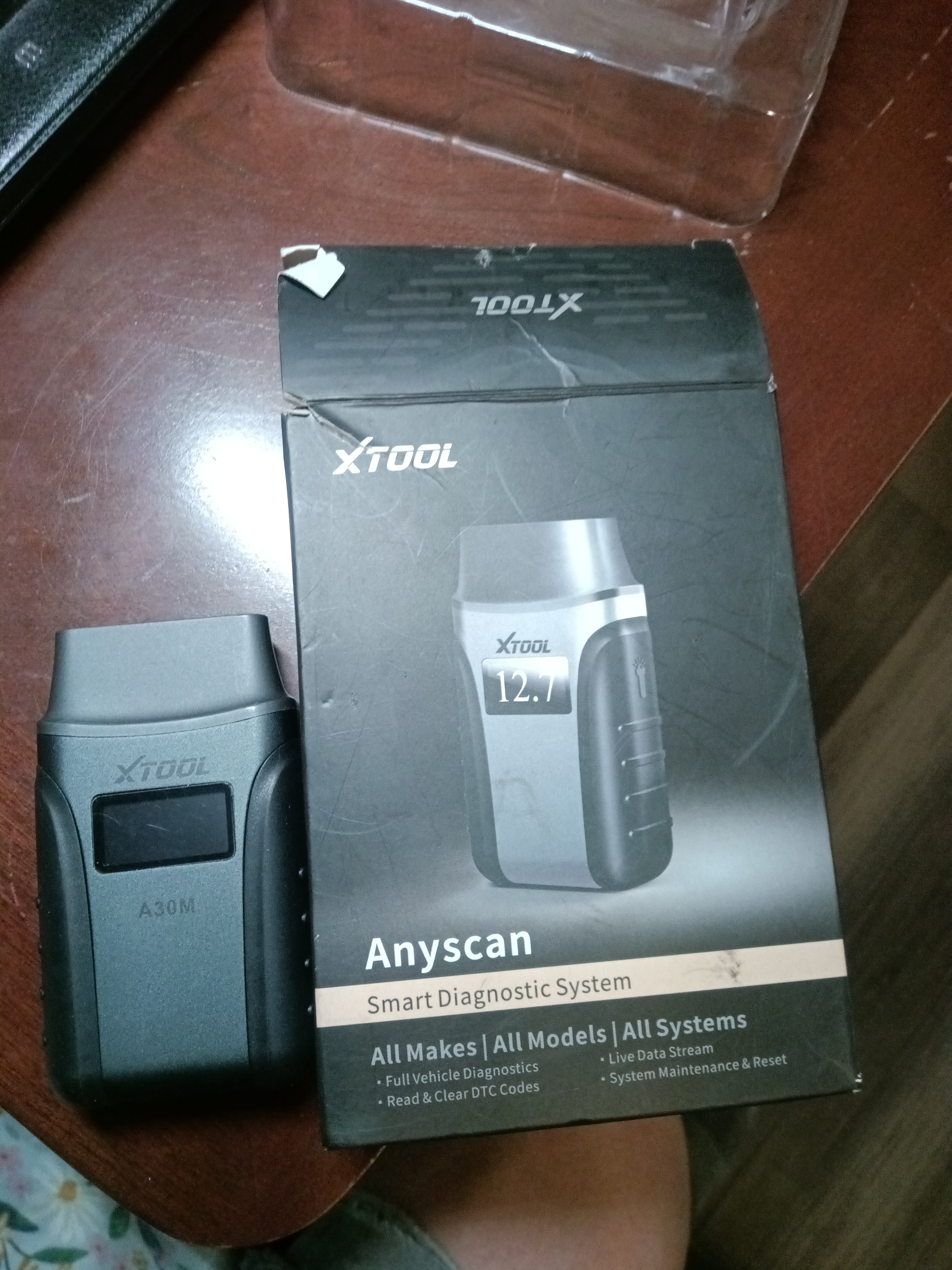

John/Horace Posted July 18 Report Share Posted July 18 (edited) I like Xtool Anyscan A30M , lifetime updates and works with phone app you download. Has worked on at least 6 different brand vehicles for me. Even newer Stellantis with FCauth set up; no pig tail extra harness needed. Some bi directional features, depends on model of car. Can program a lot of sensors, was a cyber friday deal for $180 reg $300 cdn pesos. No remote programming feature. On some older vehicles cps sensor doesn't have to be programmed. Just plug and play. Edited July 18 by John/Horace Quote Link to comment Share on other sites More sharing options...
DodgeBruhBoy Posted July 25 Author Report Share Posted July 25 On 7/18/2026 at 10:30 AM, John/Horace said: I like Xtool Anyscan A30M , lifetime updates and works with phone app you download. Has worked on at least 6 different brand vehicles for me. Even newer Stellantis with FCauth set up; no pig tail extra harness needed. Some bi directional features, depends on model of car. Can program a lot of sensors, was a cyber friday deal for $180 reg $300 cdn pesos. No remote programming feature. On some older vehicles cps sensor doesn't have to be programmed. Just plug and play. I ended up getting the XTOOL D6S and it wouldn't clear the codes, or do the relearn (denied it) I ended up opening the valve cover, will post the photos in the next post Quote Link to comment Share on other sites More sharing options...
