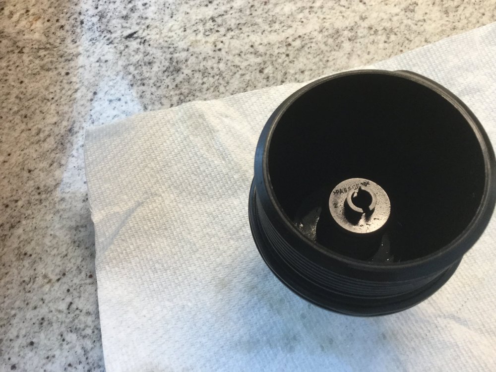

nnngn_zero Posted February 9, 2020 Author Report Share Posted February 9, 2020 Yes, the cap can be found from auto parts stores for +/- $20 However none of them have one in stock. Picture of the piece that separated from (I assume) the oil filter cap attached. Now when I look on the inside of the oil filter cap, I can see a loose spring inside the housing that I believe this piece was connected to. The cap rattled when shaken before re-installation due to the loose spring. It did not do this before. Quote Link to comment Share on other sites More sharing options...

John/Horace Posted February 10, 2020 Report Share Posted February 10, 2020 The newer style lid like in my picture has a small plastic piece held in place by two tabs. The small plastic piece looks identical to what he is holding in his hand. I had to replace my leaking oil cooler last year, the pic is the newer style cap from my 2014. I’m guessing the plastic sometimes gets britttle with age and the constant heat. I think this piece seals opening in top of filter, part of bypass design. Quote Link to comment Share on other sites More sharing options...
