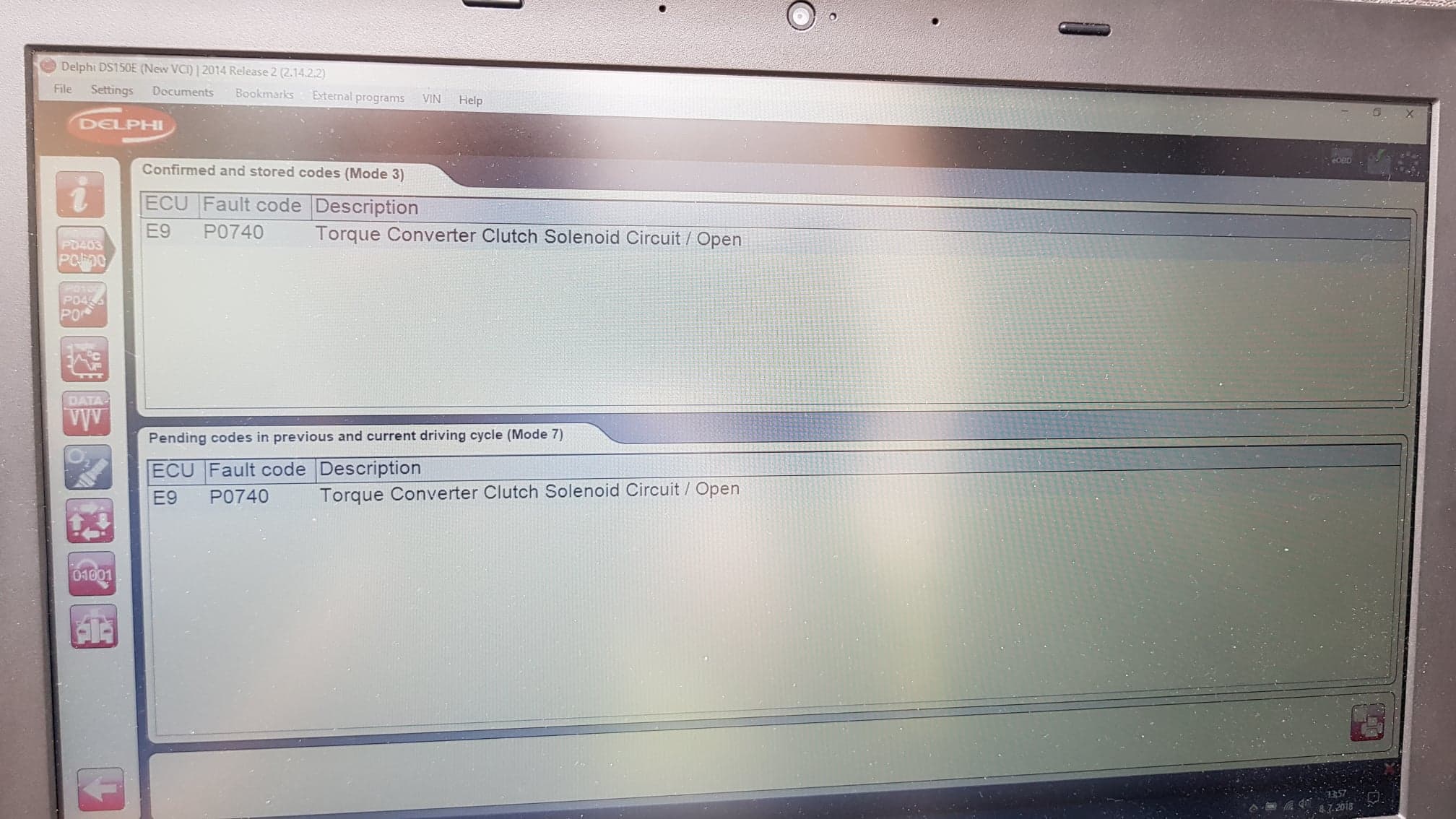

This error represent the following:
P0740 Torque Converter Clutch Circuit Malfunction
The engine and transmission are actually connected by a fluid coupling mechanism inside of the torque converter which is what multiplies the torque until the speeds equalize and create a "stall" speed where the difference in actual engine RPM and transmission input RPM is around 90% efficient. Torque converter clutch (TCC) solenoids commanded by the Powertrain control module/Engine control module (PCM/ECM) or the Transmission control module (TCM) to direct hydraulic fluid and engage the torque converter clutch to create a solid coupling and increase efficiency. The transmission control module has detected a fault with the circuit that operates the torque converter clutch solenoid.
Causes of this DTC may include: Wiring harness to transmission damaged, loose connection, open or shorted circuit Torque converter clutch (TCC) solenoid Transmission control module (TCM)

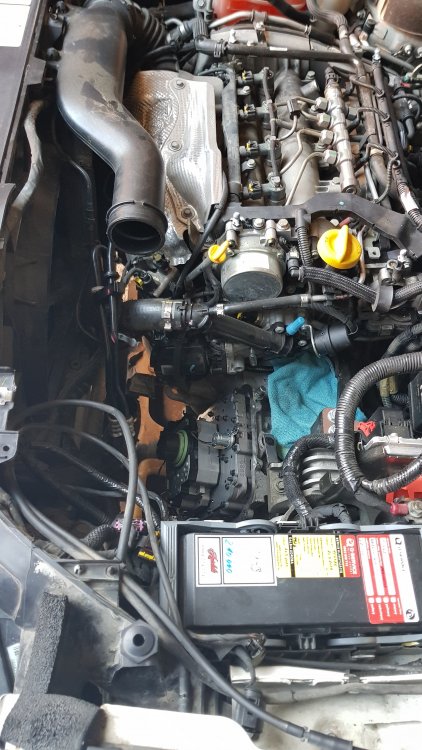

   I recently had this code show up on our '14 62te equipped DJ. I knew it was a torque converter going bad and had my friend seek {give his advice} and he said solenoid and fluid/filter change to see if it would fix. Was against my preference, but as the trans has to be removed for a torque converter {a rather pricey job}, we tried his way first....NO LUCK! So at my reasonable charges , had him pull out the trans and install a new torque converter for a total cost of $1,100. Then to finish things off, another $100 for rear upper control arms.
    There are plenty of youtube videos about this code and what to do.
ALL working FINE now
