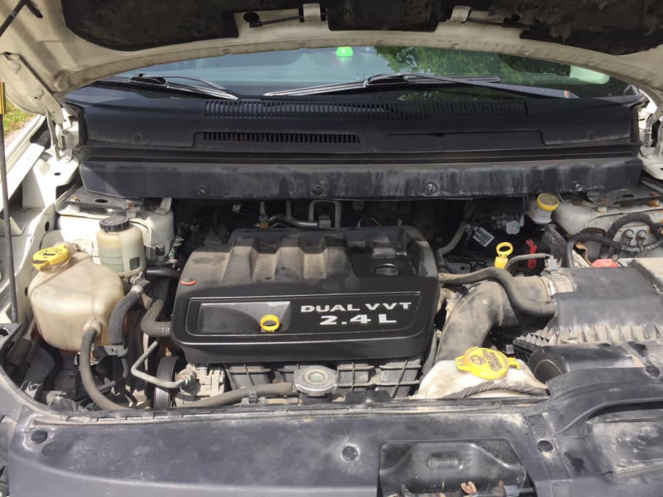

Hey,
Back again with more problems and $0 to throw at a mechanic.
  I was told that I should have a coolant flush done, and it's also recommended in my maintenance book. However, I'm hearing conflicting answers.
I'm having a whole bunch of problem, which I'm not sure if it's related to not having this done.
I have 122,000km and this procedure has never been done before. I have to top off the coolant about once a year ( 8oz or so ), but see a "grit" or sediment at the bottom of the reservoir. Should this flush be done?
Is it difficult?
From the youtube vids, it seems fairly straightforward. My reservoir isn't pressurized, and I have the cap for my rad.
Would A/C issues have anything to do with this being neglected?
Thanks
