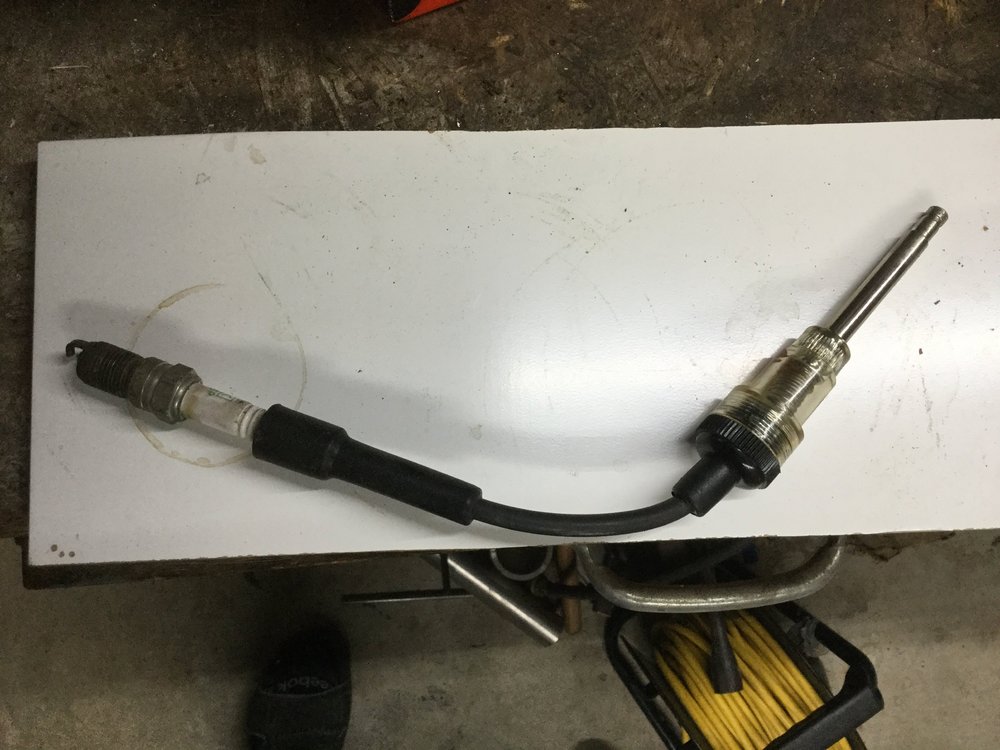

John/Horace Posted June 14, 2020 Report Share Posted June 14, 2020 Or use a spark plug tester. It goes in line with installed plug and coil, flashes light when it gets high voltage signal. Harbour Freight/Princess Auto sells them, not expensive. Less risk of shocking the monkey ? Quote Link to comment Share on other sites More sharing options...
