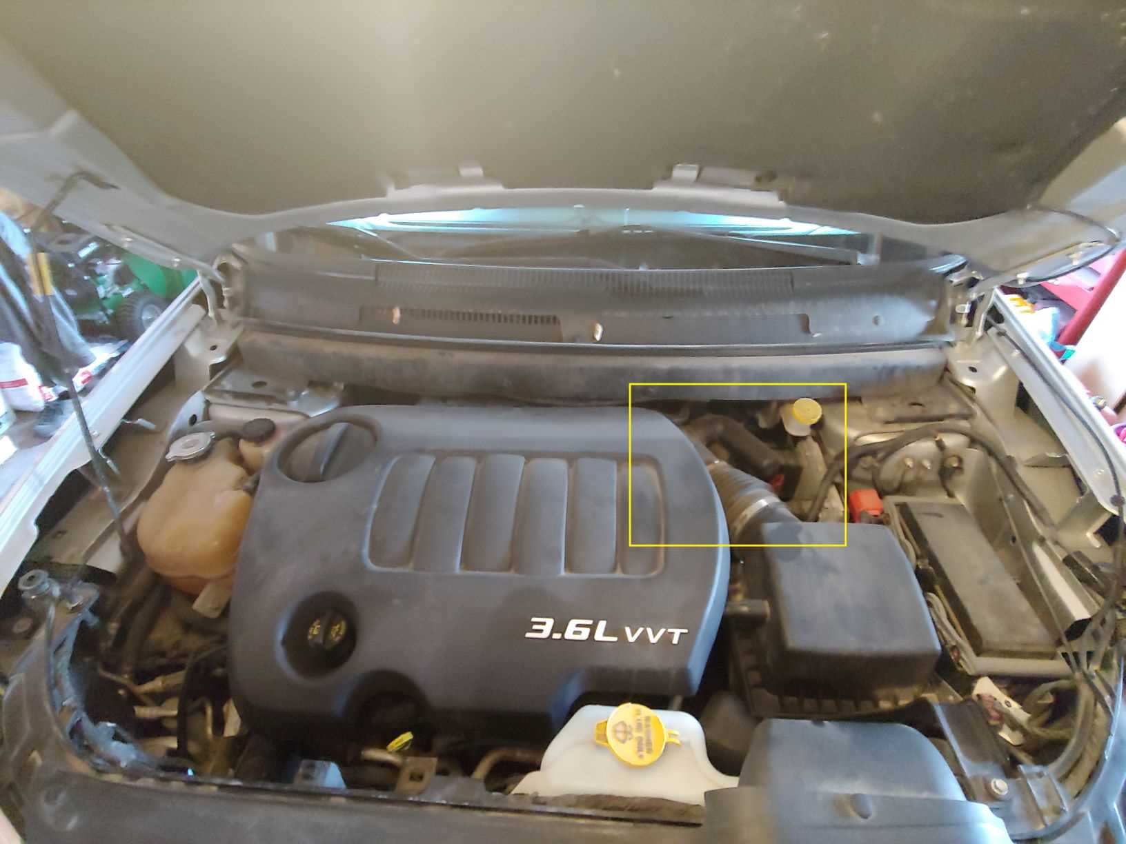

John/Horace Posted May 1, 2020 Report Share Posted May 1, 2020 One section of intake manifold needs to be removed that is close to back of engine compartment. You will then see vent hose. Won’t show up on engine compartment pics that I’ve seen. TopperHarley 1 Quote Link to comment Share on other sites More sharing options...
John/Horace Posted May 1, 2020 Report Share Posted May 1, 2020 It’s air intake throttle body with plastic shroud leading to air filter. Little finicky with all plastic parts. TopperHarley 1 Quote Link to comment Share on other sites More sharing options...
snosrap Posted May 2, 2020 Report Share Posted May 2, 2020 ok thanks i will take that part off and look again will let you know if I find and do the job.. I'll try and take a pic if I can with it off TopperHarley 1 Quote Link to comment Share on other sites More sharing options...

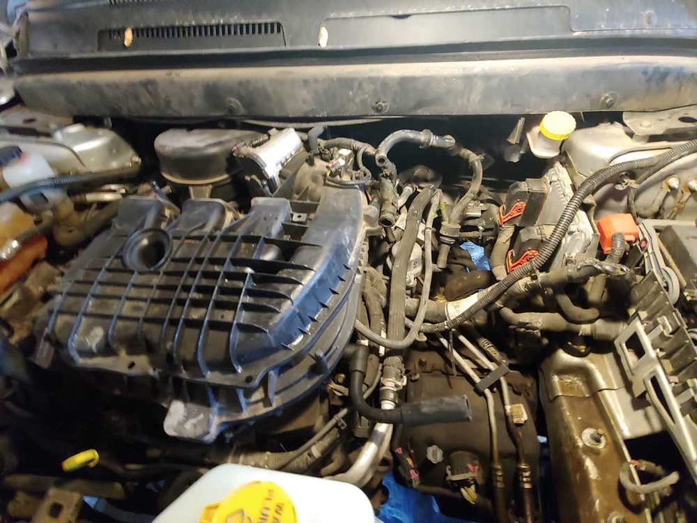

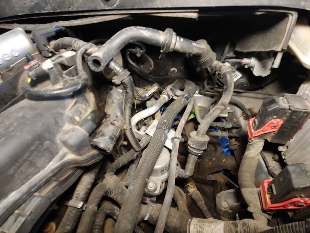

snosrap Posted May 2, 2020 Report Share Posted May 2, 2020 (edited) As shown in picture one the yellow box highlighted is part to be removed. Step 1 remove engine cover, air fliter cover, air filter and air filter box then have to remove next piece of intake which is held by a hose clamp once removed should look like picture 2 As shown in picture 3 with the yellow circle the green cap is the vent tube. Remove cap I found easiest to remove vent tube from metal bracket used a flat screwdriver. Found easier that way then remove cap from tube, again had to use a flat screwdriver to losen hose from cap. Also you may notice that 2 rubber hoses were disconnected I thought I had to remove more but was not needed. As shown in pic 4 is the syringe style transfer pump. Has a max capacity of 200mL ( in Canada) I then added 4 full tube with a total of 800ml of fluid but in the process I would pump about 50 mil then remove syringe to burp air so pressure dont build. Do this until all 800 ml is added and re install parts. Found best to put car on ramps first and made sure I could remove vent cap before draining. My fluid was really dirty im sure it was original with 185km on the car. Edited May 2, 2020 by snosrap added more info mike35z and TopperHarley 2 Quote Link to comment Share on other sites More sharing options...
snosrap Posted May 2, 2020 Report Share Posted May 2, 2020 forgot to say after remove air box and filter have to remove next piece of intake which is held by a hose clamp TopperHarley 1 Quote Link to comment Share on other sites More sharing options...

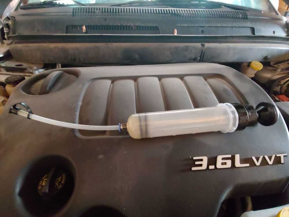

mike35z Posted May 9, 2020 Report Share Posted May 9, 2020 Thanks to the great information for changing the PTU fluid. I was under my Journey a couple times trying to figure out how to drain and fill the fluid. Went to Valvoline oil change and they told me they could not service the PTU. They did change the rear axle fluid. The dealer here in Ohio wants 160.00 to change the PTU fluid which seems a bit high to me. I think I can do it myself utilizing the vent tube as shown. Thank you so much for posting the pics here. It looks like the lower drain hex head is not too bad to get too. I was so glad to see a very clever person figured out how to fill this fluid much easier then the recommended procedure. I would not be surprised if some Dodge dealers actually use the vent tube method since it is considerably easier to get to then the location of the PTU fill plug. Thanks to John/Horace, and snosrap for posting the procedure, and taking photos. Quote Link to comment Share on other sites More sharing options...
mike35z Posted June 7, 2020 Report Share Posted June 7, 2020 I am updating the post I made regarding the PTU oil change. It was easy to drain the fluid from the drain plug. The heat shield was overlapping the drain plug by about 1/4 inch. It was easy to bend back the heat shield to drain the oil. I used the vent tube to fill the PTU. The green cap is easily removed by using a small screwdriver to pull it out of the rubber vent hose. I used the hand pump as shown in the previous post. It took some time. After every 30 to 50 ml of oil it would bubble up out of the tube. I assume the air pressure needs to equalize inside the PTU gear box. I put rags around the vent tube to help soak up the oil that bubbled up. It took about an hour to fill the fluid. Need to go very slow with it. This method works but you need to take your time. My Dodge Journey is a 2013 with 120,000 miles. The oil was never changed in the PTU by the previous owner. The gear oil drained was black. It had a slight smell to it. It is recommend to change this oil at 60,000 miles. I am very happy i got it changed using this method. I Am going to change it again since the drained oil was so dark. Will probably do it before Winter. Hope this post helps anyone that wants to change their PTU oil. John/Horace 1 Quote Link to comment Share on other sites More sharing options...
