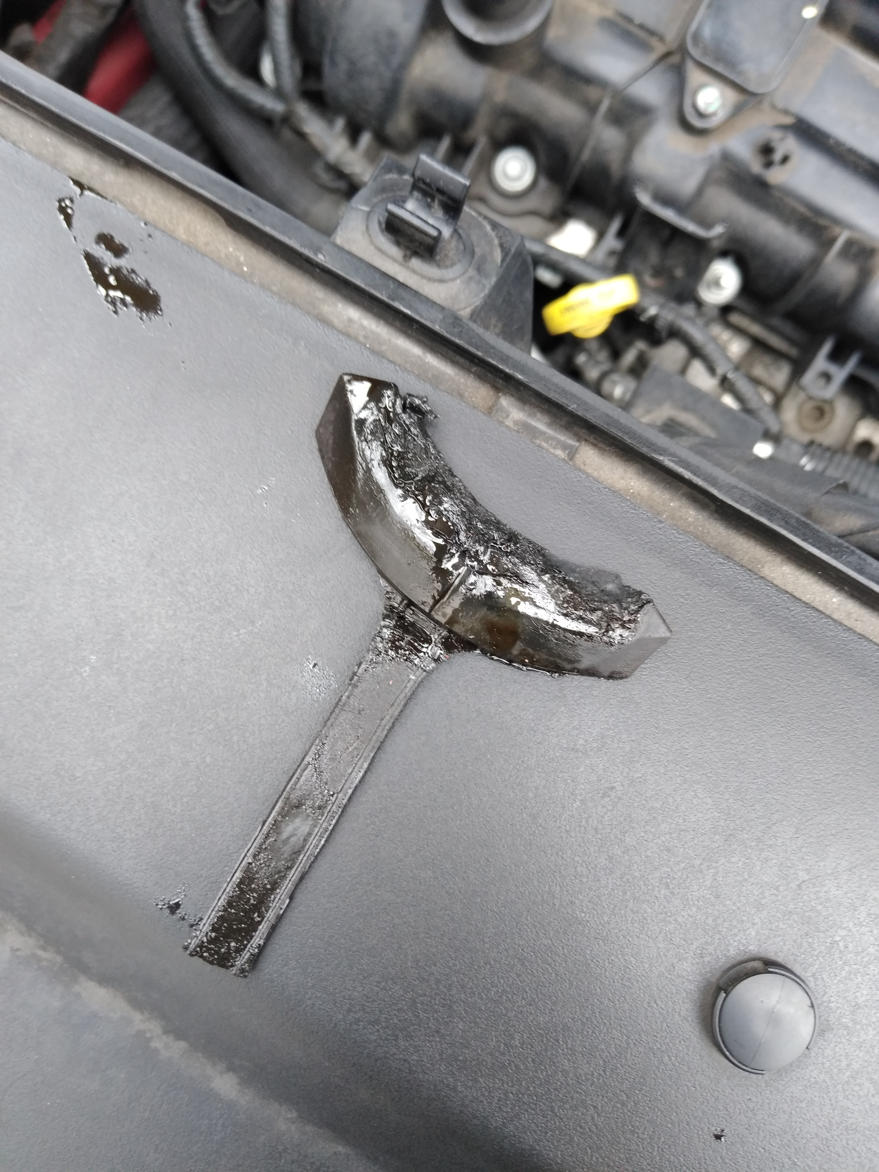

DizzyR/T Posted January 8, 2019 Report Share Posted January 8, 2019 (edited) Edited January 8, 2019 by DizzyR/T Ok so I had a ticking noise fix that ended up being the rocker arm on the back side where the pcv valve is. Now I been having issues with the gasket leaking a very slight bit of oil. However now I just have a bunch of oil leaking and can't find the source Quote Link to comment Share on other sites More sharing options...

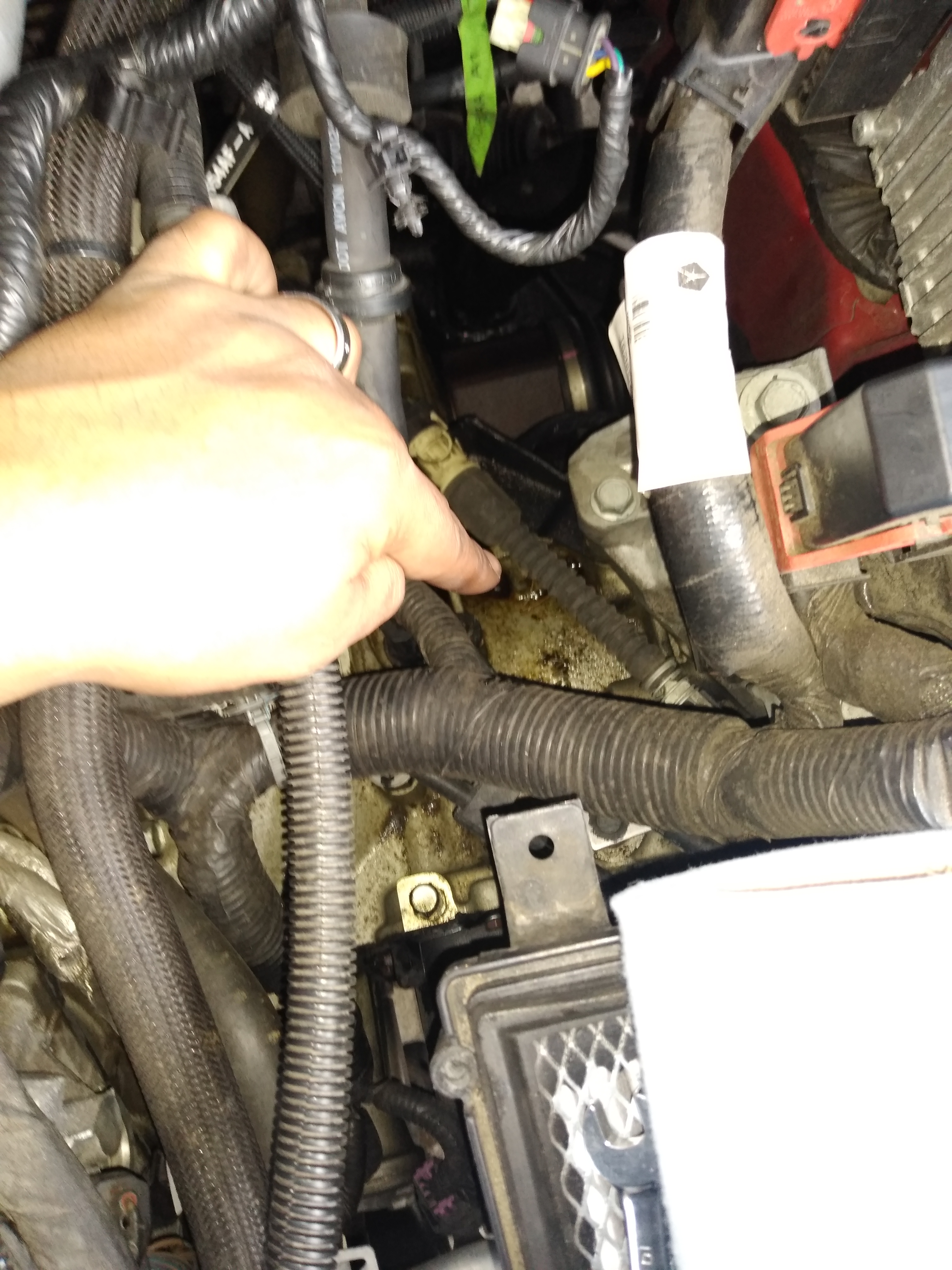

DizzyR/T Posted January 8, 2019 Author Report Share Posted January 8, 2019 I do not see any leak or moisture around the valve covers at all. Now I am using the mobile one annual filter but I swap it out during regular oil changes I can't seem to figure it out. Now I found that rubber piece just hanging out on top of the box where my finger is pointed. Sorry for not knowing all the part names bare with me. Quote Link to comment Share on other sites More sharing options...
2late4u Posted January 8, 2019 Report Share Posted January 8, 2019 what about important info like yr, engine size, how much oil do you see missing between oil changes , or is it just enough to see and makes you worried , top picture opposite of your finger, is their a hose missing from the black pipe connector? Quote Link to comment Share on other sites More sharing options...
larryl Posted January 8, 2019 Report Share Posted January 8, 2019 It looks like you have knocked the tube off that goes from the air filter box to the intake which is part of the pcv egr system...that oil residue usually goes into the bottom of the air filter box 2late4u 1 Quote Link to comment Share on other sites More sharing options...
DizzyR/T Posted January 9, 2019 Author Report Share Posted January 9, 2019 4 hours ago, 2late4u said: what about important info like yr, engine size, how much oil do you see missing between oil changes , or is it just enough to see and makes you worried , top picture opposite of your finger, is their a hose missing from the black pipe connector? 2016 Dodge journey rt 3.6L fwd. I'll have less than a quart between oil changes. But as of lately I'll notice oil drips not a whole lot but enough for me to raise concern(any bit of oil for that matter make me worry) I've added oil when I have noticed I was still in the safe zone on the dip stick but at the bottom put enough to bring it past the half way mark on the dipstick. The hose was taken off so I can get better pictures of the spots where oil is at. Another weird piece of info. I have a scanner my mil light came on for evap purge. But light went off on it's own. I scan it and it shows up as historical fault. Tried clearing it to see what hapoens, you know maybe it will repeat itself and it will not clear off. No mil light just shows when scanner is on. Quote Link to comment Share on other sites More sharing options...
2late4u Posted January 9, 2019 Report Share Posted January 9, 2019 i would do like jkeaton said and clean the whole engine compartment down at the local car wash bay and then make sure every thing is clean and then keep check on the nest oil spot you see happening , check it every time before driving and right after driving it you find the leak sooner or later i guarantee . good luck jkeaton 1 Quote Link to comment Share on other sites More sharing options...
DizzyR/T Posted January 9, 2019 Author Report Share Posted January 9, 2019 I'm just wondering if that random piece of rubber goes to the motor mounts or strut tower and it just has oil on it from where ever it maybe coming from. It a big piece of rubber I'd probably would have no oil if that piece went to something holding oil in. Again thanks in advance for you your guys in put truly helpful community. Quote Link to comment Share on other sites More sharing options...
2late4u Posted January 9, 2019 Report Share Posted January 9, 2019 your guess is as good as we can guess from your pictures.maybe your trans cover is leaking a bit jkeaton 1 Quote Link to comment Share on other sites More sharing options...
