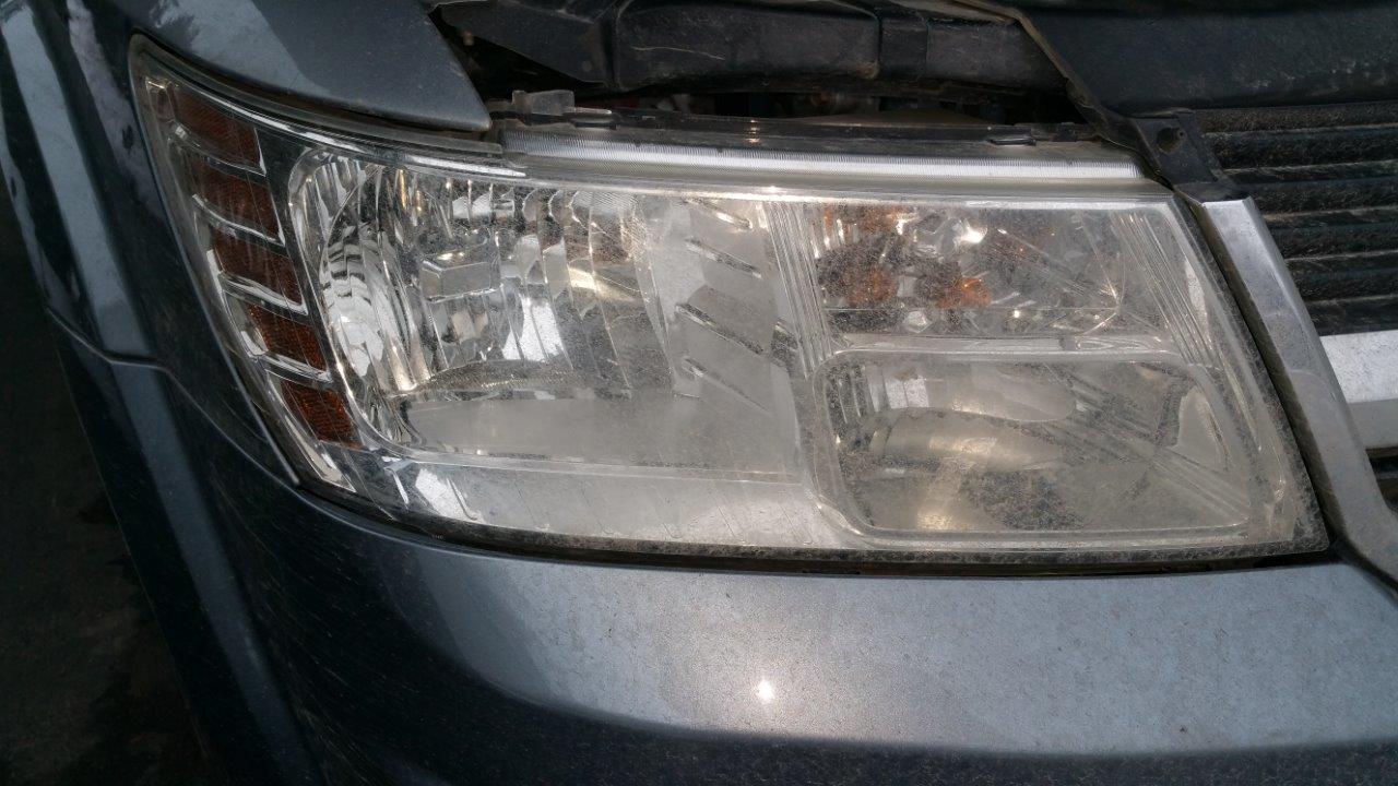

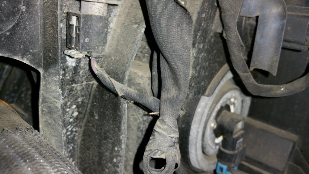

Bob Stratton Posted December 13, 2018 Report Share Posted December 13, 2018 Question re: aiming headlights. I have googled how to aim the headlights on my 2010 Dodge Journey. My low beams seem to be too low - i.e. focused too close to the vehicle. High beams are OK. I've found two very different descriptions and pictures of the adjusting screws one needs to use to aim them. Bigger problem is that neither of those even remotely resembles the headlights in my vehicle. It appears to me (and I could easily be wrong) that the whole headlight cluster is one sealed unit and there's no sign (that I can see) of anything resembling adjusting screws. I've attached a few photos of the outside and the back of the headlight assembly. Hopefully they're clear enough to see what I'm talking about. Quote Link to comment Share on other sites More sharing options...
2late4u Posted December 14, 2018 Report Share Posted December 14, 2018 only adj i know is on the top side of the light , that looks light an electrical connector not an adj.to get them adj right take it to your local garage... Quote Link to comment Share on other sites More sharing options...
2late4u Posted December 14, 2018 Report Share Posted December 14, 2018 found this in the forum ......Turned out to be easier than I was hoping. The passenger light was still factory aimed, so it was a good reference point. When I parked it in my driveway, it lined up perfectly with a panel on the garage door. There is a 12mm bolt head on the back side of each headlight assembly. A 1/4" drive socket fits in perfectly. Quote Link to comment Share on other sites More sharing options...

2late4u Posted December 14, 2018 Report Share Posted December 14, 2018 i actually found that quote in the forum listed under glass and lighting. that said i went and looked last night at my 2014 and could not see anything that might adjust the lights except there was a Phillips head screw in a bigger nut around the middle of the light about 5 inches down from the top.. just go by your local dealership they should be able to point out the adj points to you . good luck Quote Link to comment Share on other sites More sharing options...

Bob Stratton Posted December 14, 2018 Author Report Share Posted December 14, 2018 OK, with the help of you guys here, I have found the adjuster and as you said it just looks like a Philips bolt screwed into a strange washer. Now, to save trial and error, would any of you happen to know which direction to turn the bolt to raise/lower the headlights? I realize I could just turn it and see but it would save experimenting if someone here knows already. Thanks, again. Quote Link to comment Share on other sites More sharing options...
tjboston5676 Posted December 16, 2018 Report Share Posted December 16, 2018 clockwise up counter clockwise down Quote Link to comment Share on other sites More sharing options...
