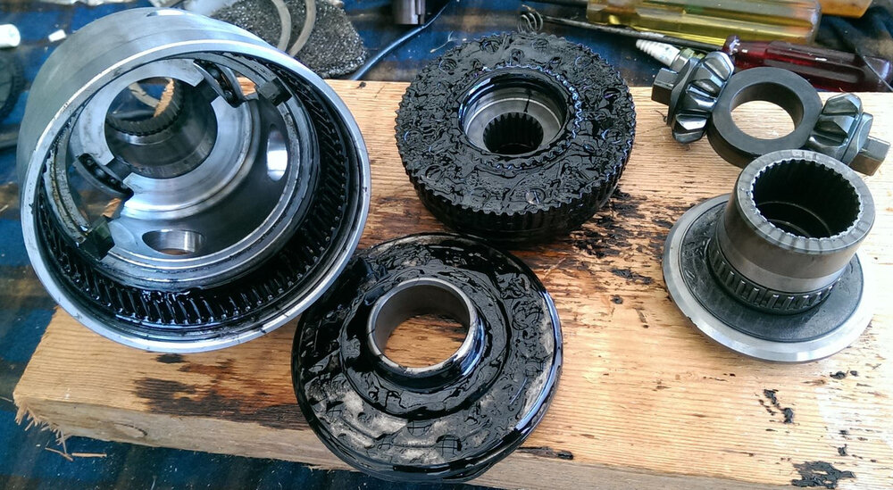

People get stuck and get carried away, burn up the silicon/oil.  Clutch plates get damaged and seals start leaking.
Subaru forums say it’s usually  1,000,000 (cst) PolyDimethylSiloxane fluid in most vc diffs.  Not much fluid 50-80 ml maybe,  measure accurately what comes out if possible. Could be half black paste and not meaureable. Getting Mopar fluid would help odds of successful fix.  Pic is of a Subaru vc .
Fluid should last life of vehicle I think; if not abused.  My 3 vc vehicles have never needed it changed. Although Jeep np249 transfer case was causing hopping at 200k miles. Needed it.
