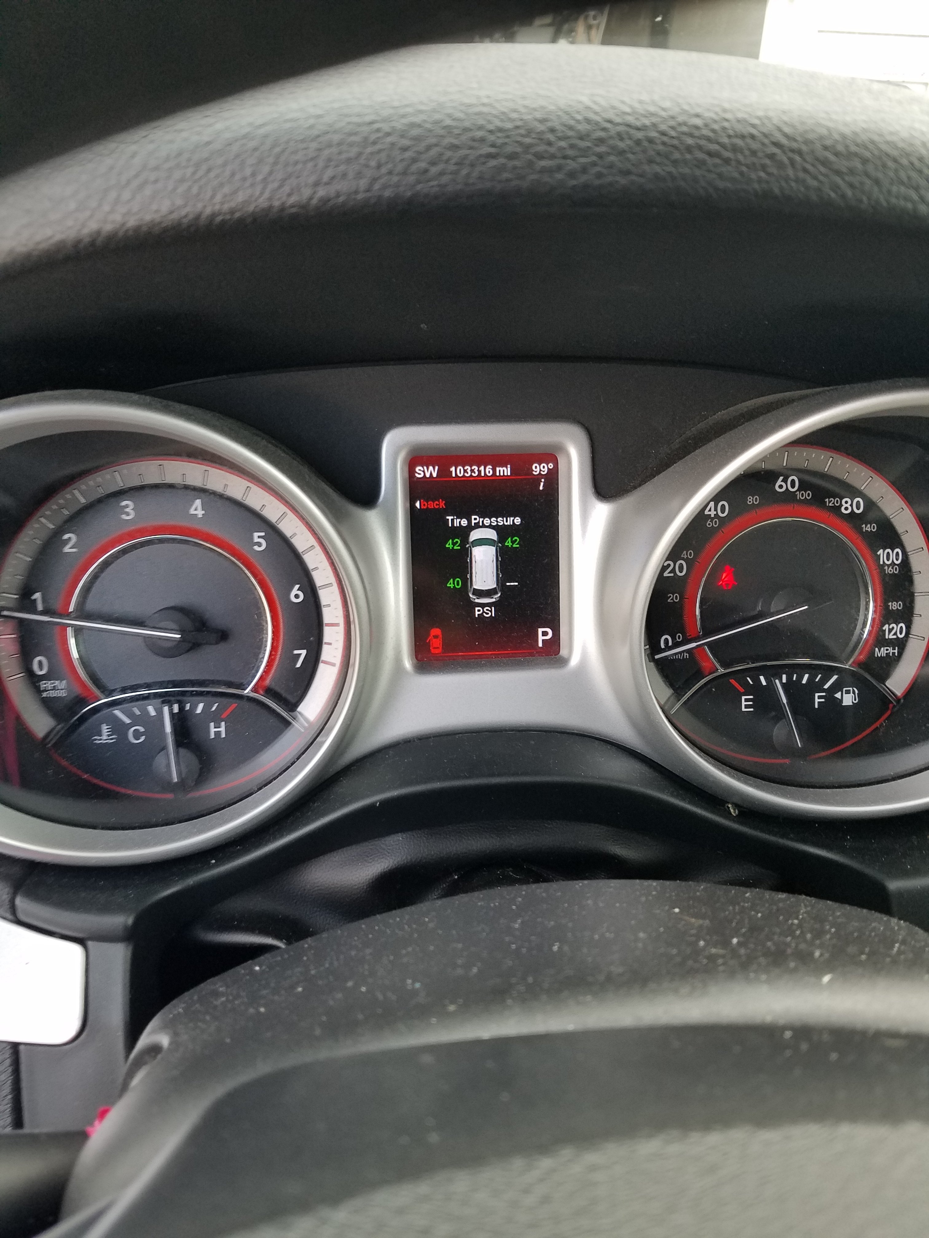

Hello! I'm new to the forum and there's a lot of good information in this site, a lot to read and very good answers. I did run into a problem with my 2011 Dodge Journey. When  I start driving it both my rear tires show zero or (--), a few minutes later the back rear one will show pressure. I thought it was the sensors so I opted to wait a bit to change it out. I had the tires balanced and rotated yesterday and to my surprise, the same thing is happening. I thought the problem sensors would now give issues on the front since that's where they're at now, but in fact it's the rear still showing the exact same issue. Any help resolving this would be greatly appreciated!! Thank you.
The system works with three antennas and the sensor that is closest (strongest) to a particular antenna is assigned to the wheel in question.  Once all three have been determined, the fourth becomes obvious.

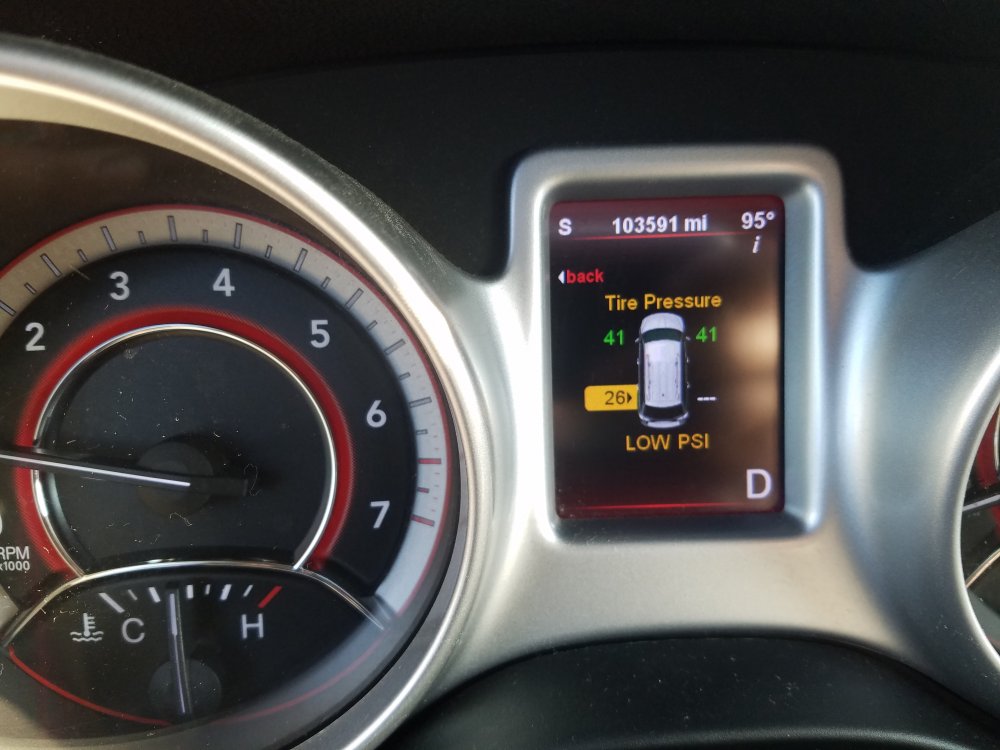

What a great Forum! I just got a '11 model that's doing quite similar. The RR wheel pressure goes all over the scale from proper 36(+ or -1 psi)cold to 84 psi and while driving down to 24 and the "flag" and warning popping on.  I thought possible wheel sensor, but will now investigate the module, and I have access to a couple of them to try. even have access to an advanced scanner that can work with the system...at no cost! Nice having a few connections from my past auto tech career yet!
  If the module isn't the prob, then I'll have the sensor replaced when my "contact friend" replenishes his stock of sensors as he's just run out of them from other sales and is waiting on parts shipment to come in!
Edited by 5rebel9
Well I got the car away from my son long enough to do so "checking" this morning.
  Checked TP with my gauge and noticed was hard to get a reading, so pulled the core and noted the press. drop on the message center but not go to drop out dashes. Installed a new core and noted that air went in much easier, set to 36psi and went on a new road test of 20 miles at 55mph speeds. Message center still showing RR reading all over the scale but not to the point of low press warning flag or going to the dreaded dash drop out. Came back and swapped the RR and RF positions and road tested the same route, RF reading fine, but the RR(was RF) still showing the same read outs on the message center.
    At this point, I believe it is the TPMS module, and have contacted my friend to see about pulling one out of one of his parts journey's and giving that a try. We'll make the swap at his place(where his lifts will make the job much easier to do). We got this Journey thru him and he wants all things right on it, but I feel this is not his fault and will compensate him accordingly. This is the first time I've seen such a problem with TPMS systems. I've heard about it with other vehicles but never to me.
Yeah, I just wanted to be absolutely sure and not waste money on an unneeded part. and my friend just got restocked with new sensors yesterday(finally). So  sometime in the next few days will be able to have him change out the sensor.
   Otherwise this is looking to be a great ride in the family...I'm beginning to get jealous driving my 200k+ 04 T&C! But I know the Journey can't pull the 3 face cord of firewood load that my T&C can.

52 minutes ago, 5rebel9 said:
Thanks for posting such an excellent diagnosis guide on the subject(both of your postings)!  :)
  In my case the sensor does not drop out completely and correct readings happen when a good reading tire was moved to that RR location and crazy reader went to the formers position. I feel that perhaps the sensor in the rim of the offending wheel was damaged during a tire replacement or the "circuit board" in it is malfunctioning. I will report findings once I get it replaced.
   BUT your postings ARE of GREAT VALUE!    :)
IF they tpms is the original from the factory then it is 9 yrs old the battery is going bad in it most likely
 YES, well aware of the "age factor", having just recently gotten the vehicle and not speaking with the past owner (in Maryland) to know when the issue started leaves the question of just what caused the "failure". As the sensor does NOT go entirely dead, just goes from low reading to extremely high numbers and everywhere in between when driving the car. Who knows, there may have even been "fix a flat" used in the tire/wheel at some point that affected that sensor....tires look like new and why I posted as such previously.
    My friend is very busy right now and I'll have to wait a bit till he has the time to to the task. I still rue the day that I sold off my tire changer and balancer!!
