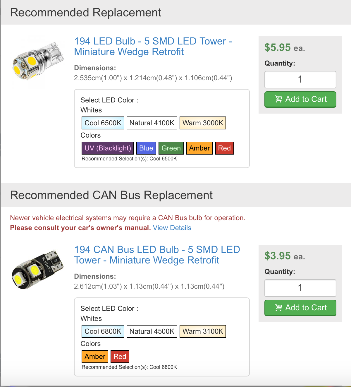

Hi folks,
I was looking at superbrightled.com at the led bulbs for my license light bulb. I came at a step, where i have to choose between normal led bulbs, and can bus led bulbs... I dont know which one i should choose. The reason i am changing i bought some cheap led on eBay and they started to flicker. It bothers me, and i hate the yellowish light of the bulbs since all my car is factory equipped with led inside.
Another question, for the trunk light, they're also yellowish. I want to buy led. When i opened the cover, they were dome light shaped (212-2), and superbrightled are saying they're 579... Please help me here too.
Thanks, i appreciate it.

Well, if you opened the cover for the cargo light and saw a 212-2, which is what is in my 09, get that type (a festoon I believe).  On a 2016 I would go Canbus
mfeel likes this
So canbus will work, right?
It should the newer the car the more need for can bus
Thanks.
I also wanted to change the front turning signal light to led, but theres no can bus  available. Can i take non can bus?
It work, i replaced on mine 2016,  with regular 194, no issue.
mfeel likes this
Youll need load resisters or you will get a rapid flash
mfeel likes this

As stated, you will need resistors to make led turns work.  I run regular non-canbus LED's in my 2013 interior and license plate. No issues.

I changed my rear turn signal for red LED, did not add load resistor and they work just fine. The first time I started the car after installing them it said that my light was burned but I left my turn signal on for about 30sec and everything went back to normal. It's been 6months and they only did that once while driving since then. And I used some cheap LED bulb bought on eBay.

Maybe because the back lights are already LED? But for the front im more than sure that we need resistors.
Always go with canbus LED, no need for resistors. the cargo lights on the trunk are festoon.
