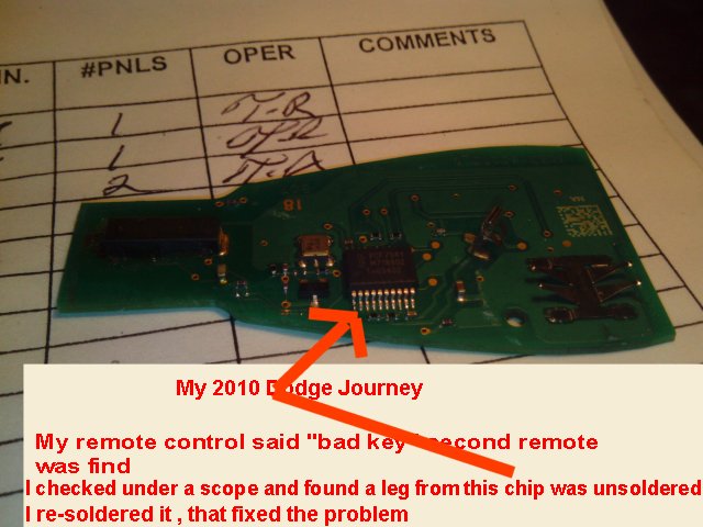

My 2010 Dodge journey started saying "badkey" then I used second remote and it worked find, put first key in and said "badkey" again, then I knew that the key was bad. I opened it up and I went under a scope and inspected it and I found one of a chip leg was unsoldered, I soldered it, tried it, then the key starting working, no more saying "badkey". problem solved. :hyper::yahoo::rockon:
Take a look at the picture so you'll see what the chip looks like
same thing happened to my tv worked fine for almost 5 yrs then started messing up just by luck they gave me a 5yr warranty so they came got the tv and couldn't find any thing wrong except they said they found a I C leg not soldered and 8yrs later tv still going strong.... thats the problem with surface mount parts as sometimes the solder doesn't melt and adhere the part to the circuit board properly......
