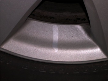

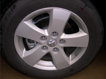

"04redmach1" was complaining of excessive brake dust. His Journey was purchased within a week or two of mine. I currently have ~1000 miles on mine and this is what the rims look like. They have yet to be washed. I ran my finger across it so you can see how dirty it is. Is this brake dust excessive? I think it's acceptable, especially seeing how the rest of the car is pretty filthy right now, but I'll let others correct me if I'm wrong.
Mine is a little worse but not much. Thing is, with ALL of the cars I have owned I have NEVER had brake dust that noticable. Even in my Mach 1 when power braking it at the drag strip or on the streets. Very cheap soft material pads.
I'm going to wash the car this weekend and see if it is just a break in on the pads or what. I am OCD about a clean car and this ain't cool.
I can take pics for you if you would like, but honestly ANY brake dust this early is too much.
Nah, don't worry about. You said yours was a little worse than mine and that's enough reference I need. I'll just be keeping my eye on the issue.
In my case it wasn't too noticeable until I ran my finger over it. Like I said, the rest of the car was pretty filthy, too. Yesterday it warmed up to 55° so I took advantage of the weather and washed the car. She's shining in the sun now, once again! B)
