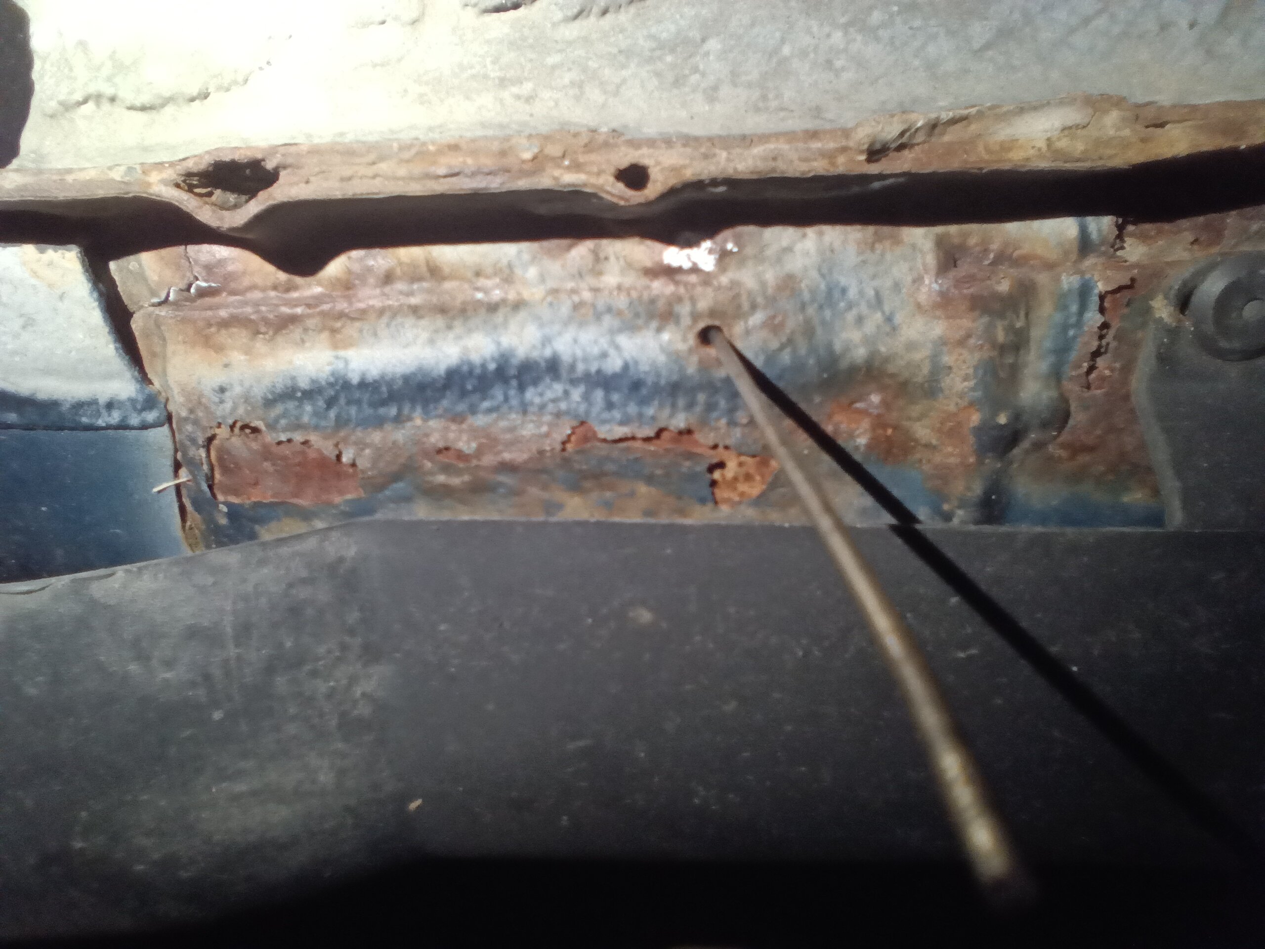

John/Horace Posted May 7, 2025 Report Share Posted May 7, 2025 I get PTSD remembering my passenger side water leak last year that took three runs to fix. Drying out carpet is very time consuming, mold is baaaad. Removing fender liner is pretty important to see all the possible openings that can allow water in. Leave it off for awhile. There are drainage holes underneath the car below the driver footwell (a hose will send enough water to make them run). Most of my leak was solved with a piece of wire poking open the three drain holes. I even drilled two more 1.8" dia holes which then only left a frustrating few table spoons from a rain storm. Still enough for mold how ever. Pulling carpet back also helpful. Left it propped up with small junks of wood during the two week battle. Half a tube of black marine polyurethane stopped the last tiny leak from the channel underneath door sill. Poked out the yellow foam, acetone for clean surface adhesion of urethane. Don't buy gold fish, If you are stubborn...you can fix this. Quote Link to comment Share on other sites More sharing options...

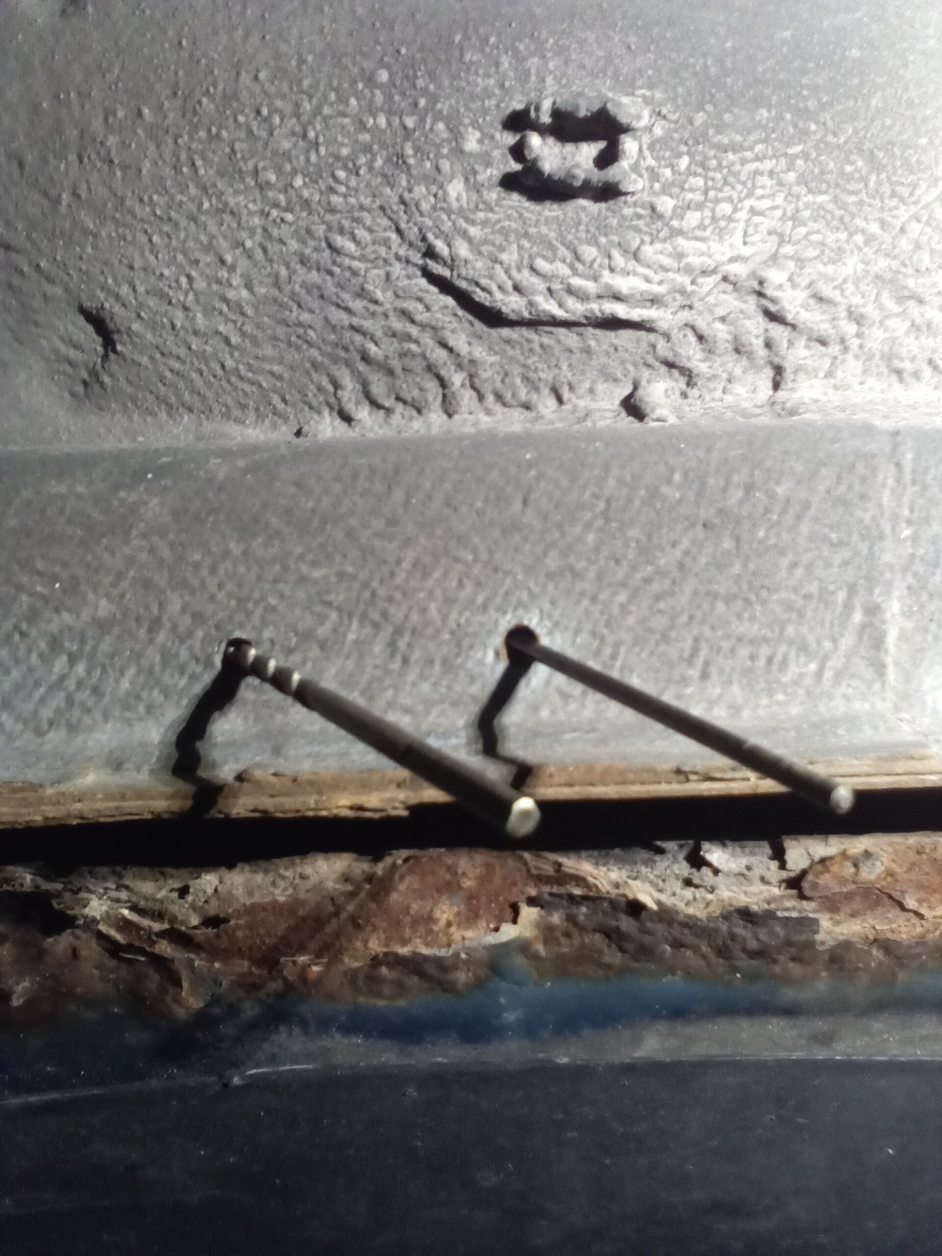

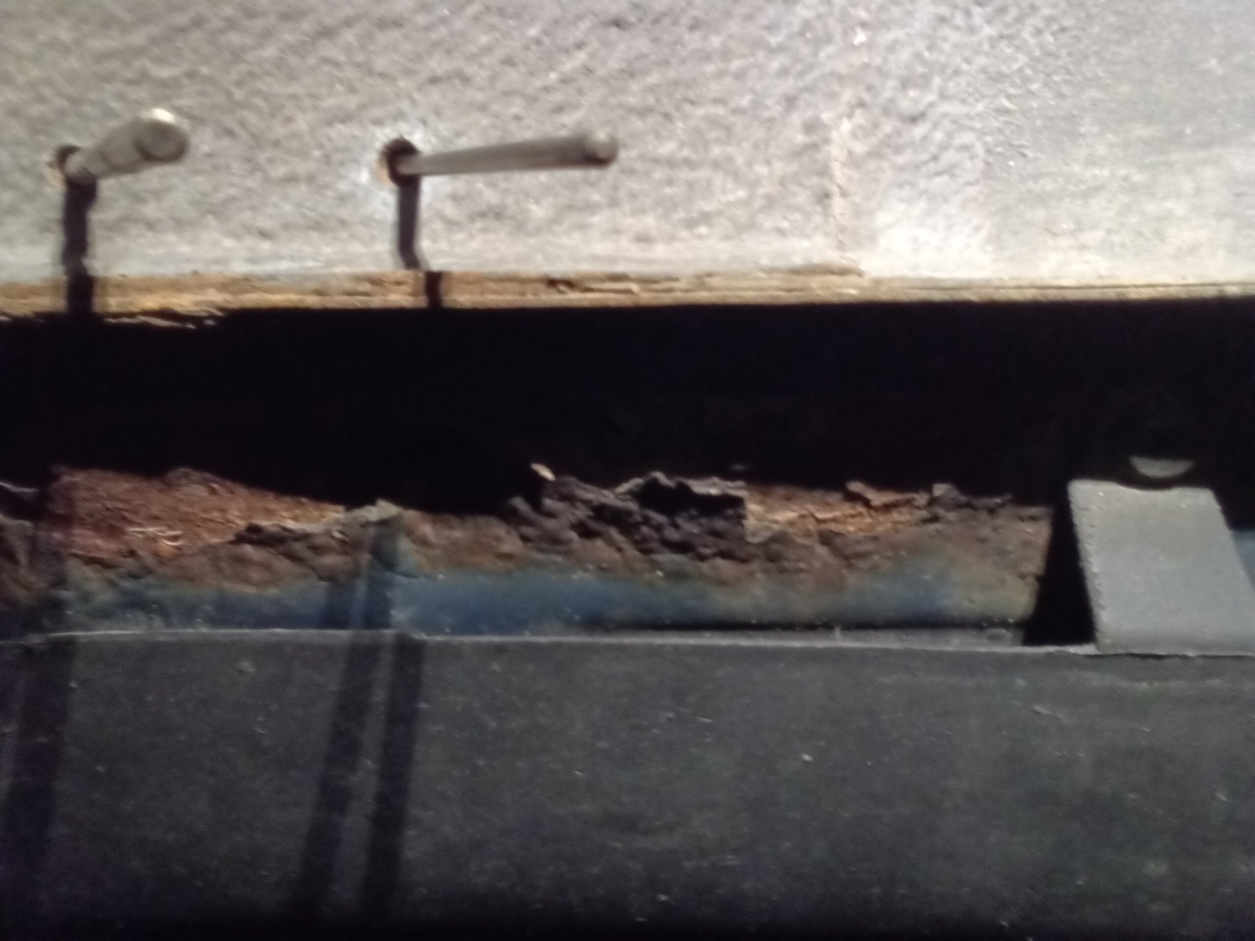

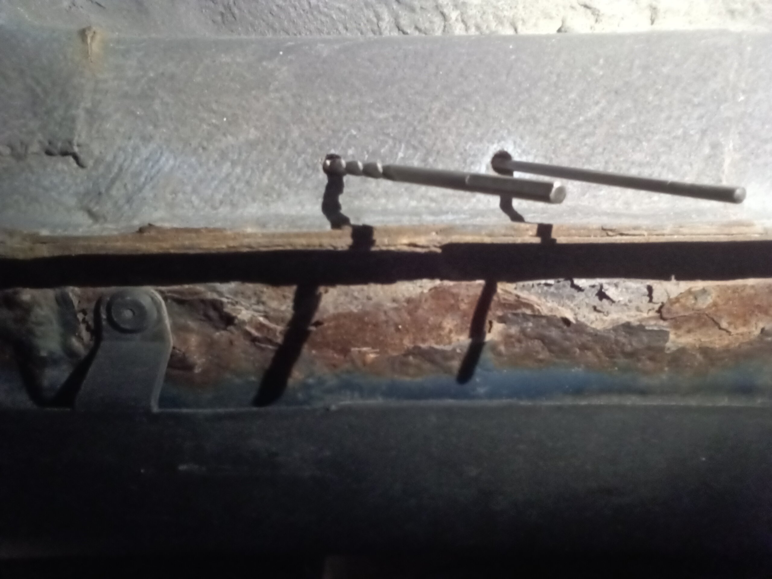

John/Horace Posted May 10, 2025 Report Share Posted May 10, 2025 (edited) My leak was passenger side, but new hole location should be similar, you can see wiring harness under carpet, I stayed away to avoid accidents. I used an extra long drill bit to clear out the factory holes. Two of them had crap in them. Probably flakes or rust, I'm in the rust belt here. This car was undercoated multiple times, the main body above is actually quite good still. The car is designed to be self draining from windshield cowling flow. Water is suppose to flow to drain holes that can handle the volume. When you drill through you hit an empty channel. Not into the carpet and car interior...like some people are thinking. Edited May 10, 2025 by John/Horace Quote Link to comment Share on other sites More sharing options...
John/Horace Posted May 10, 2025 Report Share Posted May 10, 2025 A body shop would remove your driver fender and use a product called seam sealer. Its a polyurethane used when cars are built at the factory. But if the factory drain holes are plugged, still might leak. I just feel the extra holes are a simpler cheaper solution. The fuel lines, brake lines and wire harness have to be avoided, obviously. Have had no leaks in a year now. In a previous life I use to be a bs&f assembler ( bench and structural airframe assembler) for an aircraft company. Use to drill hundreds of holes a day building wings, nasell, floor sections etc. DC9, DC10 and KC10 Air Force tankers. So I have a bit of practice drilling. Nice new sharp hss drill bits needed, small pilot hole first, then open up to bigger sizes. The three added holes are right behind the passenger front wheel, at the start of the channel that runs under the doors. Drains the water before it gets into the foam and leaks around the various anchored clips. Quote Link to comment Share on other sites More sharing options...
