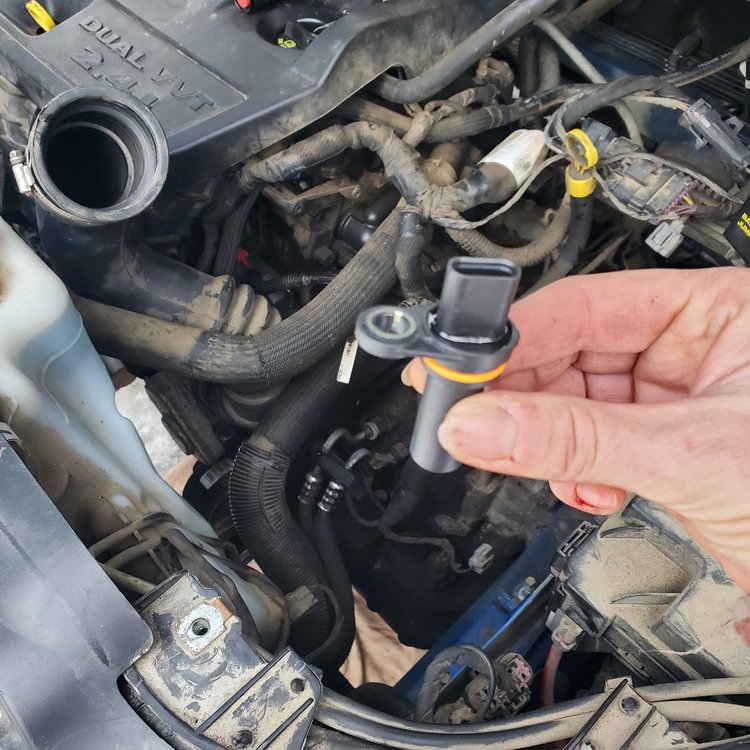

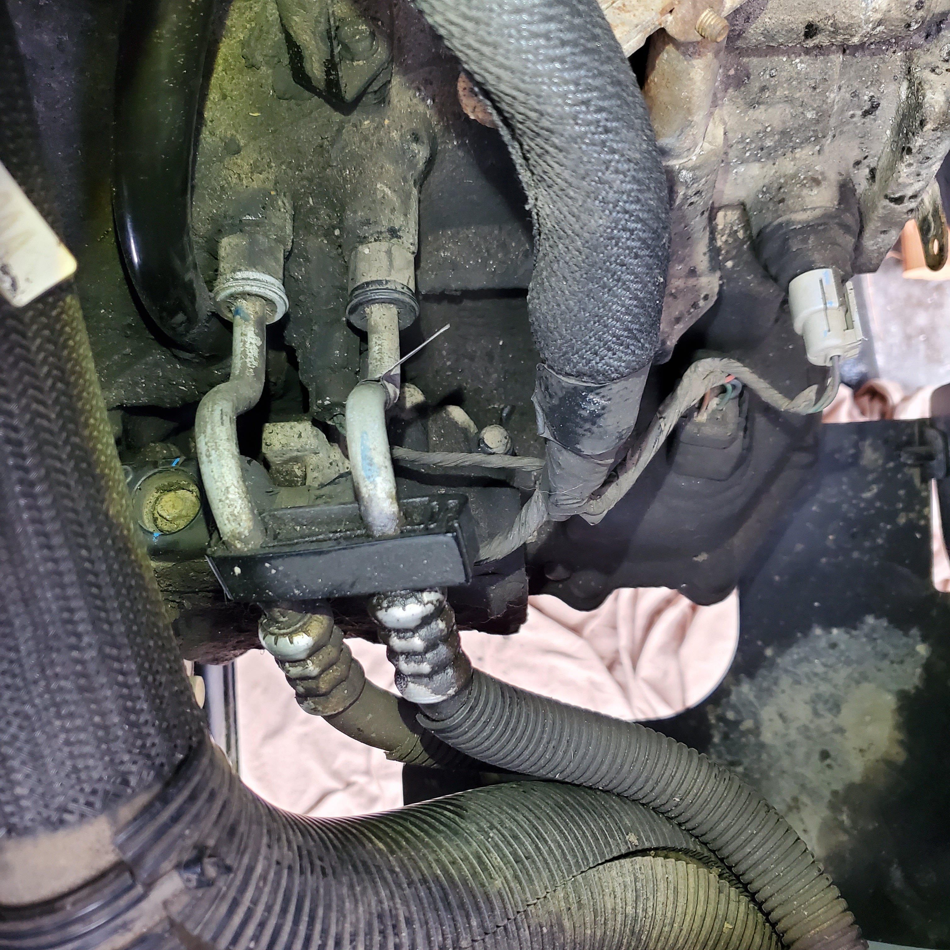

Good morning. I ran a scan with no codes. I got the CPS and have searched & searched for the location of it on my 2010 journey 2.4L front wheel drive, bare bones model, with no results. You have been super helpful and I'm wondering if you can help me with the location? I found other years and engine sizes and they all seem to be in different random locations. Driver side, passenger side, go from the top, go from the bottom,  take this off, take that off, dissect everything..... none of which you would be able to just look in to see if it's there. I'm going bonkers.

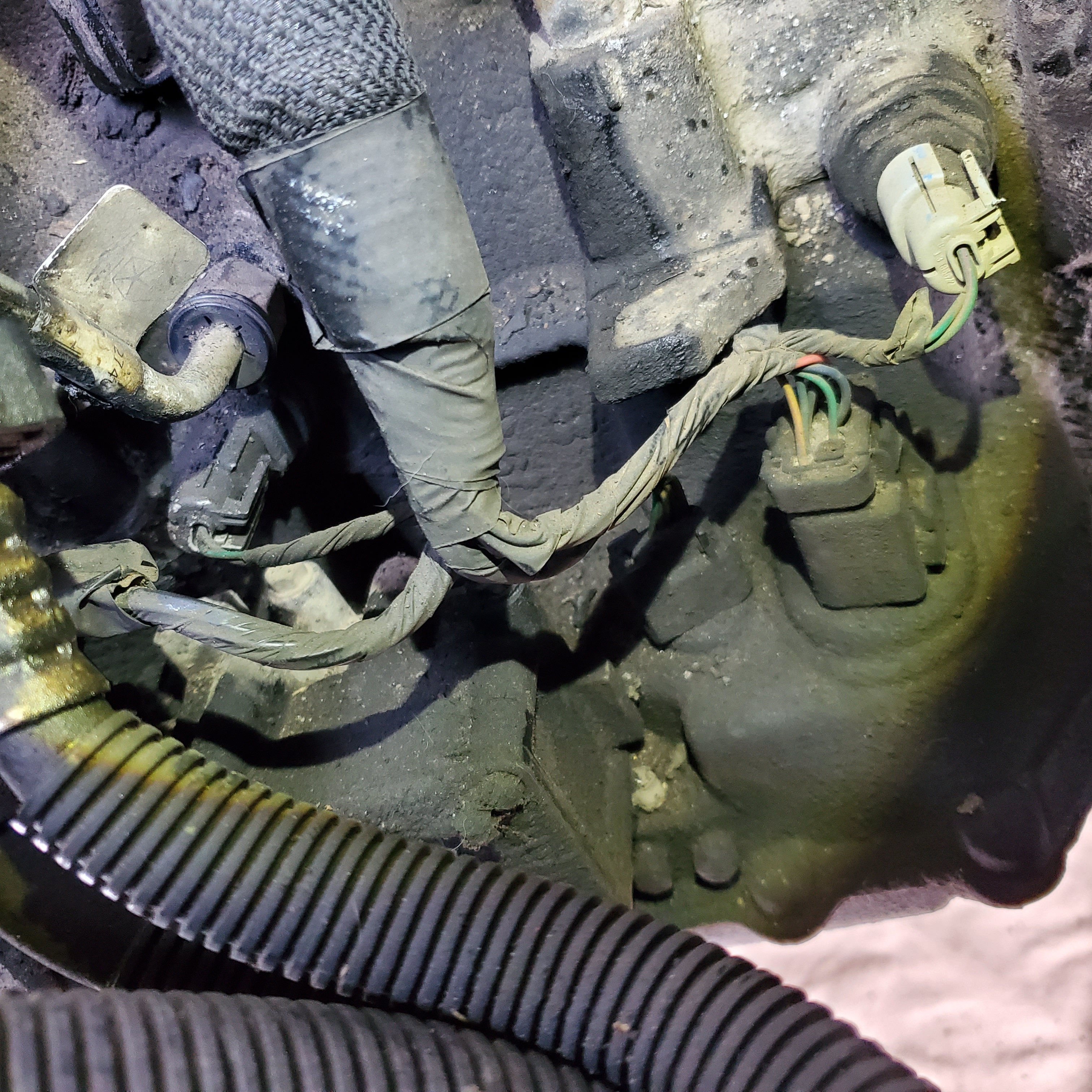

My brain says it's got to be on the driver side (transmission side). Took off air cleaner assembly and I am seeing these 3 items with electrical going to them. I absolutely don't know which one is CPS or if I'm even in the correct area.

That is it! Thank you! I swapped it out and the car is still not starting. It's like it's just not getting spark but I don't know how to check that on fuel injection engines. All relays and fuses checked out good. Battery is good. Starter is brand new. I am wondering if it is not throwing codes because the battery had been disconnected which clears the memory and of course the car won't start. I am at a loss. The starter was engaged for maybe 30 seconds with engine running and then I smelled & saw a tiny poof of smoke in the cab. It was dark out and I only saw it up in the light of the dome lighting. Shut the car off immediately.  Is there a way to check the ECM? (Computer, itself) the engine light is on with key in accessory position but, I think those lights are always on until the car starts?????
Crap, thought it might be the …issue. My daughters in laws 2.4 journey CPS died well before your 160k miles. It’s a common failure wear item.  It would have cut off spark to plugs. Tricky to trouble shoot.
