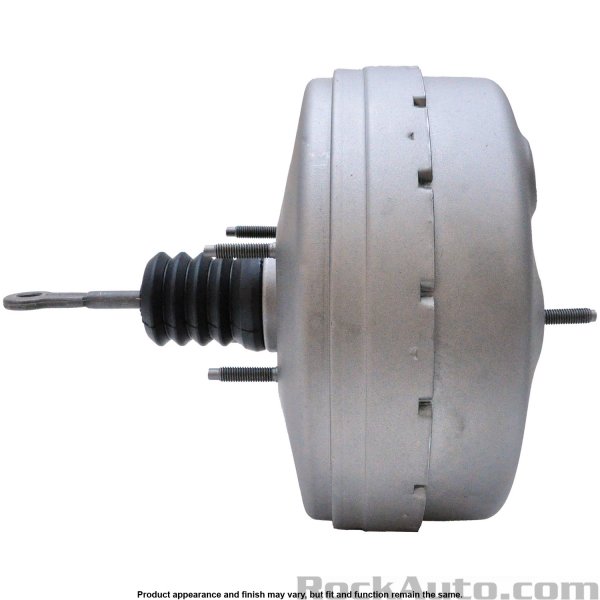

Vacuum booster has check valve so it holds  vacuum for a period of time...say a Wallymart shopping visit for 2 hrs so assist still there on restart.
Over night especially in winter,  vacuum lost and engine needs few seconds to recharge booster, so initial stiff pedal.
If pedal pressure is varying while driving, could be a master cyclinder issue.
Since about 1969 all master cyclinders are two stage design (probably US federal gov safety mandate).  If primary seal fails, the pedal almost to the floor will still have a large amount of braking ability. Not full since back up stage is smaller bore, but enough to theoretically stop car.
