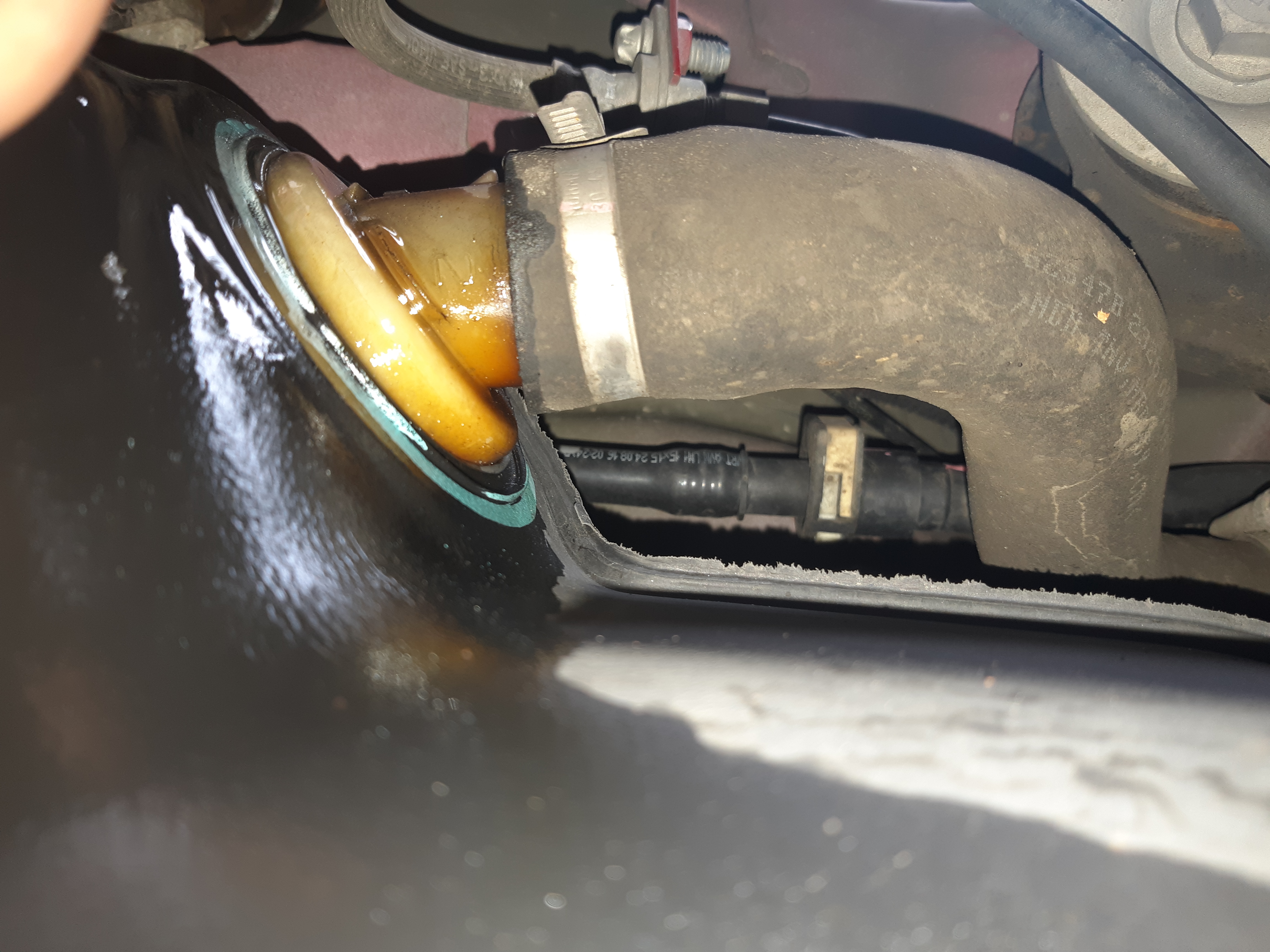

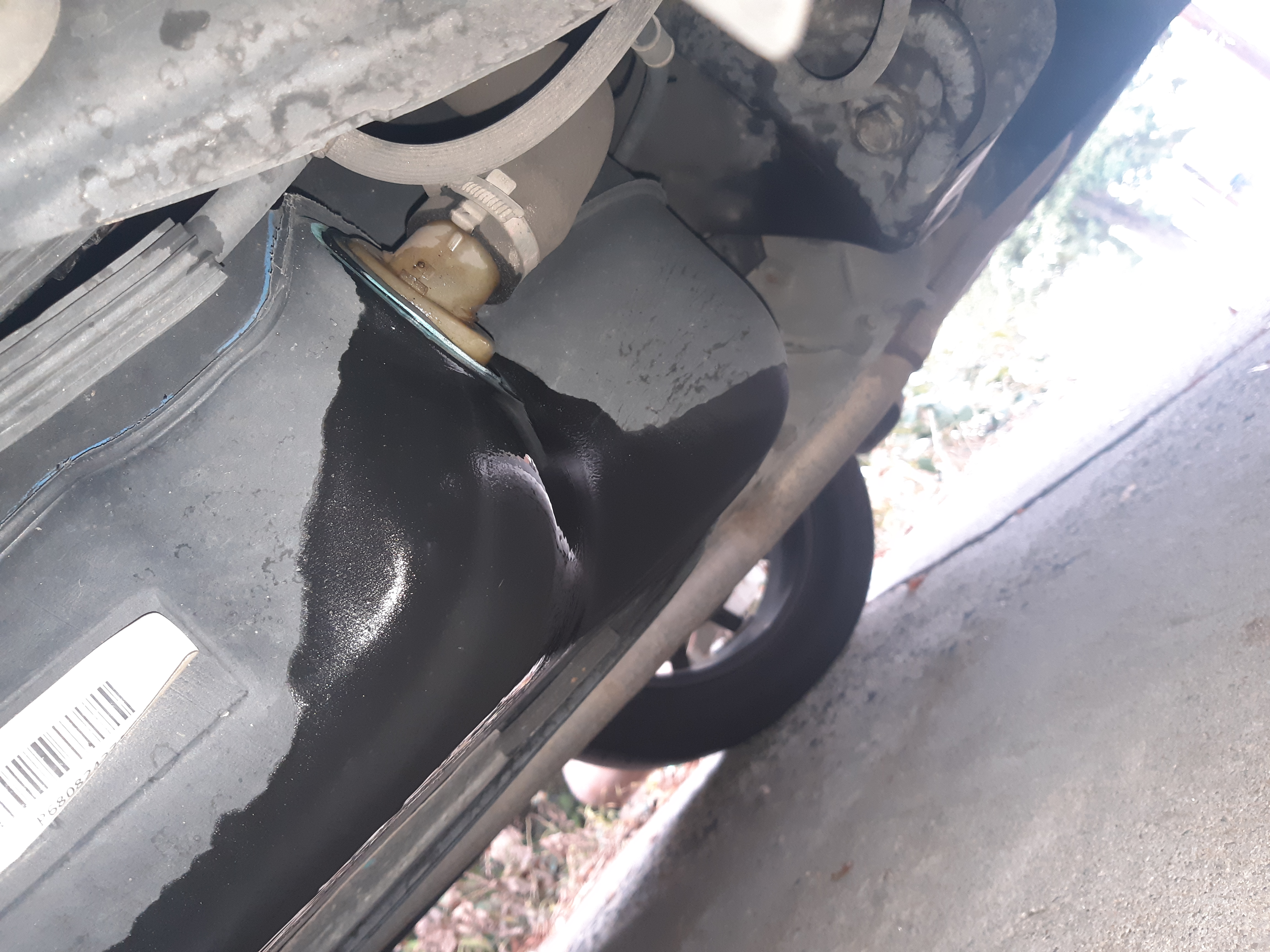

DizzyR/T Posted October 25, 2019 Report Share Posted October 25, 2019 The images is of the gas tank the leak appears to be coming from where the filler hose meets the tank I had noticed a little gas smell nothing to crazy plus it's been raining where I'm at. 2 days later I fill up and go home now it's just steady drip drip drip so I jack the car up a bit to take these pictures, has anyone else had this issue I have extended warranty cant get into a repair shop of theirs until 10/31/2019 and that's for them to diagnose the problem today is 10/25/2019 No check engine light no accidents and never bottomed out. The blue circle gets to me I wonder if this has been worked on before the problem is already circled, and the gas tank is not part of the powertrain.Does anyone else who has a AWD GT have this blue circle on their gas tank. Has anyone else had this failure maybe similar? Quote Link to comment Share on other sites More sharing options...
2late4u Posted October 25, 2019 Report Share Posted October 25, 2019 (edited) well since you have the extended warranty, wouldn't worry about it.if you didnt i would clean it off really good. crank it up and you should see where it is leaking you might would have to let it run for a while to build pressure but shouldn't take long. my daughters caravan started leaking gas on topof the tank where the fuel pump was bolted to the tank it was a plastic fitting where the gas was delivered to the fuel line. there are a lot of you tube vid on it was a common failure...at least this is easy to see where it is coming from..please take the time to report back what they did and the cost for other posters that might come up with this problem....happy trails Edited October 25, 2019 by 2late4u spelling jkeaton 1 Quote Link to comment Share on other sites More sharing options...

2late4u Posted October 25, 2019 Report Share Posted October 25, 2019 well did you try to clean it off and dry it off and see where the leak is its either at the hose end or around the plastic inlet at the tank? quit worrying about it being a safety hazard ,and or recalls and such,,,,wouldn't take long to find out where the leak is. and yes it wont be covered under the power train but if you bought a extended warranty it might be,, but as i have a 100 ded myself so you might want to fix this yourself if you can. as a rubber hose or plastic fitting might not be covered and then you will still be out the fee for checking it out.as for the blue ring i would be that is the manufactures process as i see blue as well going around the tank seams jkeaton 1 Quote Link to comment Share on other sites More sharing options...

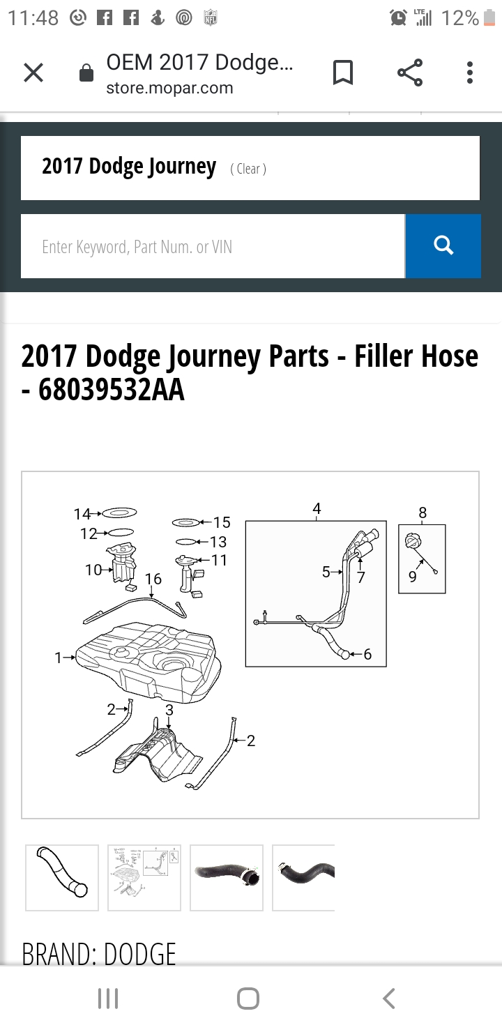

DizzyR/T Posted November 5, 2019 Author Report Share Posted November 5, 2019 Well update now. Carmaxx calls me and says they need to order a tank now, which is what I said I would need to begin with I was correct. It took 2 whole work days for them to try and replace the o ring that mopar does not sell, and I'm willing to bet that dodge would not have tried that but they are not dodge so theres that. However I showed them the part list they still tried to do it but now they have to replace the tank which will take 6 days to arrive. Service advisors are just really over paid middle men. The tech and I would have had a clear understanding but I guess this is there way of doing things which is costing them more money so. $0 out of pocket the tank parts are not interchangeable hopefully this thread helps someone out hopefully this isn't someone else's experience 2late4u, OhareFred and jkeaton 1 2 Quote Link to comment Share on other sites More sharing options...
