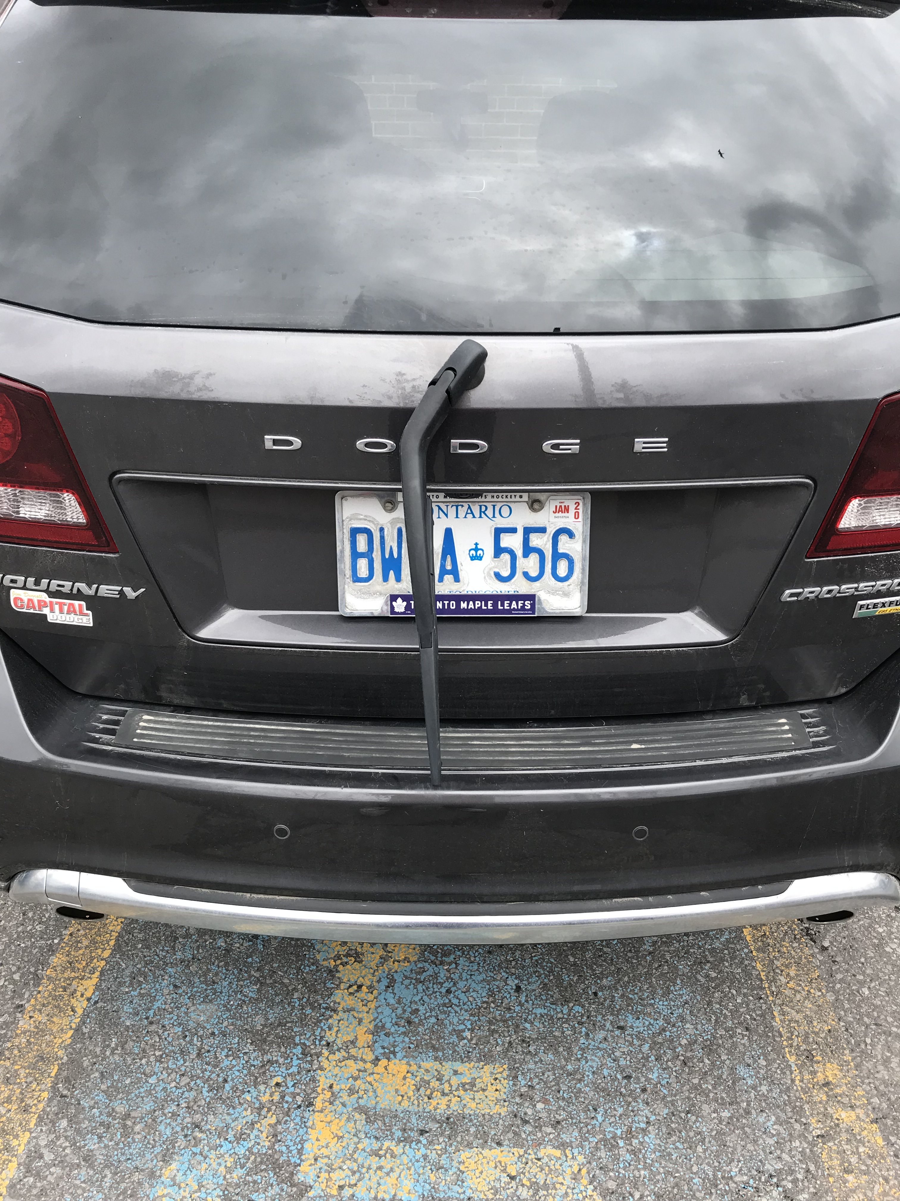

Hi all, wondering if this is an easy fix or if I have to get it checked out.  My rear wiper all of a sudden on the weekend decided it didn't want to work.  I went to use it and it just dropped.  I though it has fallen off, but I got out and checked and it was there, just hanging down.

On 2019-05-07 at 9:39 PM, mechanical-idiot said:
Got a picture of this that you can show us?

I can probably get one tomorrow

There’s a nut under the cover, maybe it came loose...
a;so after removing the nut the stud is splined so if the whole arm is hanging down and the arm is still tight then it might be more of a problem like the motor has went bad,or the linkage has slipped, good luck and let us know what you find out
