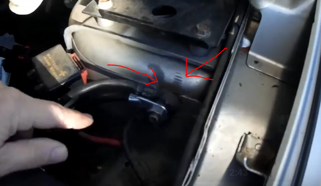

I would first ask you, what have you done so far to try to fix the problem, if anything. I don't think this is just a DJ issue, I truly believe this is a 'newer' car type of issue. I've dealt with three cars now that had the same type of issue and with all three cars we have completely cleaned out the ground wire where attached (remove any corrosion, wire brush the paint at the connection, and added anti-oxidation gel/stuff), and the issues have gone away on all three cars. With all the systems on these newer cars, making sure the ground is securely connected to a clean metal surface is necessary. Adding an extra ground is just avoiding fixing the issue itself. And if I look really closely at the car on the video, it looks like they cleaned the original surface itself (see pic). That was probably the fix without having to take the extra step. Anyway, that's where I would start, then go to the fuse box and relays to see if there is some corrosion in those areas as well. Moisture will create that little bit of corrosion that will effect the electrical.

Good point.  Have not seen any corrosion on the remote negative terminal but we will sand the paint off and apply anti-oxidation coating in its place.  Can you recommend a brand?
