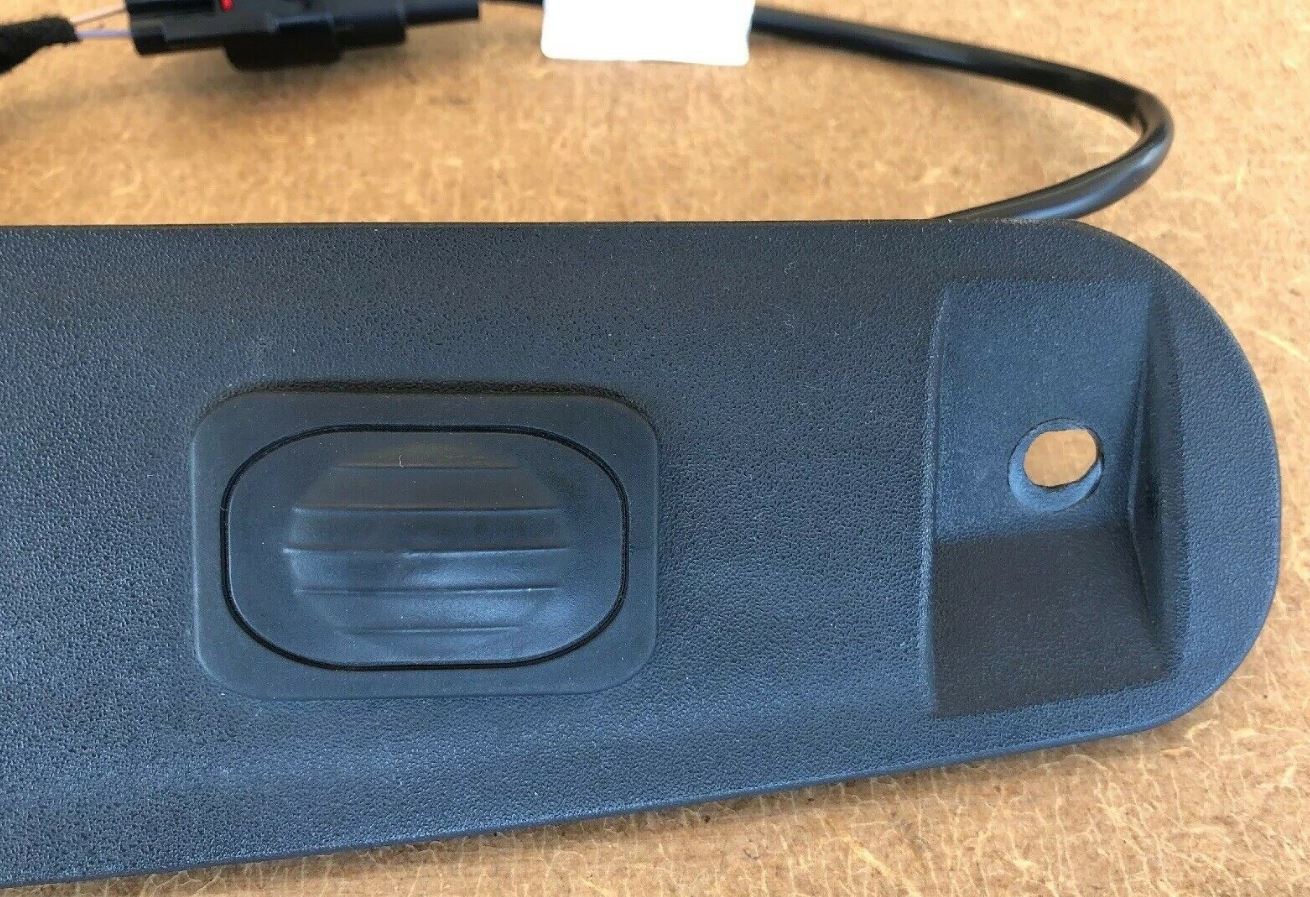

Gary Posted January 17, 2016 Report Share Posted January 17, 2016 (edited) I have a 2012 Dodge Journey whose rear hatch isn't locking/unlocking the hatch and other doors as it normally does when I press the button on the hatch near the licence plate. The locks at the other doors work properly. I took the plastic trim off the rear door to see if it's a problem with the switch. With some Googling I see the part number is 68080582AA and when I unplugged it, it has only two wires on the connector. Assuming it's just a switch (with no other "intelligence") I unplugged it and checked with an ohm meter to see if it registers a button press, and it does nothing pressed in or not, so that would make it seem as though the switch is broken. To double-check, I checked the terminals on the connector leading to the vehicle to see if there was a voltage and there wasn't any (at least not 12V). I "shorted" the terminals to "fool" the vehicle into thinking that the button was pressed, and it doesn't do anything either. I also sat in the hatch area, closed the hatch to sit inside so I could "short" the connectors to "fool" the vehicle again (in case the vehicle ignores button presses when the hatch is open--can't say I ever tried it), and it doesn't do anything, either (I did remember to leave the key outside the vehicle). Does anybody on here know if the switch is truly "dumb" and is merely a switch, or is it "intelligent" and isn't working because it isn't getting what I assume should be 12 volts? The reason why I think that it may want 12 volts (and therefore be intelligent and send its signal wirelessly to the lock control module) that I suspect that a wire in the wiring harness has broken due to flexing back and forth over several years. I have noticed lately that when I open the hatch, the hatch light turns on and sometimes flickers on and off on the way up and open. So, can somebody tell me how the system is supposed to work? Edited January 18, 2016 by Gary dhh3 1 Quote Link to comment Share on other sites More sharing options...

mike35z Posted February 13, 2021 Report Share Posted February 13, 2021 I have a 2013 Dodge Journey. The rear liftgate push button is not locking or unlocking the doors when the fob is less then 3 feet from vehicle. The door handle lock and unlock buttons work OK. The rear liftgate pushbutton has never worked since I purchased the car 2 years ago. I replaced the cruise control switch unit due to its failure to function. It seems there might be some electrical issues with conductor contact areas of switches. The rear liftgate pushbutton is around 40.00 dollars a bit high for a switch in my opinion. I am planning on replacing the switch in warmer weather. The plastic covers that need removed in the liftgate area are not easy to remove in this 20 degree weather. I will wait until the plastic is easier to remove in a few months. I assume others have had similar issues with their Journey's. Perhaps the engineering department for Dodge will read these complaints and will install higher quality switches that last a minimum of ten years, or the life of the vehicle. Quote Link to comment Share on other sites More sharing options...
