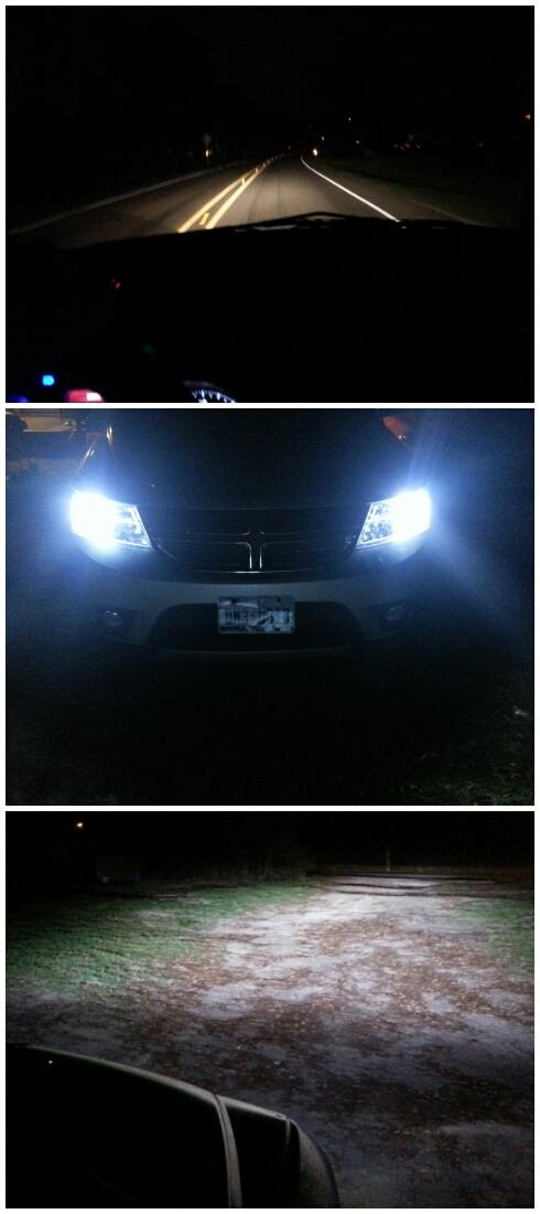

hid lights installed pic
All I have is 55w 8000k ran with a supply line relay for the extra wattage that they will require. When I first hooked them up they would flicker on and off shut off. So I got to reaerching and reqding alot about what everyone has pist we d on here and come to realize that the relay would provide the extra wattage to the lights so they would stay on.

I did have a motorcycle but sold it when my family and I needed the money. I am looking to get another one soon maybe be going to look at one today its a 2000 honda superhawk 996. I didn't want to sell it but I can always get another one family more important to me than my bike was. I have a picture of me going down thw highway this morning. I think the cutoff is just right for being a journey with stock headlights width reflectors still installed. Will post a pic of it.
That is not bad at all. For HIDs in reflectors I actually thing this is the first car with good cutoff. if you google HIDs in reflector housings you see what I was expecting. scattering everywhere and just horrible light distribution, but this is not bad at all. I am impressed. Good work! :beerchug:
Thanks man I appreciate it im only fixing to be about 50.00 into the whole kit. I ordered everyrhing and installed it all with some help from a friend of mine but I think I am going tonhave to roder the cancellers they will stay on for about 30 to 45 mins then shut off. I also am aquiring another set for my high beams for free just going to order the relay and the cancellers for them also
