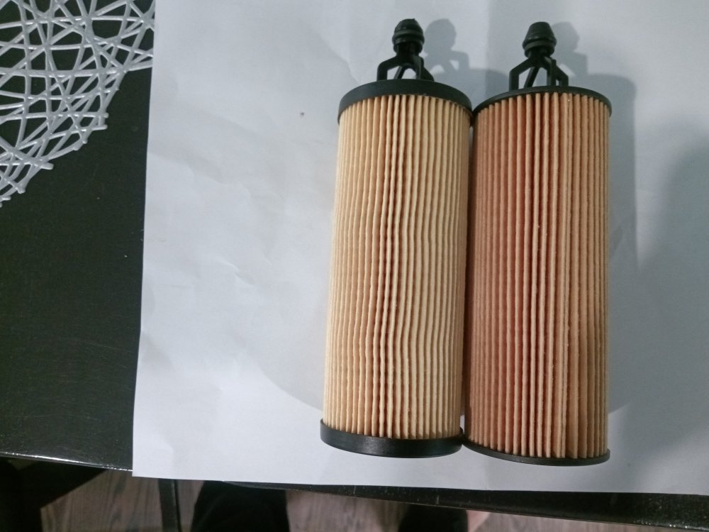

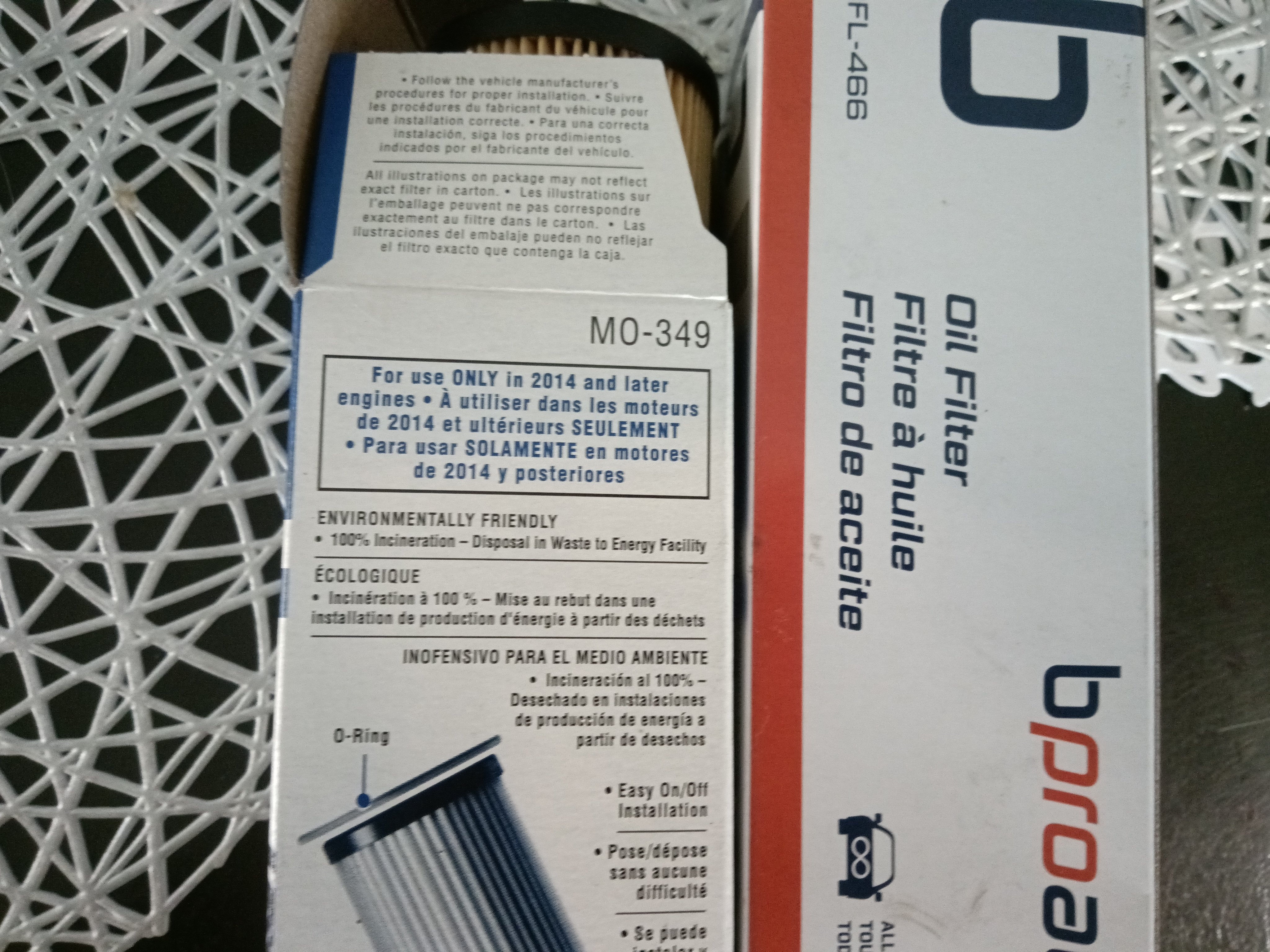

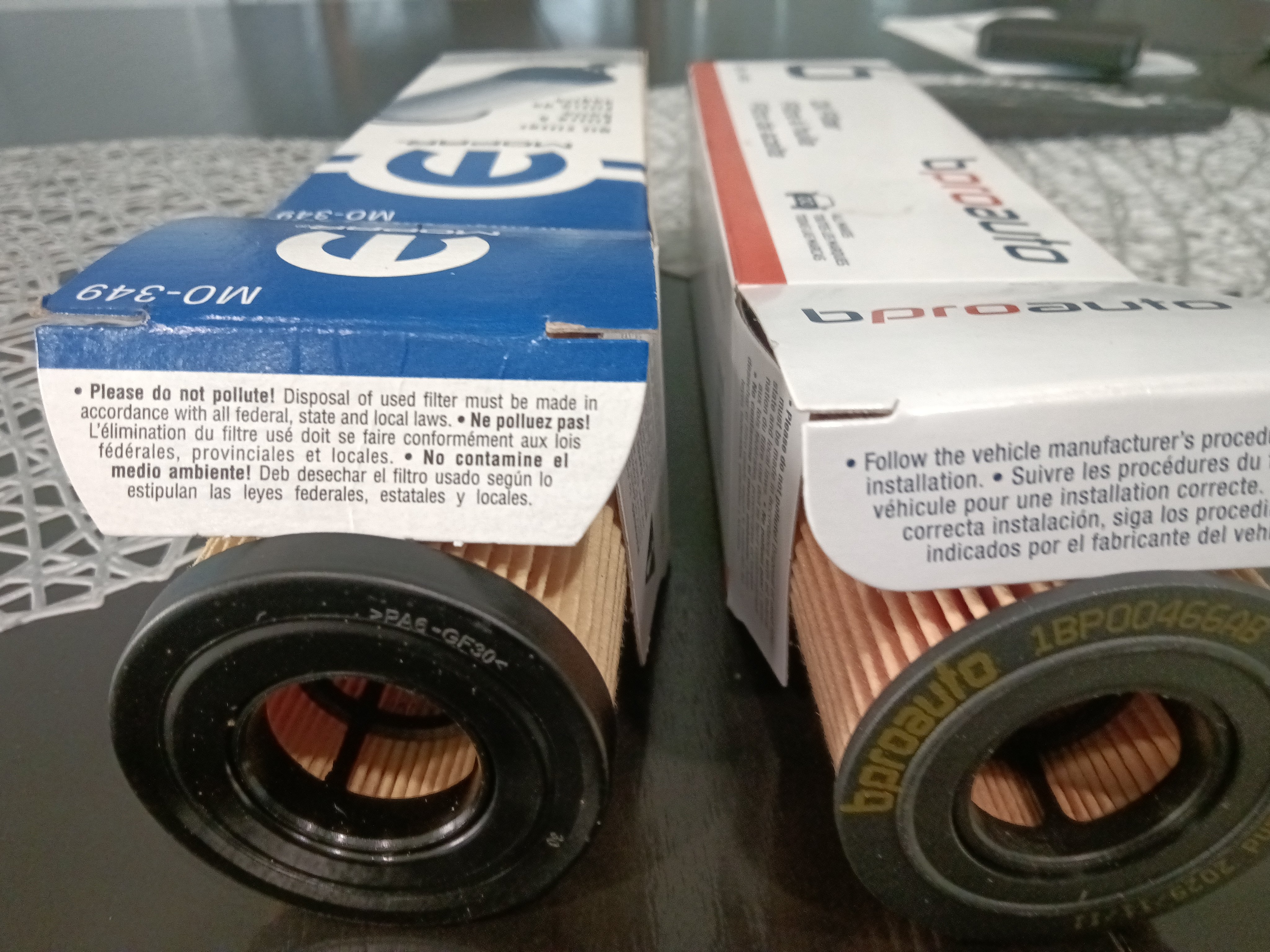

John/Horace Posted September 20 Report Share Posted September 20 (edited) With the crazy price of oil they may be cutting corners to save money, or it's just laziness. I assumed screw on cartridge filter; forgot it's 3.6 internal cartridge. Your 2013 has a diff filter than 2014-2020, keep that in mind, not compatible. But inside filter cartridges have markings on them. Plastic top cap can be easily removed and reinstalled with new filter, torque is 25 NM. OEM I think are wix made, one of the better manufacturers. This new Mopar I have showes >PAG-GF30< printed on top seal. The other non oem shows aftermarket company and Thailand. Time to play detective. Edited September 20 by John/Horace Quote Link to comment Share on other sites More sharing options...
