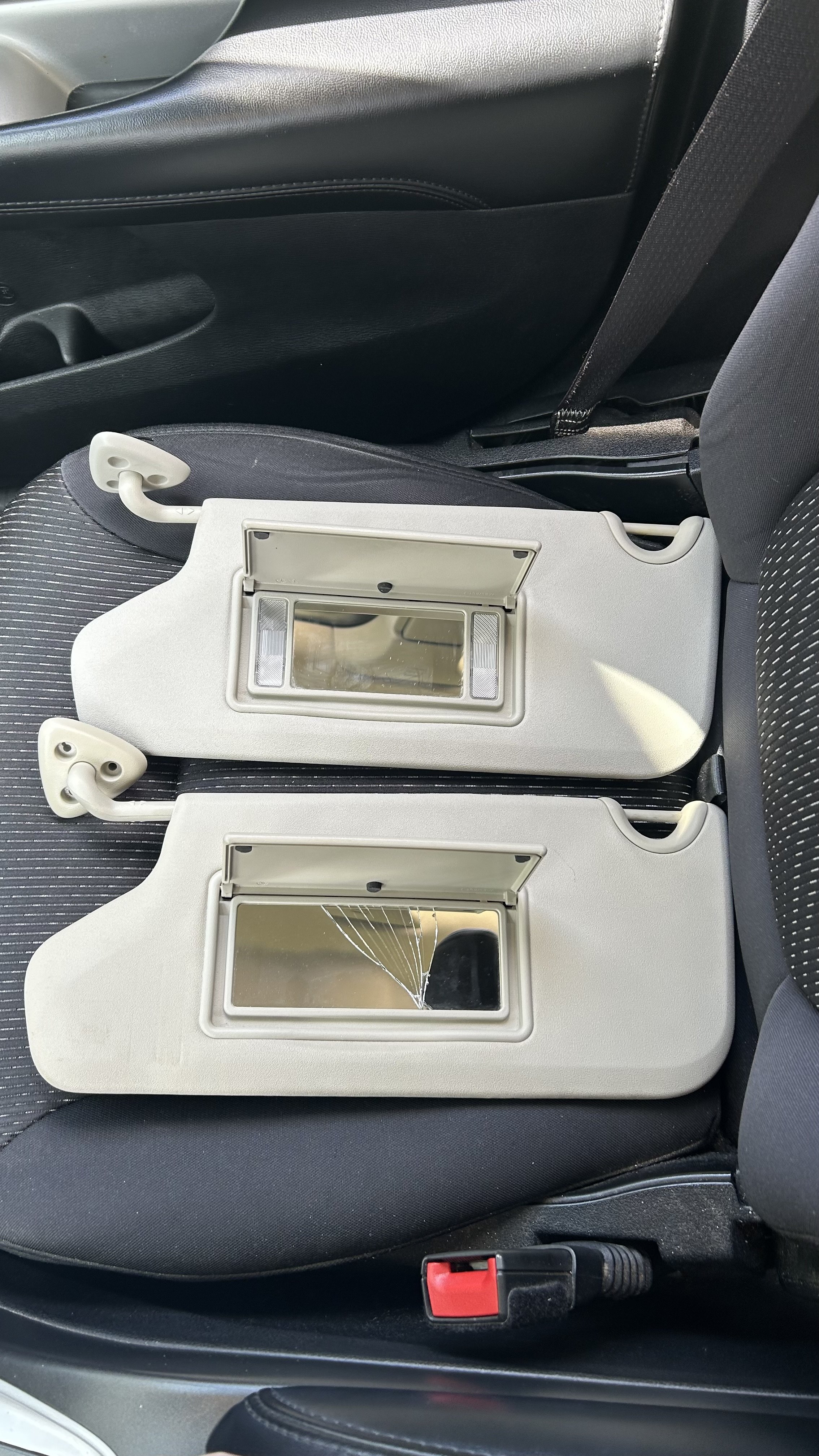

RyanDavidPonter Posted May 29 Report Share Posted May 29 Hello! I have a 2015 Dodge Journey SE and it was not equipped with the vanity mirror lights that are typically located inside the sun visors. I bought both new (to me) sun visors that are equipped with the vanity mirror lights, and after closer inspection, the wiring shouldn’t be too hard. Both sun visors have a positive and negative wire (which is for the vanity mirror lights). I should be able to tap both wires to the front map lights and hopefully that’s it. Besides all of this, I’m also going to be completely redoing my 'pre-sagging' headliner in black, so I’ll most definitely be doing the sun visors in black too. The headliner project will be included in a separate thread later on, so be ready! jkeaton 1 Quote Link to comment Share on other sites More sharing options...

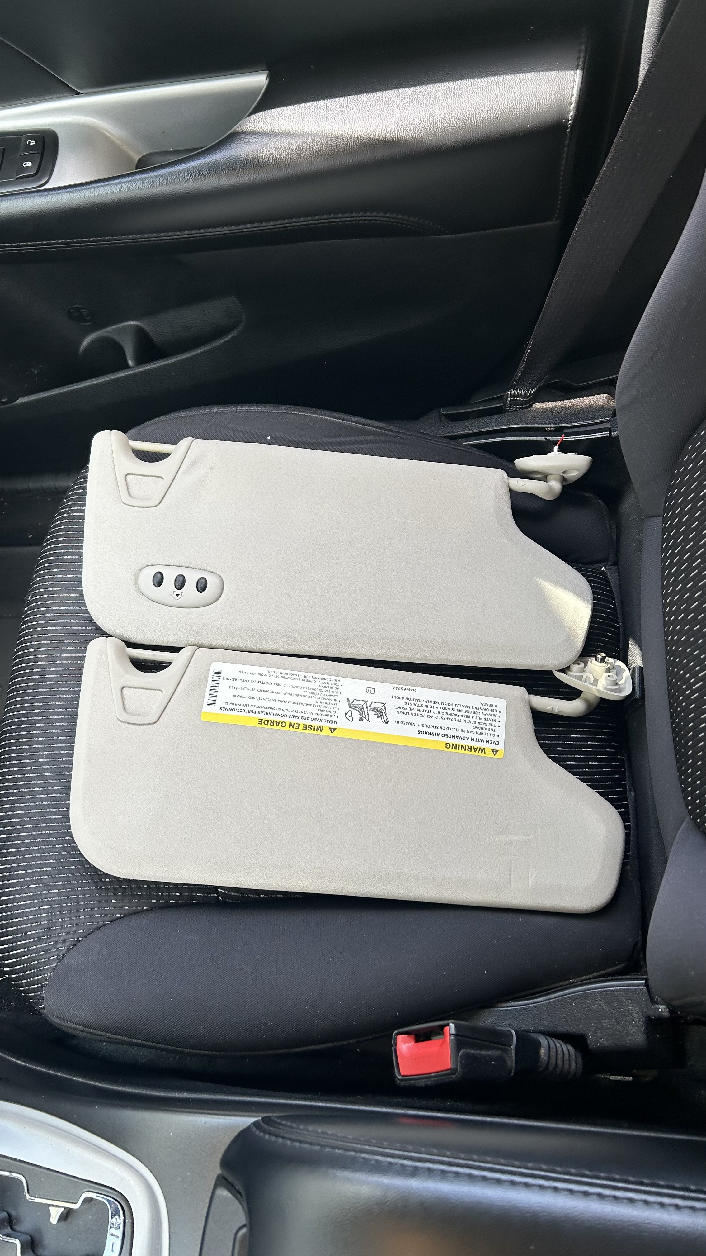

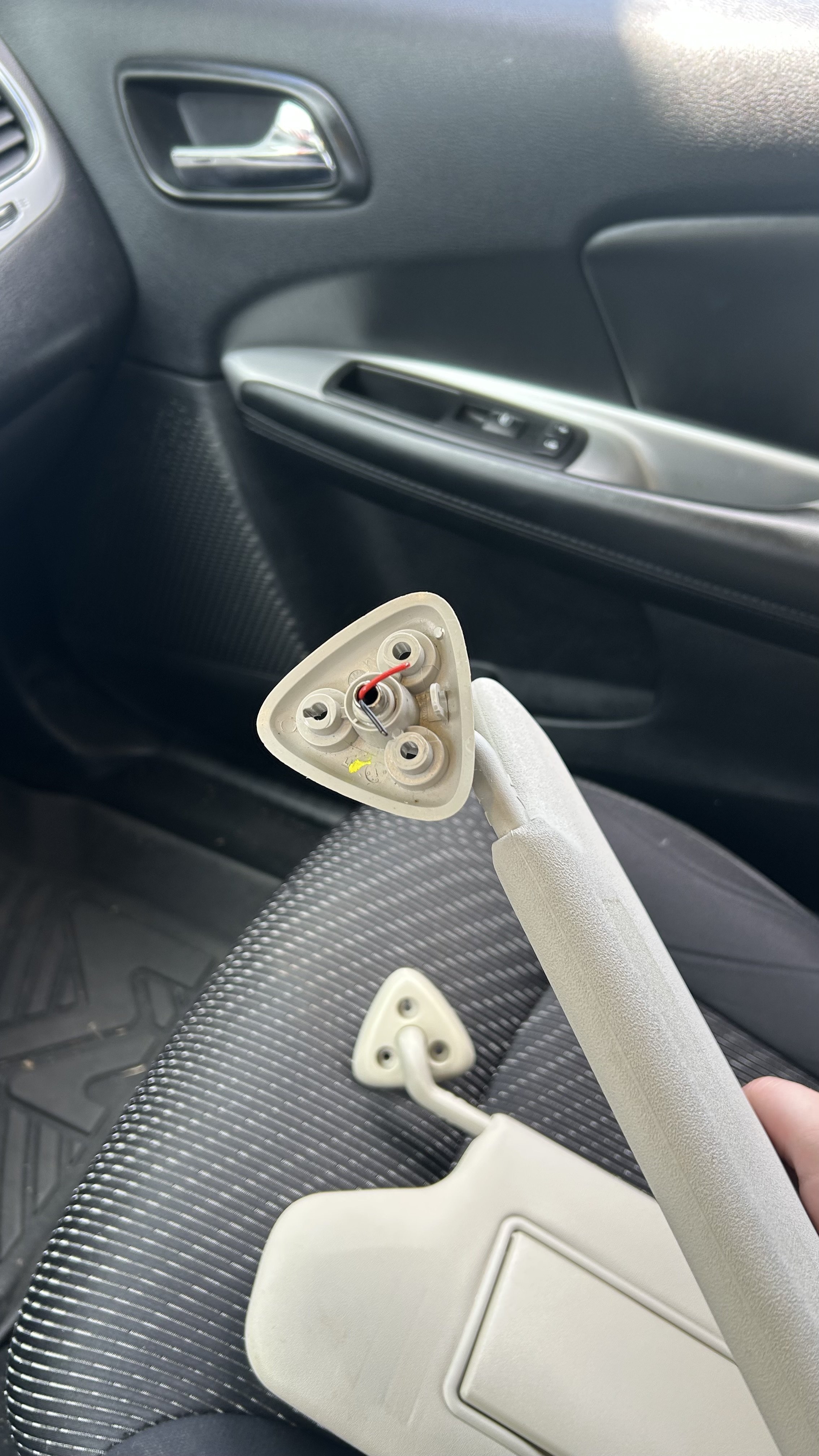

RyanDavidPonter Posted June 6 Author Report Share Posted June 6 (edited) Here is a quick comparison of the two. As you can see, the glass on the original sun visor broke, lol. I also didn’t even notice that the new sun visors I bought also included Homelink, which should work since it’s already a transmitter itself. As you can see, it is just a red positive wire and a black negative wire, not too much of an headache when it comes to wiring these up. FYI, this is not an easy project. You have to drop the headliner a bit on the front so you can run the wires from up top. Also, I was having trouble fitting the sun visors on at first, but then I found out that there is a little tiny route where the they mount to the roof, and that’s where the wires are supposed to go. If you don’t have the wires going through there, the sun visor won’t mount properly because of the wires being in the way. One downside though, the driver side sun visor wires are way too short, so it’s gonna be tricky doing this one. Edited June 6 by RyanDavidPonter 2late4u 1 Quote Link to comment Share on other sites More sharing options...
John/Horace Posted June 8 Report Share Posted June 8 Solder and heat shrink on a pig tail extensions. Takes less space then crimp connectors, conducts better. Electronic solder and paste flux. Multi strand copper,not single strand. Pop out the old broken mirror from visor, maybe glued in. If it's not hard to remove, do same with powered mirror, then solder new wire extensions right on hidden contacts on back of new mirror assembly. RyanDavidPonter 1 Quote Link to comment Share on other sites More sharing options...
RyanDavidPonter Posted June 9 Author Report Share Posted June 9 20 hours ago, John/Horace said: Solder and heat shrink on a pig tail extensions. Takes less space then crimp connectors, conducts better. Electronic solder and paste flux. Multi strand copper,not single strand. Pop out the old broken mirror from visor, maybe glued in. If it's not hard to remove, do same with powered mirror, then solder new wire extensions right on hidden contacts on back of new mirror assembly. Exactly what I was thinking. I currently have the headliner out, and now I have better access to the harness for the headliner. Quote Link to comment Share on other sites More sharing options...
