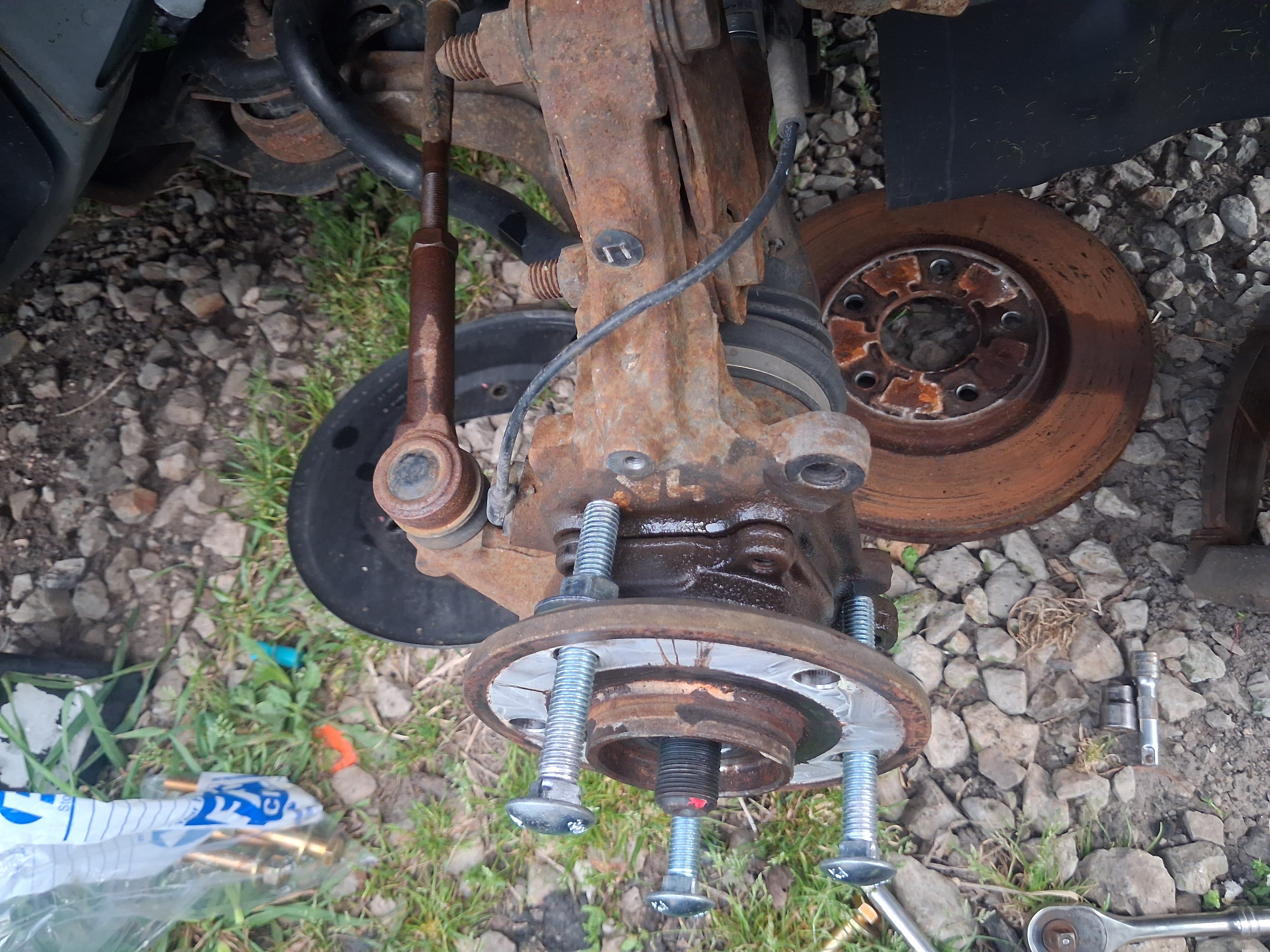

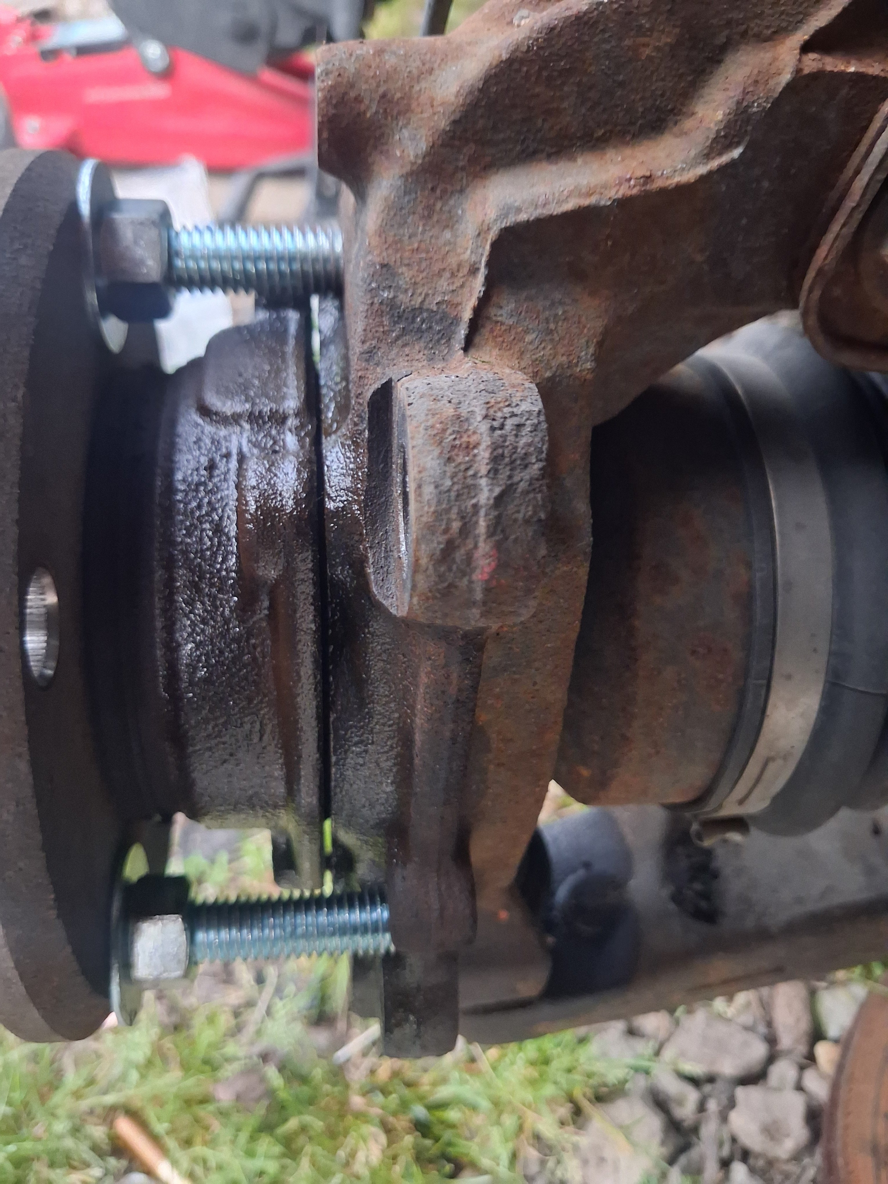

Engineerbasher Posted 11 hours ago Report Share Posted 11 hours ago I figured I'd share this with whomever finds themselves fighting with stuck bearing assembly. The bolts are regular 1/2 inch grade 2 carriage bolts with nuts and washers. I tightened the nuts up and gave the hub a good wack to break it loose then just worked it out by turning the nuts on the back of the hub until it came out. 5rebel9 1 Quote Link to comment Share on other sites More sharing options...
5rebel9 Posted 1 hour ago Report Share Posted 1 hour ago Certainly a "novel" approach to a "sticky situation"! In my climate area, we try our best to not have to remove the rotor dust shield as those small 6mm bolts tend to just snap off the heads and leave you with more "fixing" to do. Quote Link to comment Share on other sites More sharing options...
