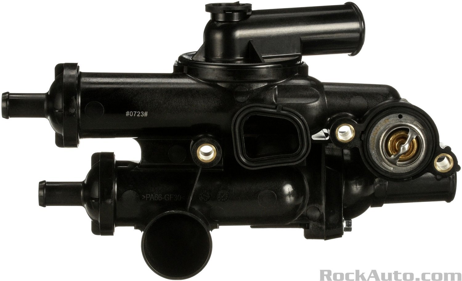

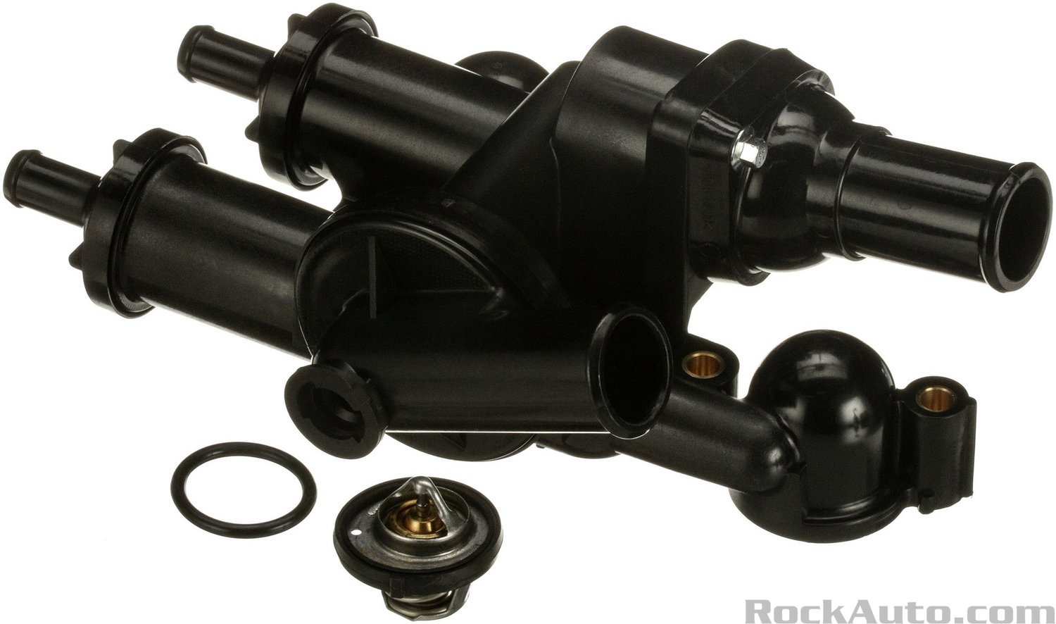

John/Horace Posted April 3 Report Share Posted April 3 My daughter in laws 2.4 has 125k miles and still no water pump issue. They seem to use a decent pump. The plastic manifold on the side of the engine that does cabin heat is a problem like 5rebel9 is saying. We fixed two leaks on this assembly. Bottled Water This assembly has the separate thermostat for cabin heat. I bought the whole Gates assembly because the dealer unit was 3 times aftermarket price. Then had a constant drip with the new unit. Ended up moving all new seals to the old factory manifold, no leak afterwards. Just look where the red crusty dried glycol is collecting. Pic is of plastic manifold. Oring on coolant temp sensor is also another leak spot. Might have two problems, fan speed and a coolant leak. Quote Link to comment Share on other sites More sharing options...
