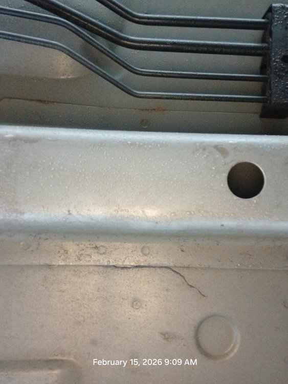

J'sjourney Posted February 15 Report Share Posted February 15 (edited) The carpet on the drivers side was wet. So I looked under the car and I think I may have found a crack. If it is how and where would I go to get it fixed? How long would it take to fix? If you think it may have come from some other area let me know. It may or not be covered under my Extended Warranty (CNA National Warranty). Thanks in advance. Edited February 15 by J'sjourney Quote Link to comment Share on other sites More sharing options...
2late4u Posted February 15 Report Share Posted February 15 probally not where your leak is coming from ,that said mastic glue on both sides of the wall would be a start, I doubt that would be covered under the warranty I am not use to the canadian warranty but my Mopar lifetime warranty only covers mechanical parts and seals... there are some seams that previous owners saying caused them leaks in their journeys cruise Thur the forums section to find their post..I guess you have smelled and checking your ac drain on the drivers side isn't plugged up also the heater core isn't leaking which is on the drivers side as well..... check out YouTube as well jkeaton 1 Quote Link to comment Share on other sites More sharing options...

John/Horace Posted February 17 Report Share Posted February 17 The crack is not the leak, not structural issue either. Polyurethane caulking if it makes you feel better is the best option. A body shop for fixing leaks can sometimes be better than a regular mechanic, imo. There was a few people with a driver's side leak. It turned out to be hard to trace the source. I think it was entering a missed welding joint under the hood, close to the hood hinge area. Try to dry out the carpet as soon as possible. Old towels and a hair dryer etc; need to avoid mold. Quote Link to comment Share on other sites More sharing options...

John/Horace Posted March 4 Report Share Posted March 4 Tough situation; most people have struggled with journey interior water leaks. A minor leak would be harder to find. My leak was mainly when vehicle was parked on a slope. In most leaks reported it was the holes in the chanel that runs underneath the front car doors. There is yellow foam insulation peeking out from the 5-6 visible holes. But where the water goes in isn't necessarily where it comes out (usually chanel holes). Difficult to trouble shoot. Quote Link to comment Share on other sites More sharing options...
J'sjourney Posted March 4 Author Report Share Posted March 4 (edited) Yea, I saw the foam. I agree, where the comes from is always a mystery at times. Like trying to find a roof leak. As I said before trade it in and deal with any loss I will have to take because of the leak. Again. Thanks to all. Edited March 4 by J'sjourney jkeaton and larryl 2 Quote Link to comment Share on other sites More sharing options...
