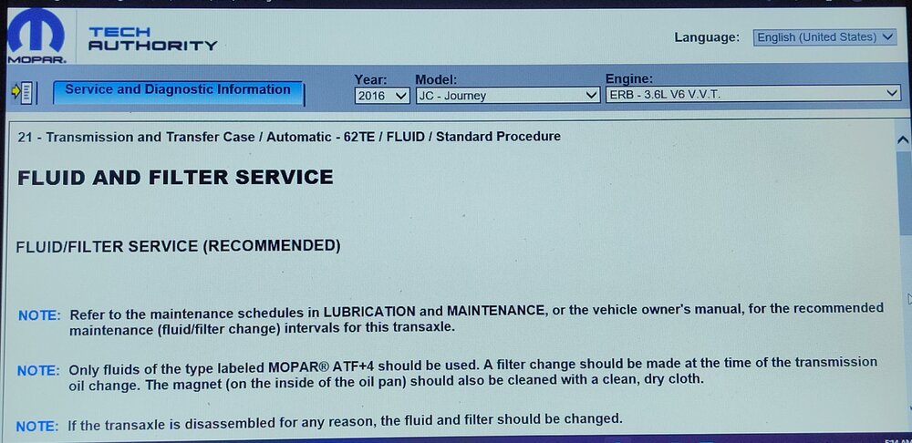

Correct transmission fluid and filter service.
  A) You change the fluid. By draining and dropping the lower trans pan.
   B) There is a FILTER that has to be replaced.
   C) There is a MAGNET  located in the transmission pan.
      This magnet is our best friend. It catches metal pieces that are in the transmission fluid.
Preventing catastrophic damage.
      You check it for metal shavings.Then clean the magnet and the pan completely.
   D) Use the correct fluid.
    Mopar +4 atf.

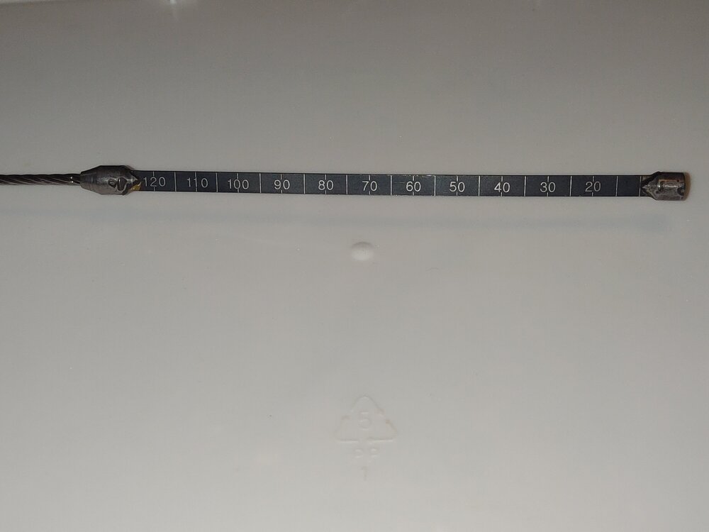

1) You need to buy this Dorman dipstick.

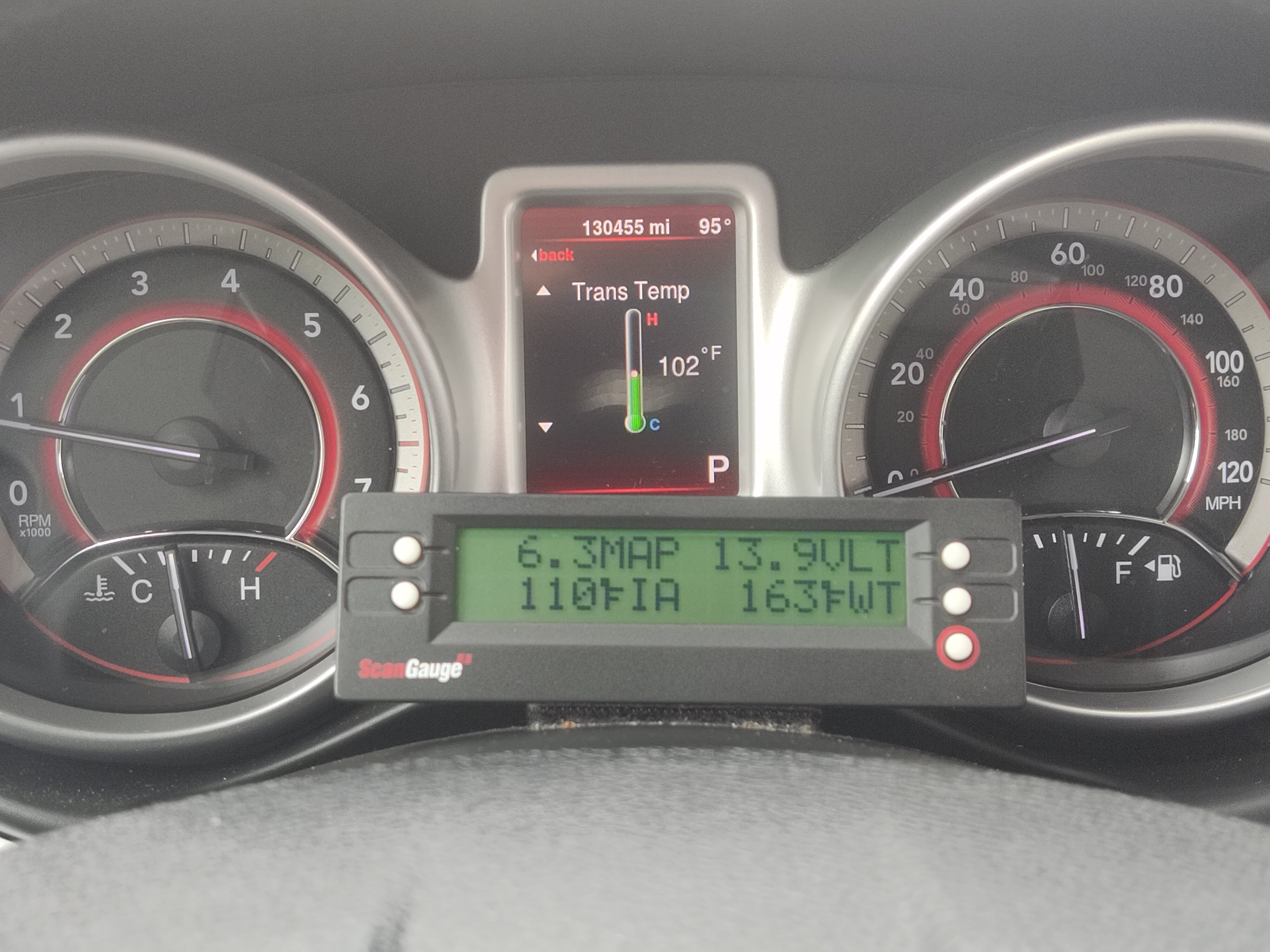

2) Bring the transmission temperature gauge, up on the in dash display screen.

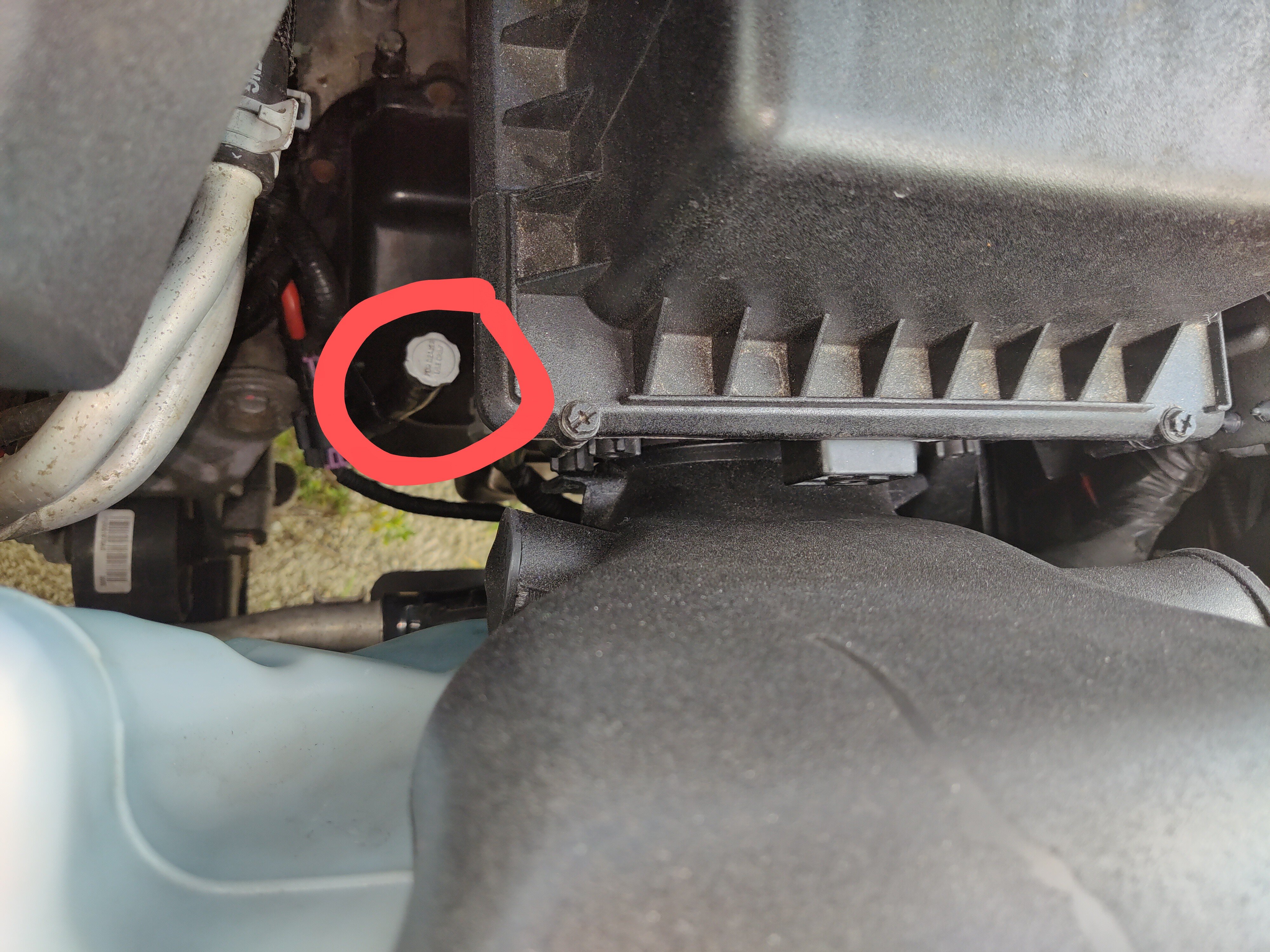

3) The dipstick tube is located to the front left of the air filter box.
    Has a small cap that reads " Dealer use only"

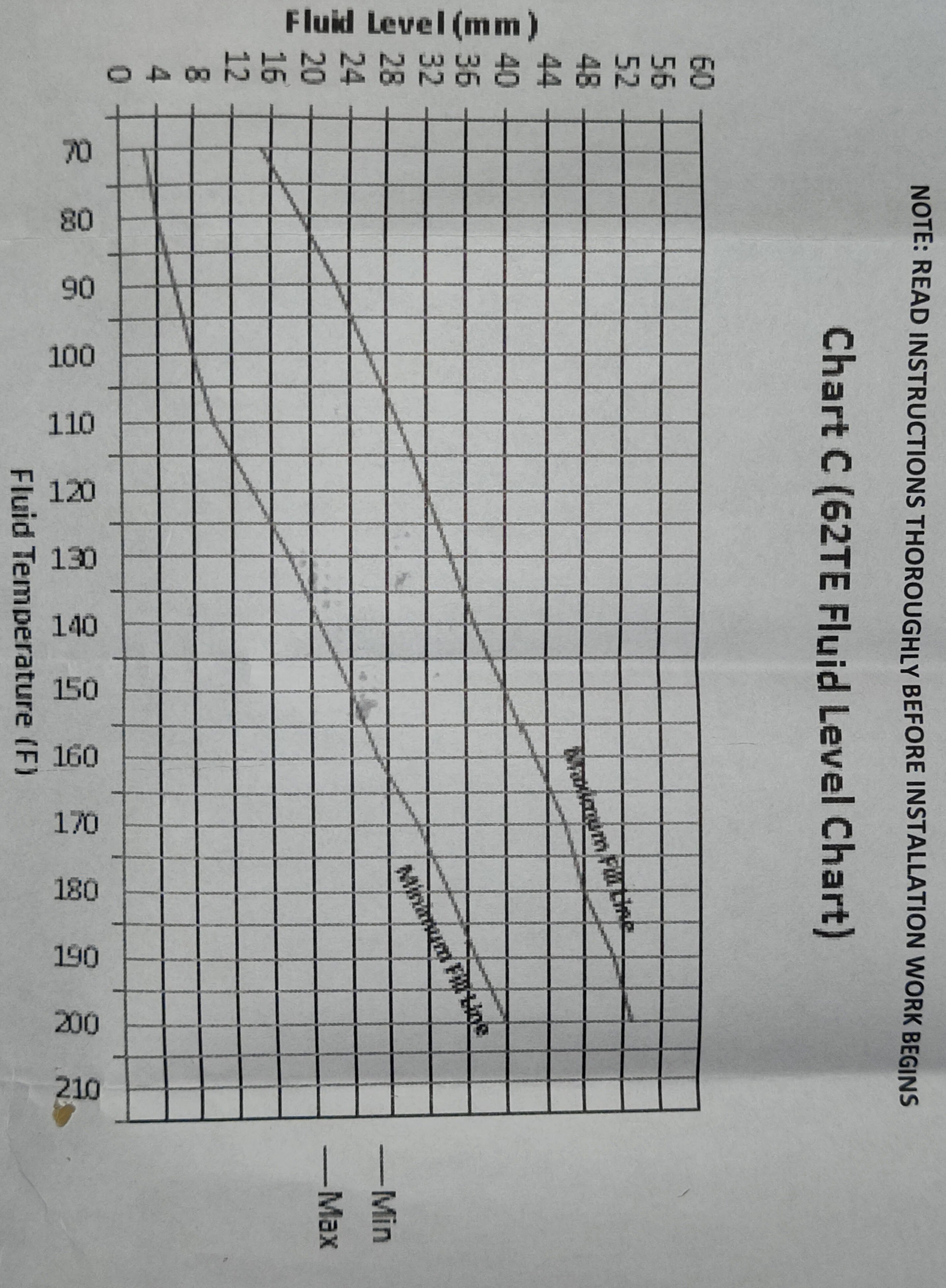

4) The Dorman dipstick includes directions and the chart needed.
    Dipstick is used for fluid checking only. It can't be left in the transmission
5) With the engine running and up to operating temperature.
     Move the trans through each gear. Return to park.
    Note the transmission temperature.
    Inserting the dipstick into the transmission. It only goes about half way in.
    Get the measurement from where the fluid level is on the dipstick.
    Check it on the chart.

If you like the device in the
dash picture. Scangauge II
it's plug and play.
Displays some engine sensors and gauges.
Basic code reader and a gas mileage function.
Check it out.
Amazon has it.
ScanGauge  https://a.co/d/06dPyBs9
