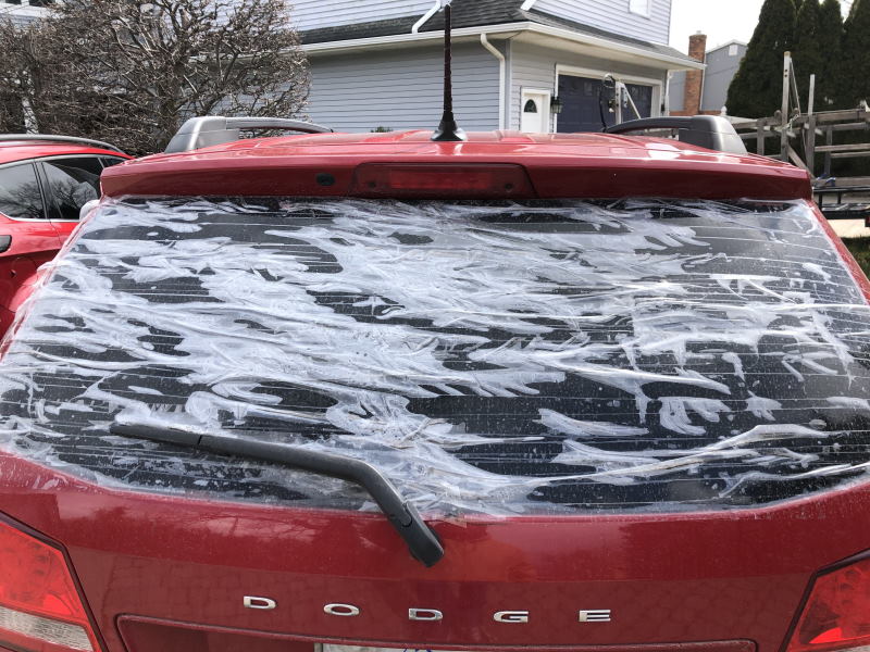

The shattered window was layered with plastic packing tape on both sides to keep it together and in place until the replacement.  Not pretty, but so far its holding well.

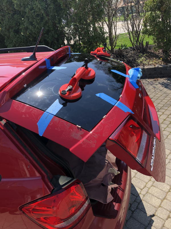

My only recommendation would be to NOT use 4"+ suction cups from Harbor Freight.  The glass has no flat surface area and the cups were too large to get a secure grip anywhere on the curved glass surface.

Shattered window held in place with packing tape (both sides)

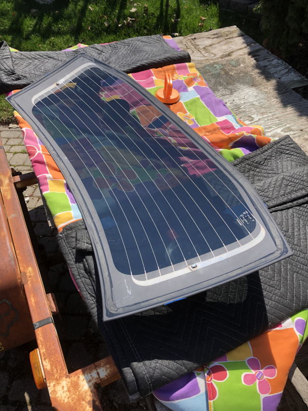

Cleaned up and prepped replacement glass

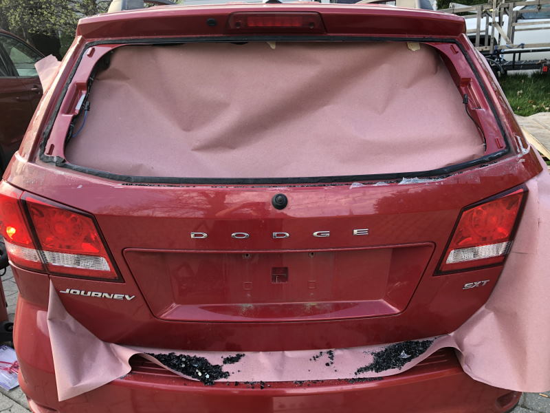

Broken window removed

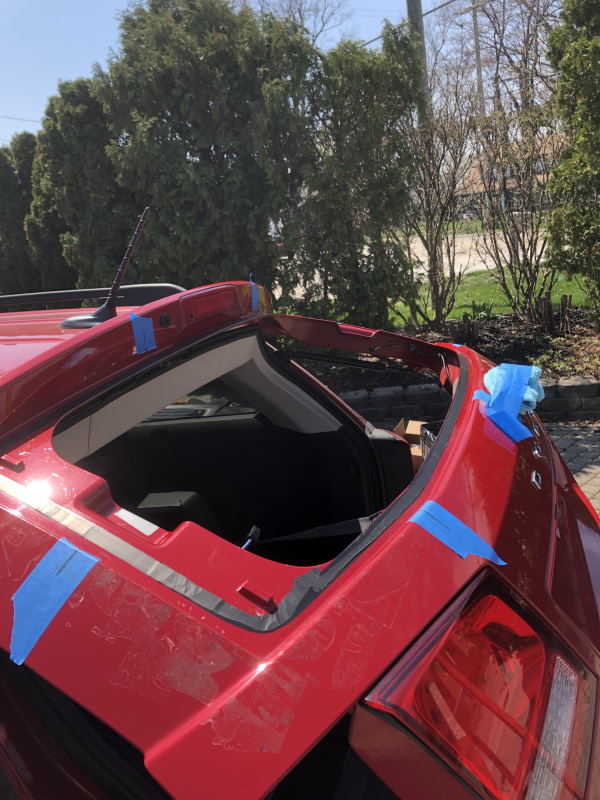

Tailgate prepped, ready for 3M primer and 3M Windo-Weld
Replacement window set in place

As I had used packing tape to hold the shattered window together until it could be replaced, there was a lot of tape residue that needed to be removed.  I wiped that off with WD-40 and then threw on a quick coat of wax on the tailgate.

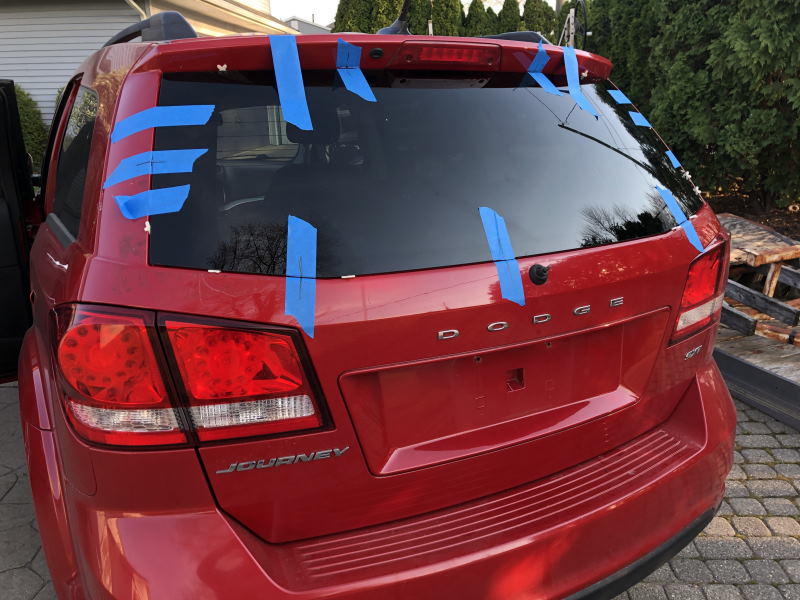

I'm calling this one complete.
This wasn't that difficult and if you are considering doing this yourself, I can easily recommend it.  I did it alone, but an extra set of hands to help lay the replacement window in would be very helpful.

On the replacement, from a salvage yard window, lightly wetting the window with soapy water, I used a razor blade to scape all the old adhesive off, down to the glass.  On the tailgate, it is recommended to leave thin layer of the old adhesive in place.  (It is a very good surface to bond to, and if it were to be scrapped off completely, that would greatly increase the likelihood on scratching the paint/rust.)  I didn't measure, but lets just say the old adhesive on the tailgate after broken glass removal was 1/2" high.  Using a razor blade, I sliced it down to 1/16"-ish high, being careful not to gouge or remove in entirely.  That last picture, before the glass was installed is the 'old' adhesive strip that was cut down.  A razor blade slides through the old adhesive like butter.
