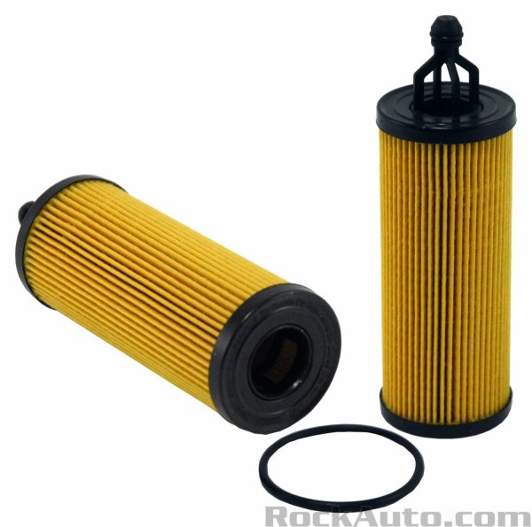

You  have two options for fixing oil filter/cooler assembly. Another plastic one that are readily available or one made of aluminum like you have in the picture. Which are harder to come by. If it’s warranty dealer, calls the shots, I would expect another plastic unit. Yours lasted seven years before failure, if it’s a free fix I would let them do it.
Need to be aware there are two different oil filters on the 3.6 engine. One was used from 2011-2013 and the other from 2014-2020.  Wrong filter could damage housing, not interchangeable. Your China site is showing wrong info.
These guys are one of the better on line sites, very reasonable shipping, fast delivery.  The alum units are out of stock right now. People must prefer them.
https://www.rockauto.com/en/catalog/dodge,2016,journey,3.6l+v6,3353540,engine,oil+filter+housing,12429
