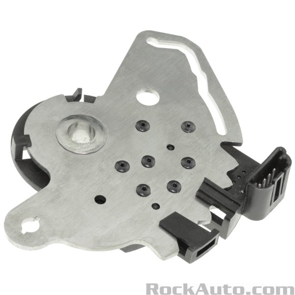

My 2015 Sxt AWD also had the same issue then it didn't start at all, Vehicle Not in Park message cane on and it was the Neutral position sensor that went bad. Its about $65 and easy to replace with some patience, No need to drain the transmission.
Good info for the site. One of oil pans removed to do it.?
Mopar oem part is $50-ish plus shipping.
https://www.rockauto.com/en/catalog/dodge,2014,journey,3.6l+v6,3300354,electrical-switch+&+relay,neutral+safety+switch+/+range+sensor,4584
