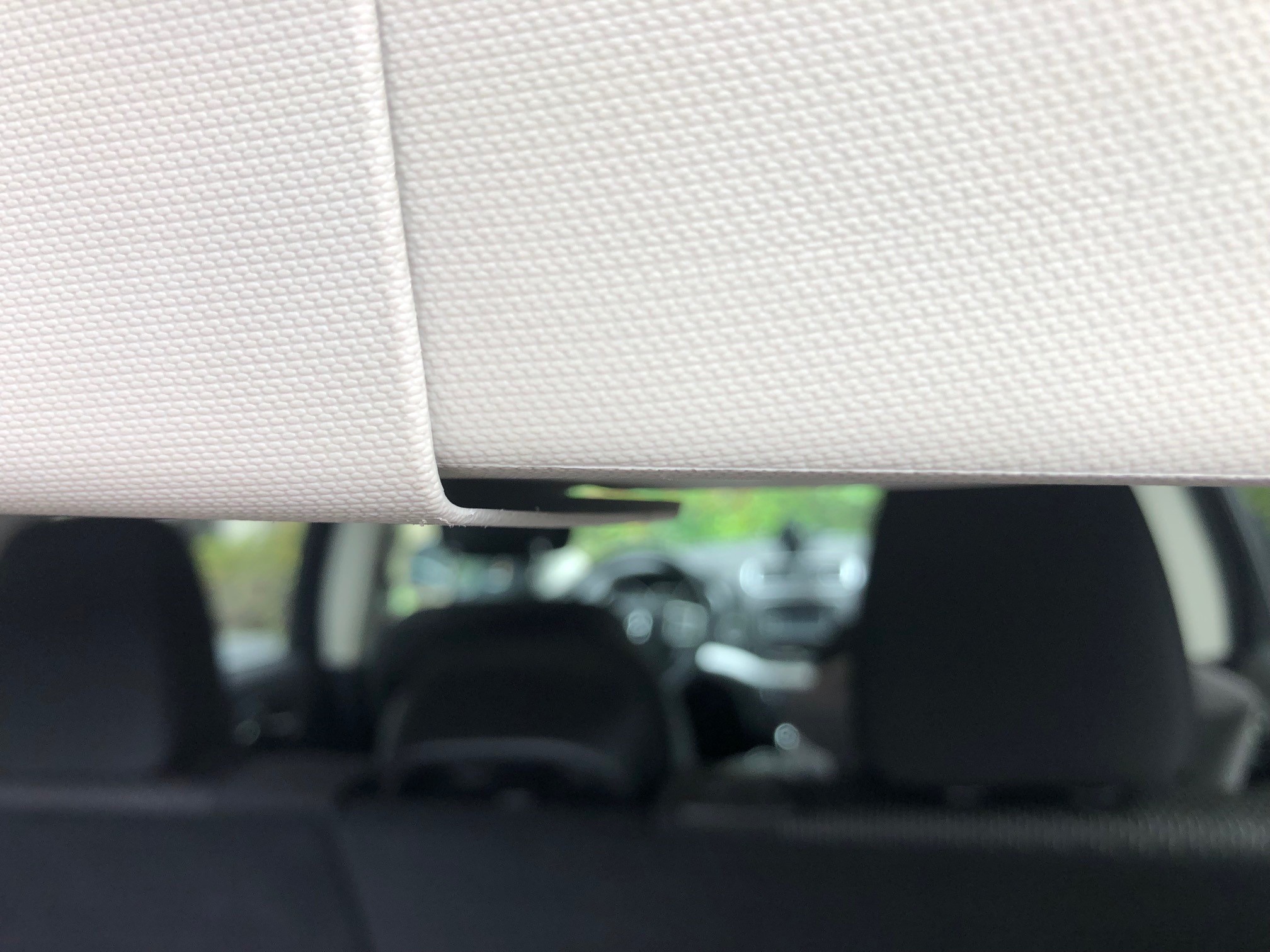

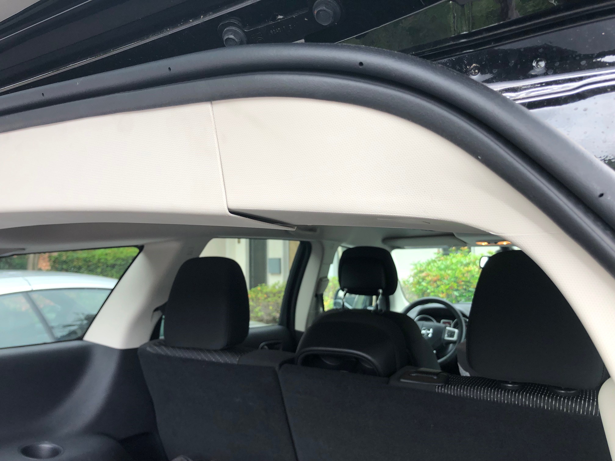

Hello guys,
Happy Journey 2020 owner for the last month so far, the only issue is the L-shaped plastic panel in the trunk - the one's right end appeared to come off slightly last weekend (please look at the photos attached). Not a big deal, but still a sore in the eye that indeed freaks me out. So there are two questions to ask and get answered:
(a) what's the right name for that panel mentioned?
(b) is there any DIY fix for the problem described?
Tons of thankyou-thankyou in advance!

they are held on by plastic push pin clips, if you remove it and then probally have to replace the pin if you can find one ..or simply take a bit of clear silicone inbeteen the 2 panels and then wedge a pole or board to hold it tight and in place till it dries,,that is what i would do
32 minutes ago, John/Horace said:
Hatchback headliner trim panel.
I don't find clear silicone is very strong under load.
Should be under warranty coverage, I would ask. Parts department could order correct clip, maybe get two. Flimsy trim is common on FCA vehicles.
under load all it is a plastic trim piece    LOL , op doesn't give mileage  so i assume its out of warranty might use some double sided tape as well,, your way of buying clips from the part dept would cost $10-15 depending if he does more damaged removing it to install new clips
Edited by 2late4u
Held in place and glued, then remove support and it's under load, and driving with vibration.. .a live load.  White 100% silicone maybe,the clear is really weak I find. Moparcity or other on line dealers are way lower than list now for stuff.16293044217362302694953611923253.thumb.jpg.663d48aebcb9839d7f2a423c1c132d15.jpg
I like this E6000 clear automotive sealant. Needs over night curing, but great for plastics/vinyl. Beats silicone generally, around $5 a tube.

The clear silicone being easy to remove is actually handy sometimes. Just not great for holding plastic stuff together. My 2 cents.
